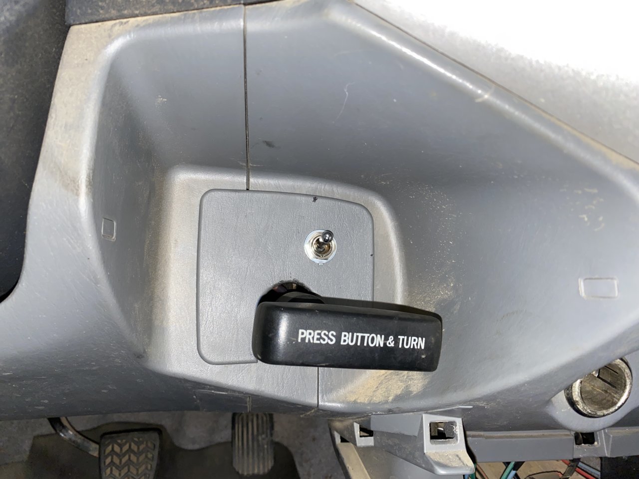

    Ah now that's a handy idea. I mostly tend to draw it out in my head then sit down and write up a material list. I can deffinately see where having the schematic may come in handy. I have done my best to keep it fairly simple and each circuit has a fused relay. I don't have a need to add much if anything more although I do have the switch for the ABS kill mod. If I decide to do much of anything more I will have to look into a relay panel or an SPOD type setup. I got the extended brake lines on finally so if it warms up enough next weekend I may tackle removing the rear spring perches and install the Hammer Hangers. Getting the rivets out will be about the only pita I may try the plasma but not sure just how handy it will be in that circumstance.

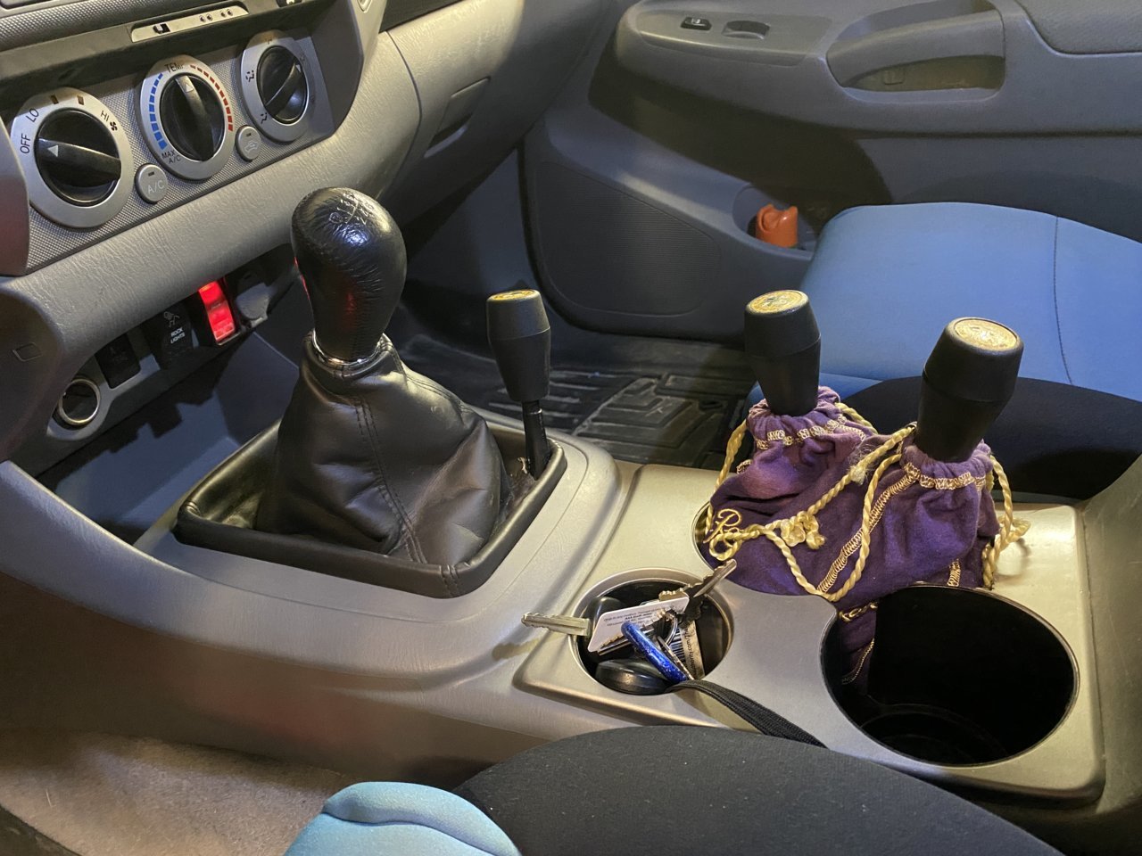

    yep

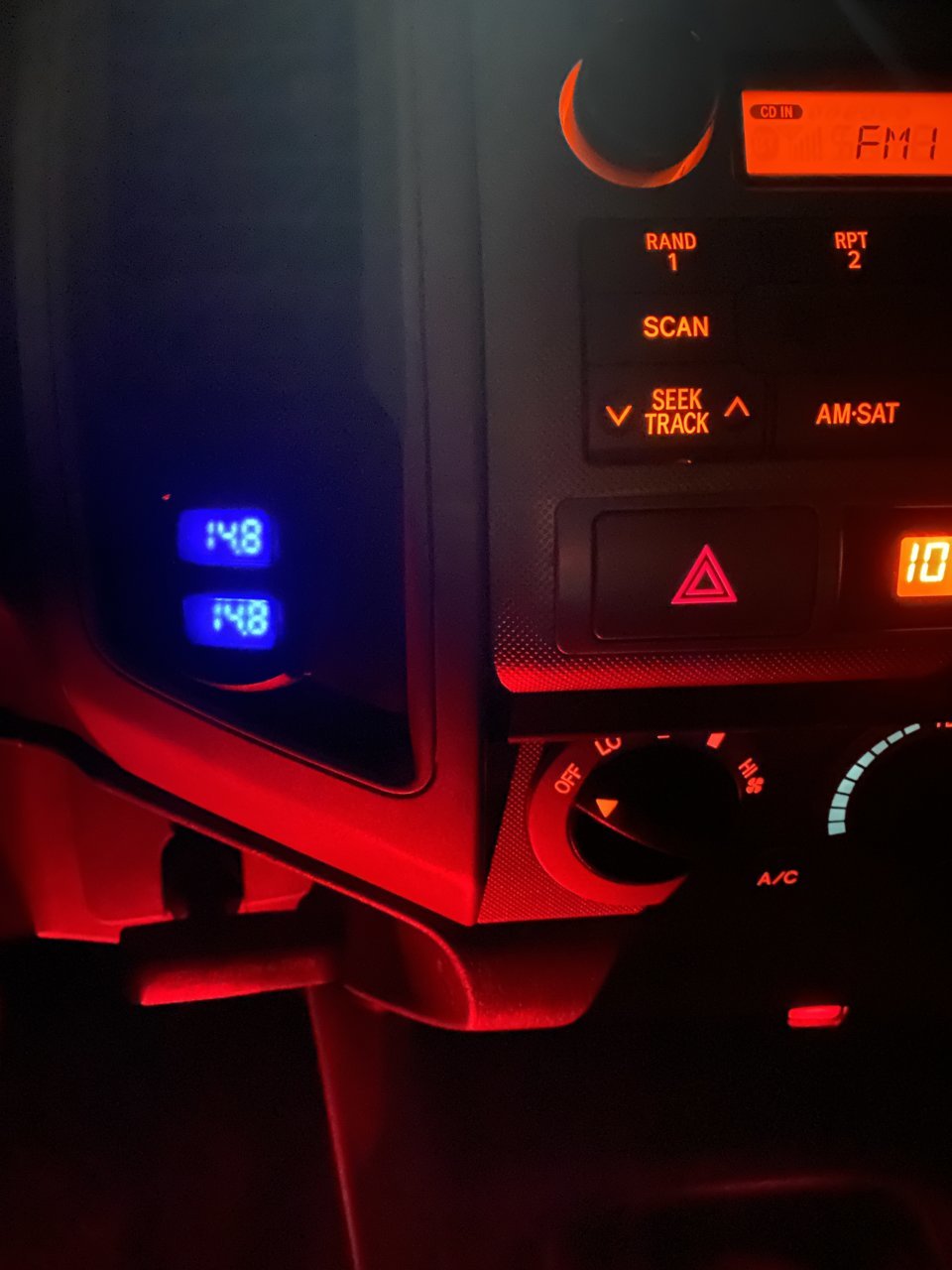

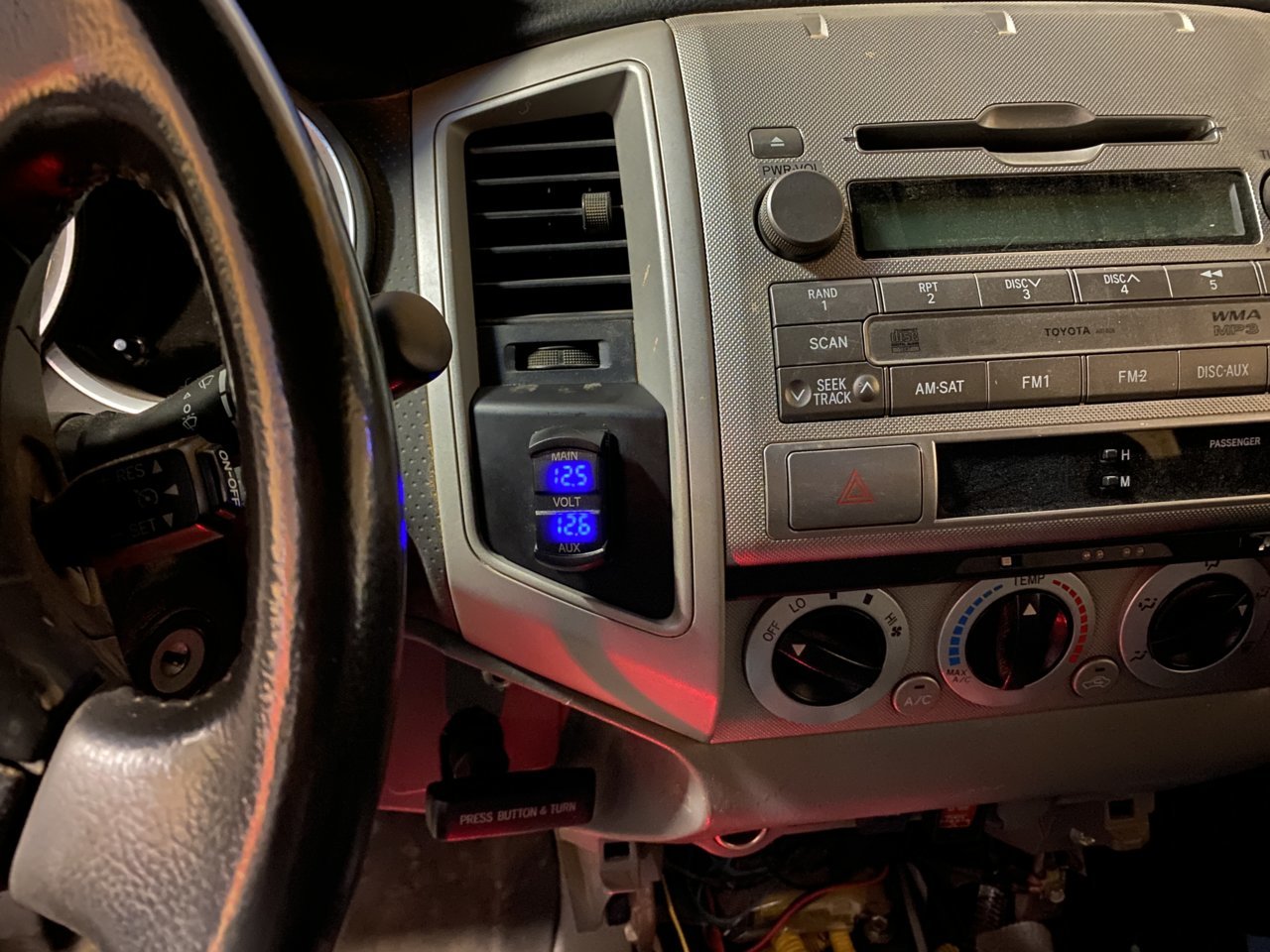

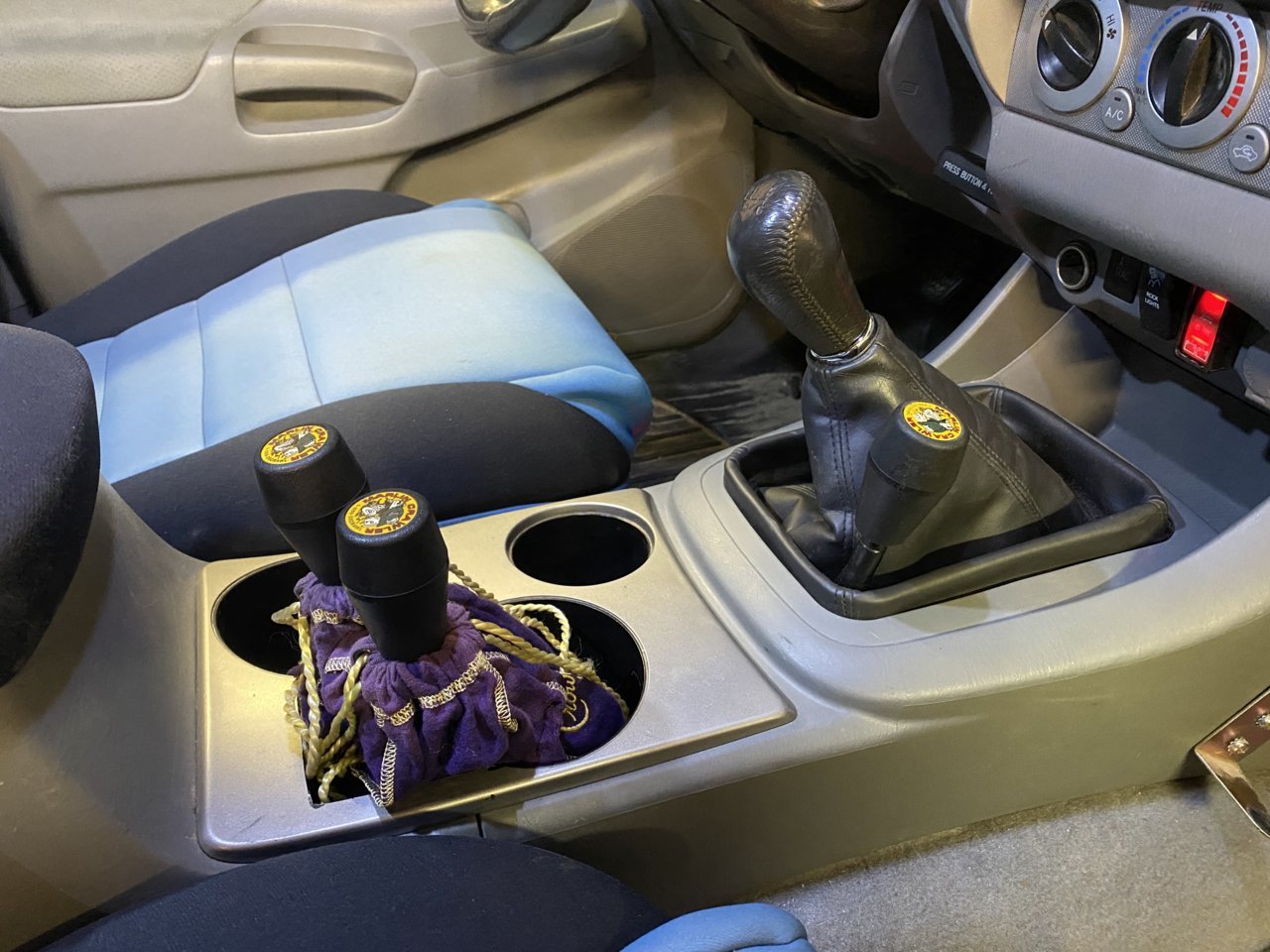

    buttoned up the interior tonight and took it for a spin. New clutch and slave cylinder work nicely paired together.
    also very pleased with the new alternator output

    That went back together well.

    Yep.
    Last time your console was that clean was around 2010 :laughing:

    I thought so too!
    you got that right! Also changed my cabin air filter while I had everything apart, had about half pound of pine needles in the old filter haha. And the leather shift boot for the trans shifter hasn’t been installed since I had first put in the crawl box, turned out half decent by just cutting a slit in there for the crawl box.

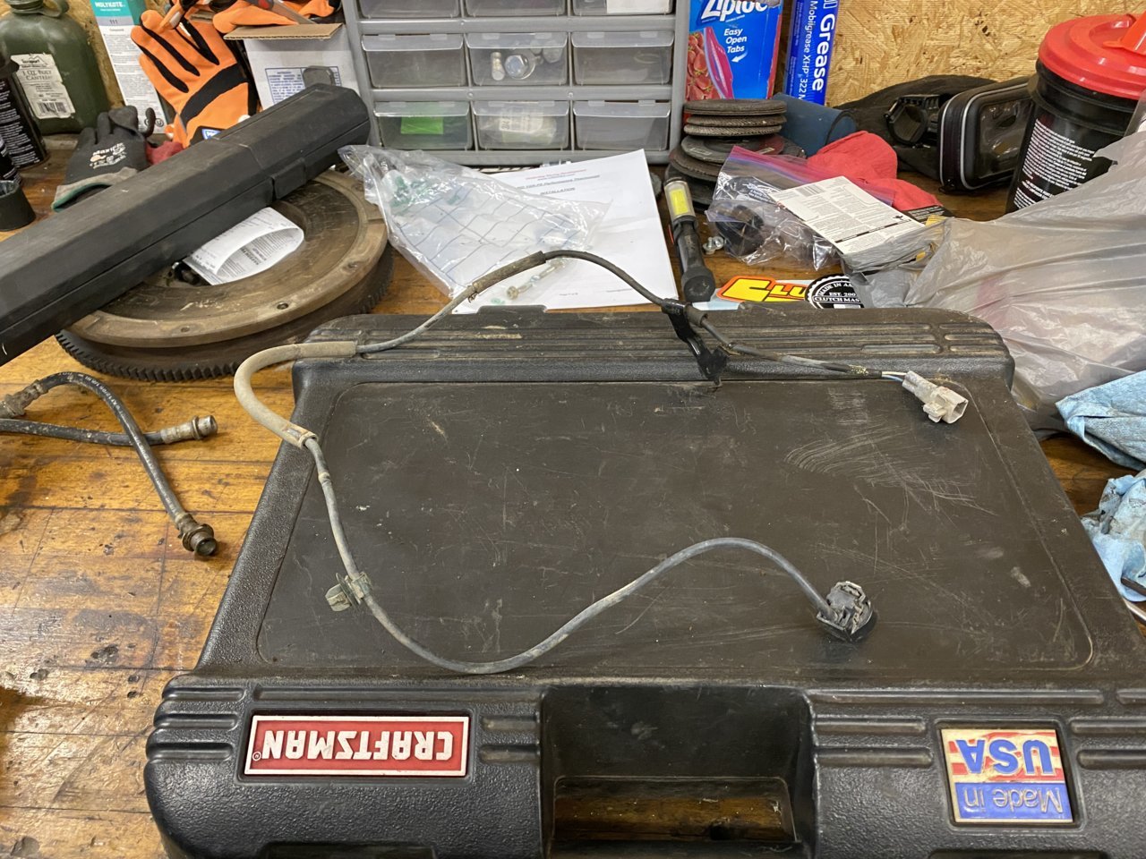

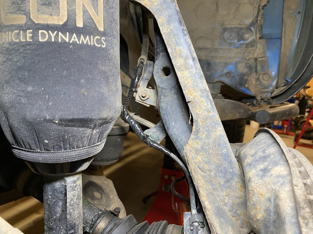

    Finally fixed my abs light after 5 years lol. Turns out the harness had an open in it by where it’s routes on the steering knuckle. Verified the location with a TDR, then cut out the bad section and spliced in a new piece of wire. Cheap fix compared to a new speed sensor.

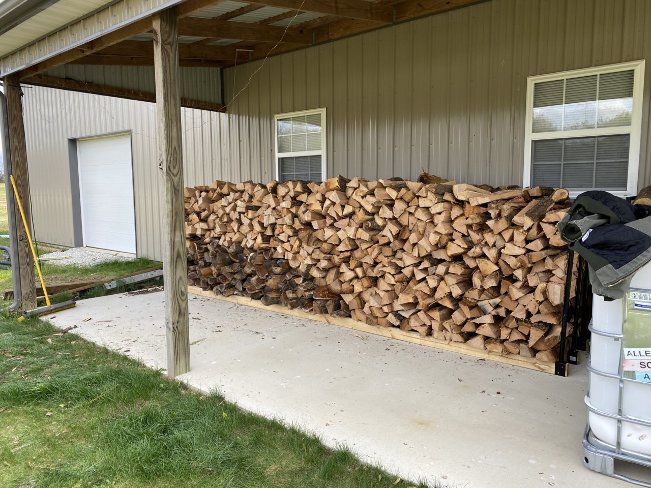

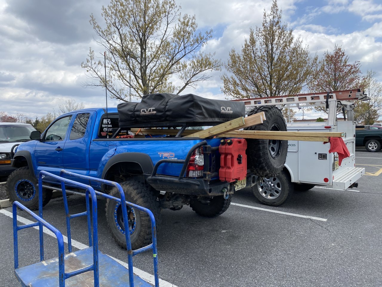

    Done stuck me a 16 footer in there
    Made a Covid cord’o wood.

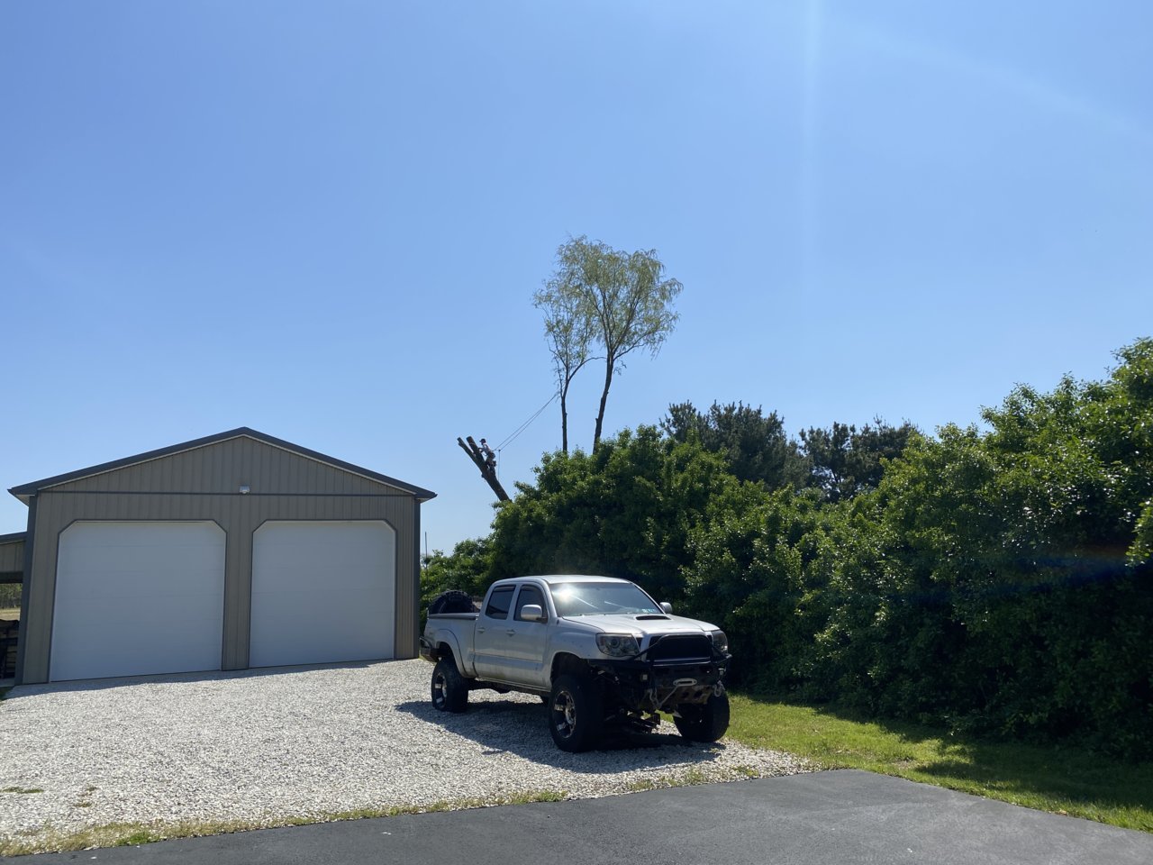

    Overland tree chop patch achieved
    went for a ride on the green goober to celebrate.

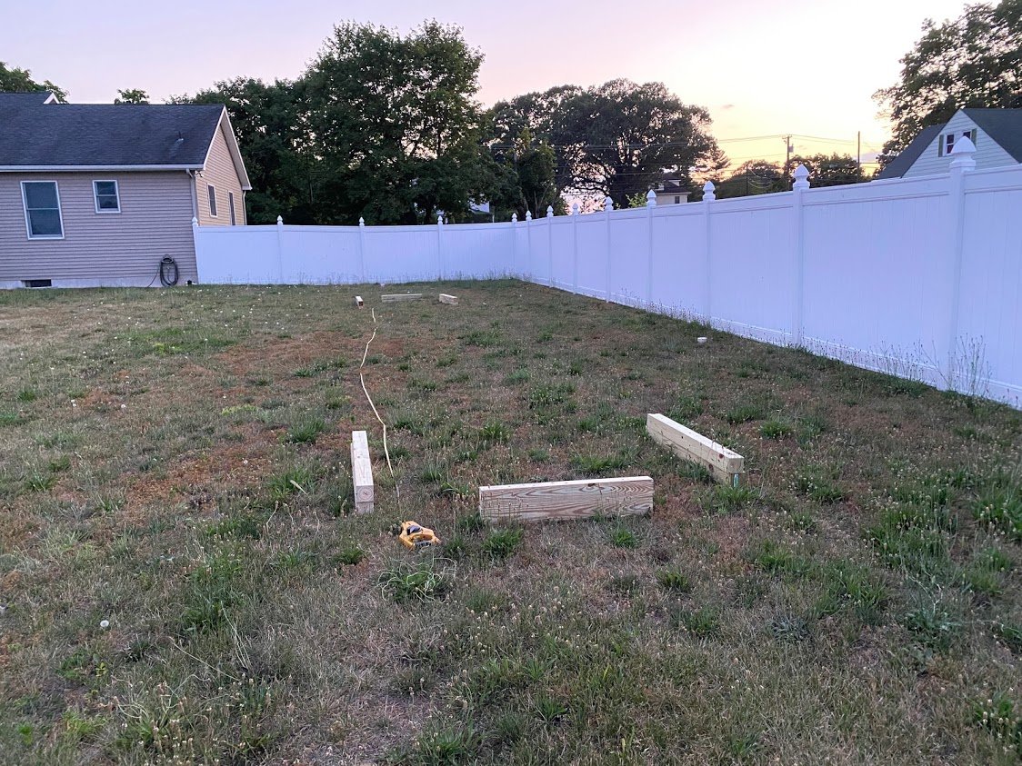

    Well not much has been done to the taco, but have been busy knocking out a few house projects over the last couple weeks.

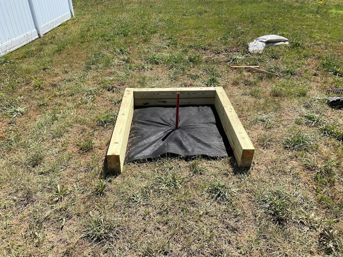

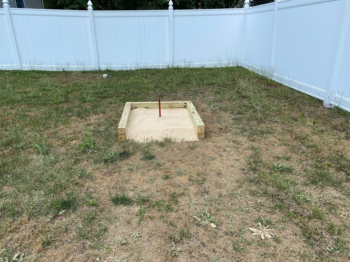

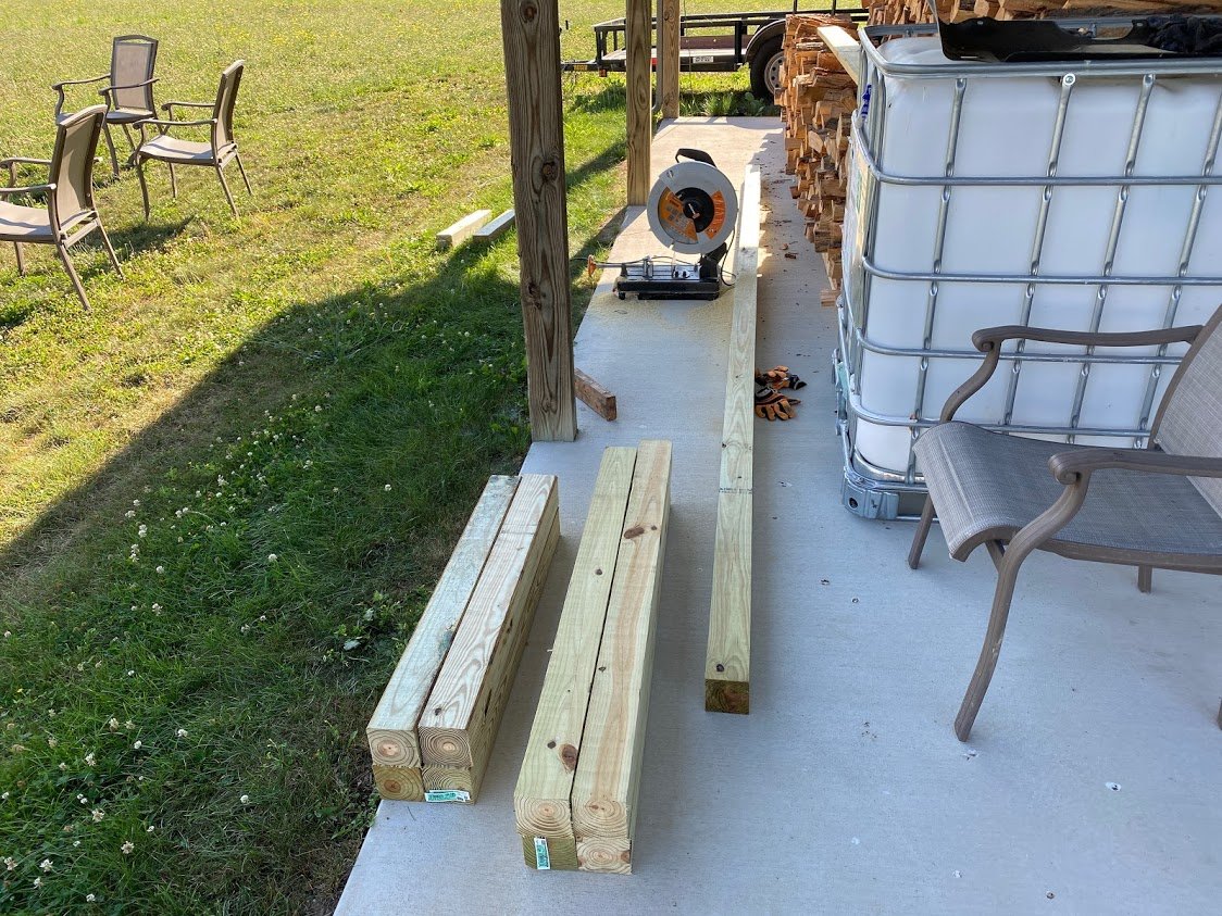

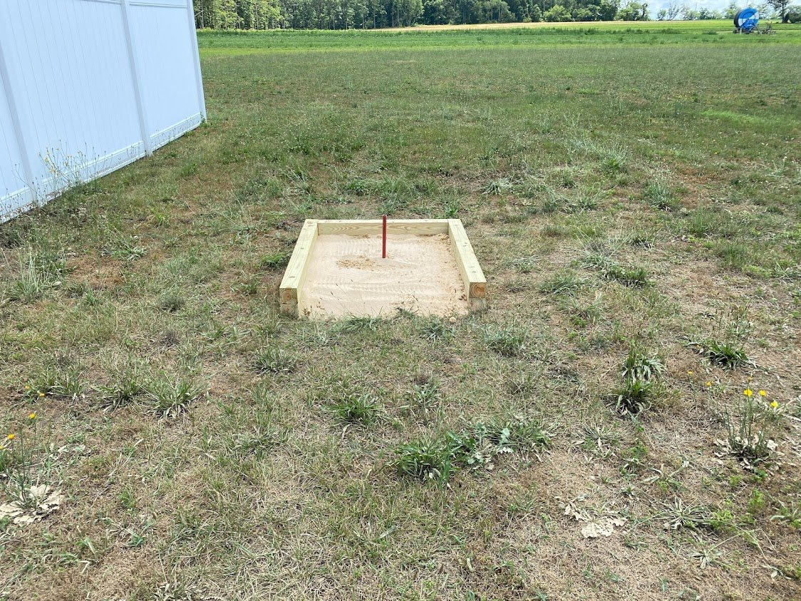

    Built a horseshoe pit, just in time to break in for the 4th of July weekend. Need to practice a little more, been a few years since I've been serious with playing but I love it. Made it with a few pressure treated 4x4s (which apparently are rare to find nowadays up here in the northeast due to this goddamn virus), driven in with #4 rebar.

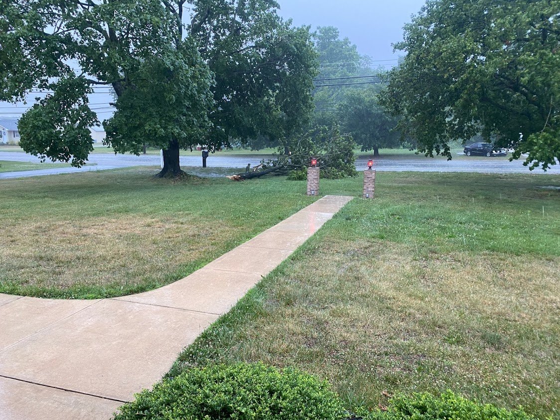

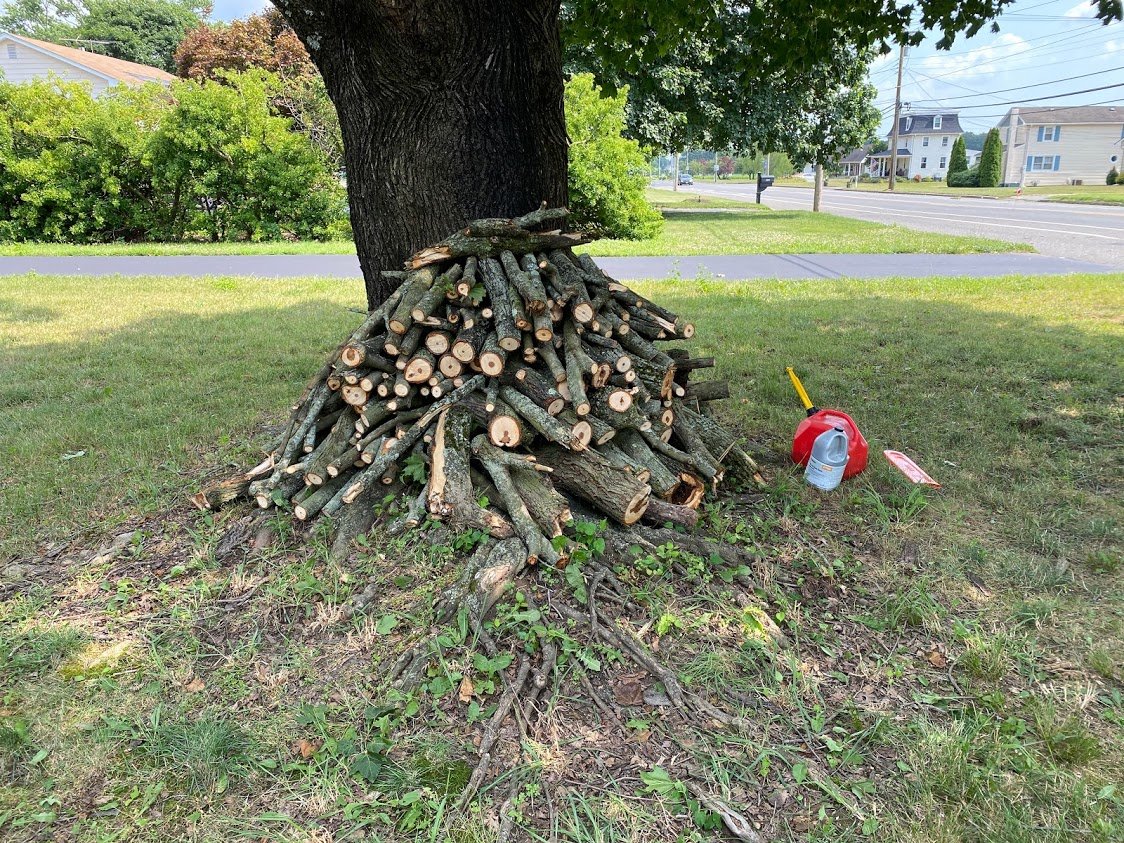

    Lost a big tree branch in a recent storm, took the time to cut that up, plus it was hot as balls this whole last week so that was fun

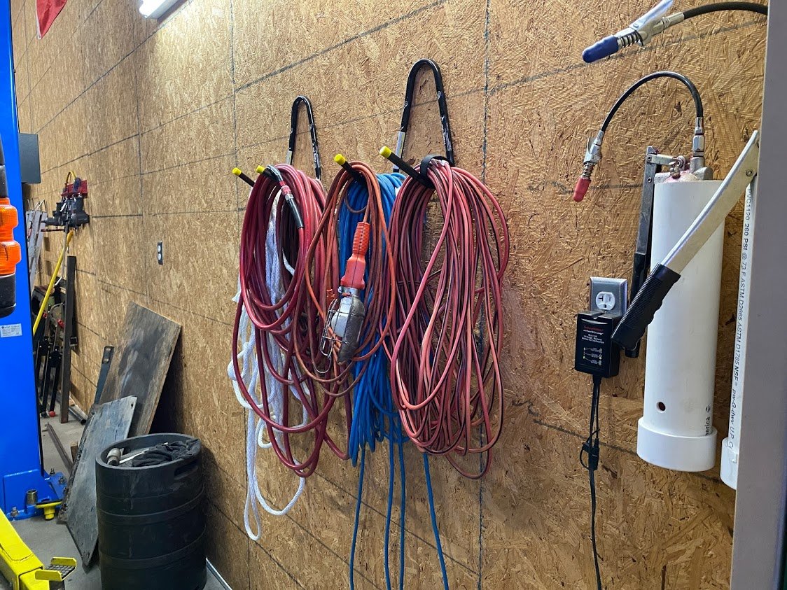

    Added some cord organization to the shop

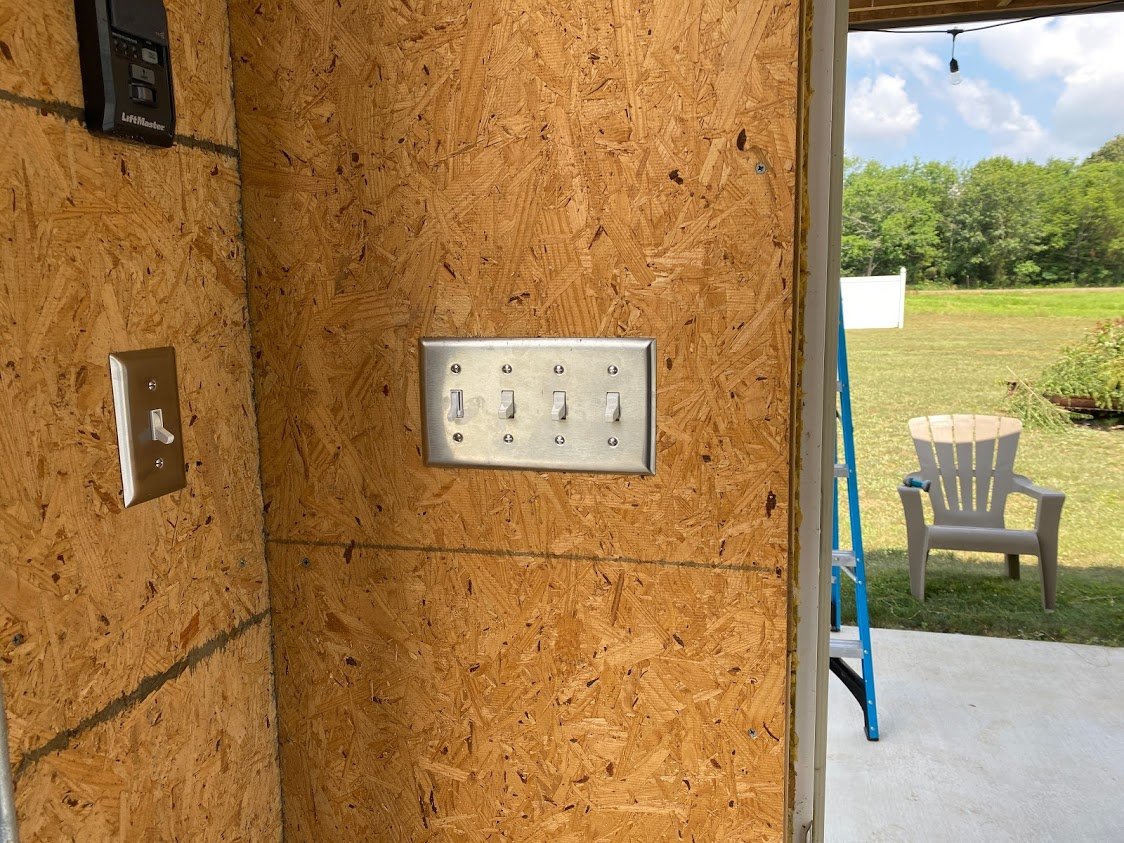

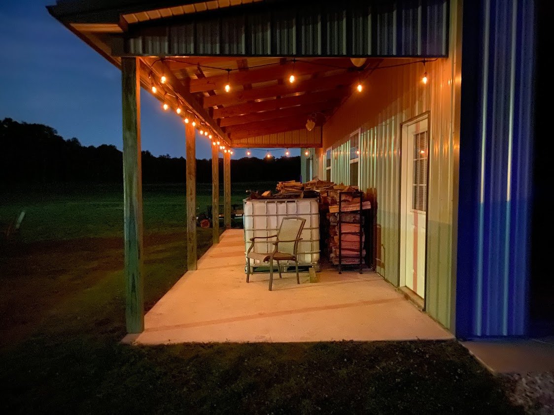

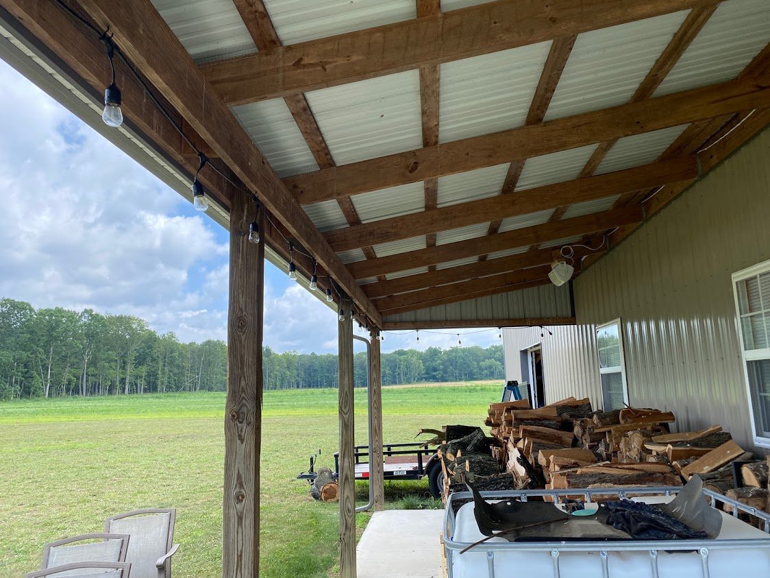

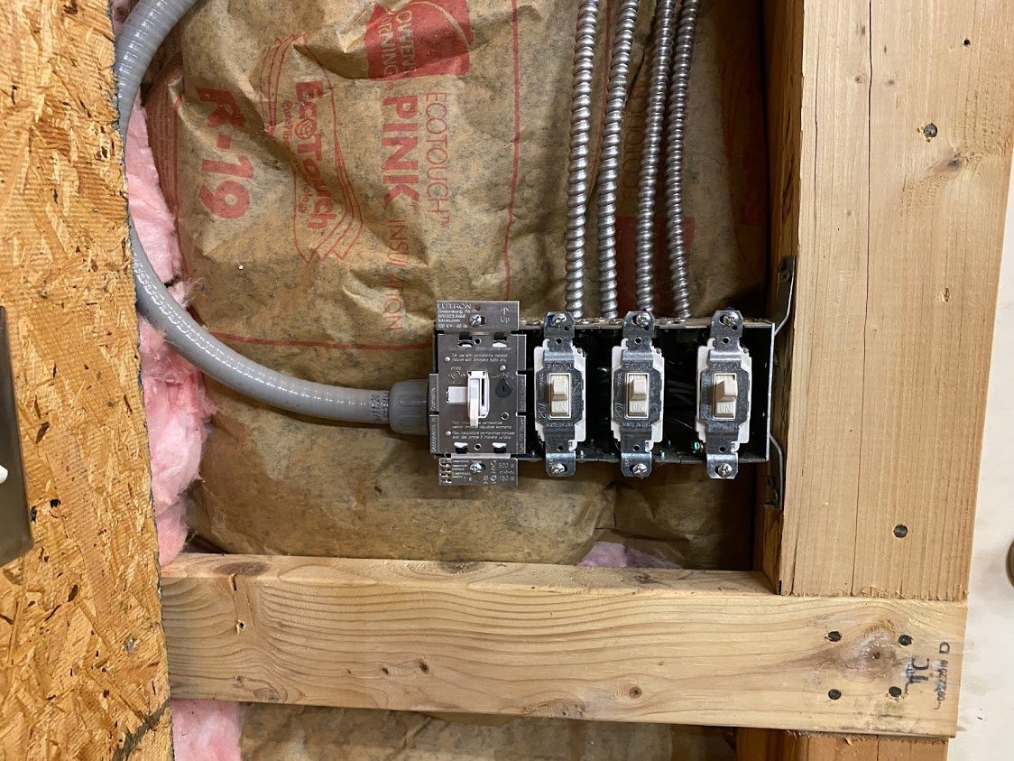

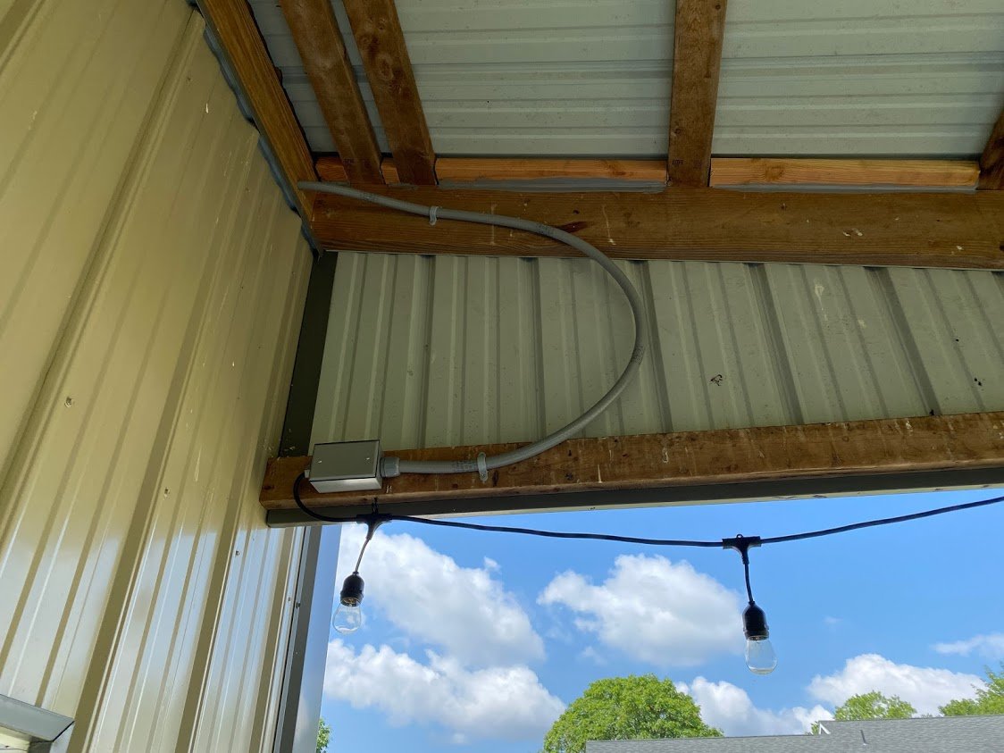

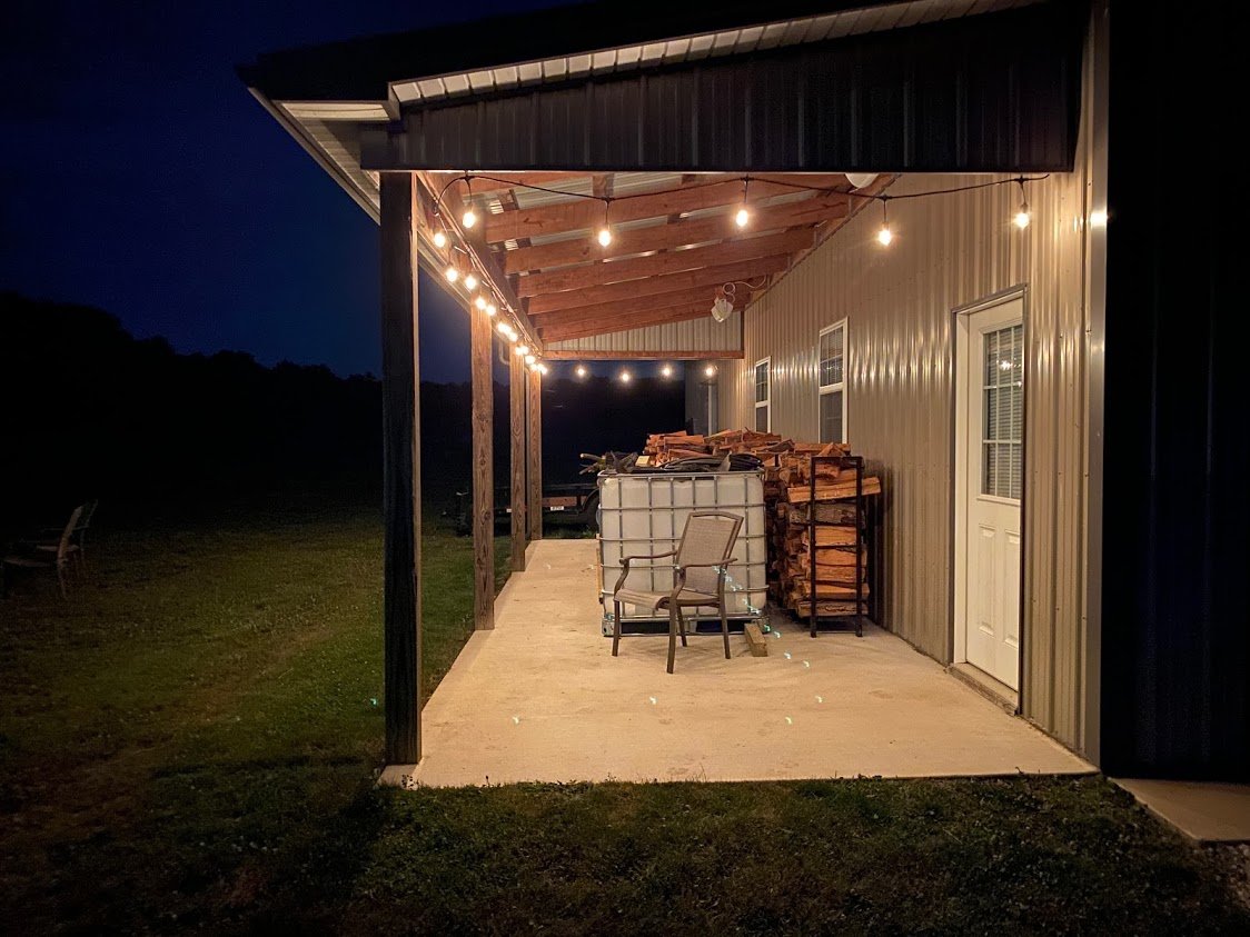

    Hard wired some HF string lights on the lean-to with a dimmer
    night time shot at full dim
    and full bright

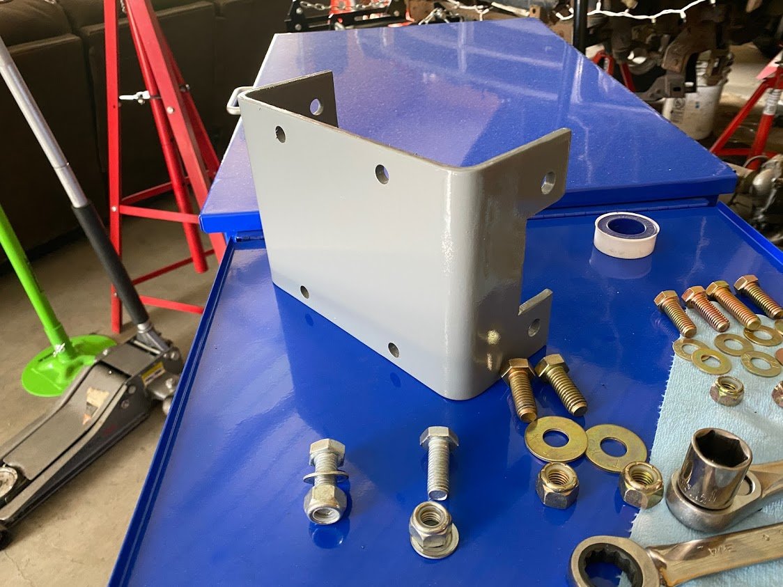

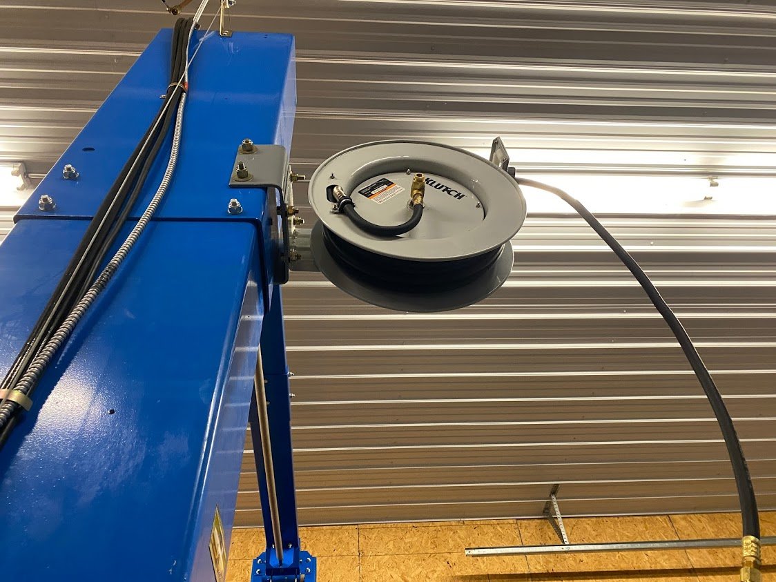

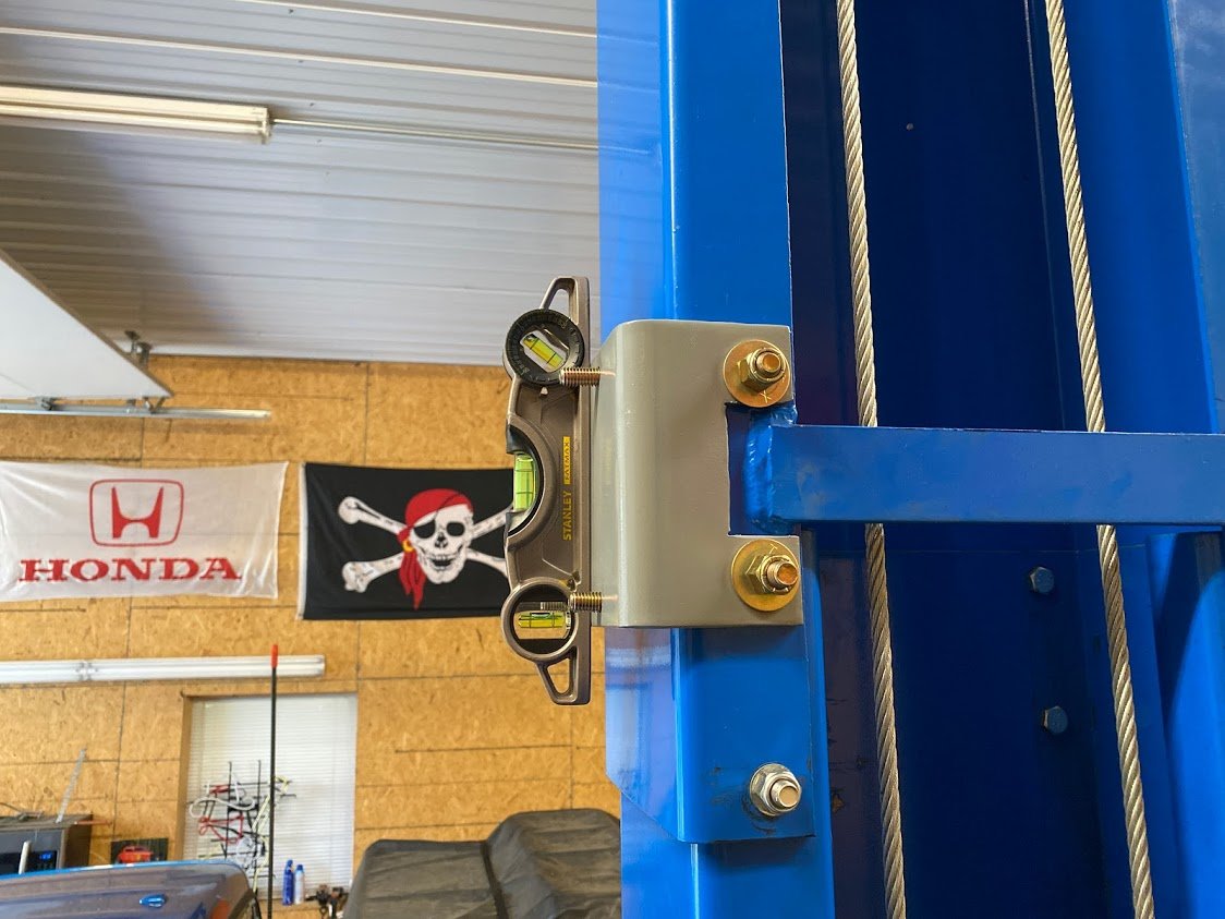

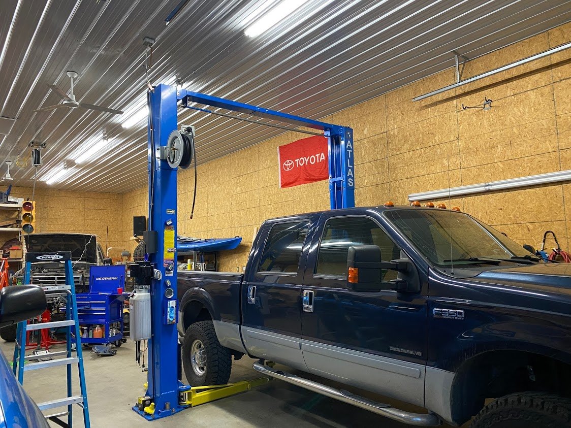

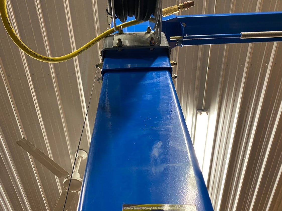

    Another project I've been meaning to knock off the list was mounting an air reel to the lift. No good existing mounts were present so I had to get a little creative and make my own bracket and source some longer bolts
    Had to notch to clear this tie plate
    Finished deign mounted up

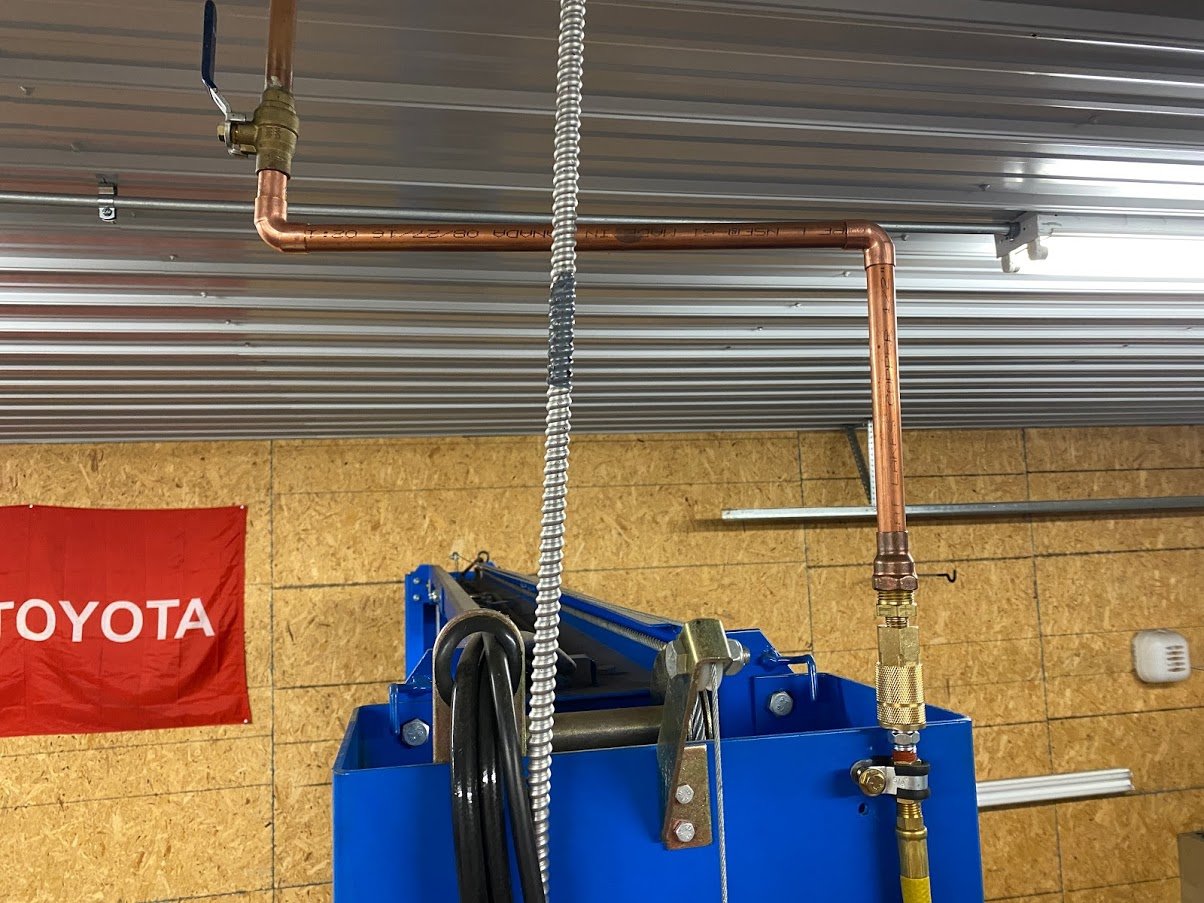

    Got all the copper cut to size, I'll solder it tomorrow when I move the Ferd out of the lift bay, then this project will be complete
