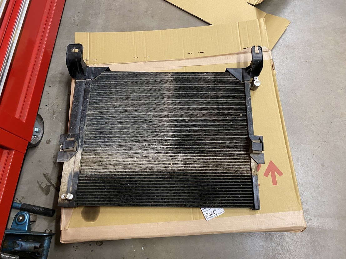

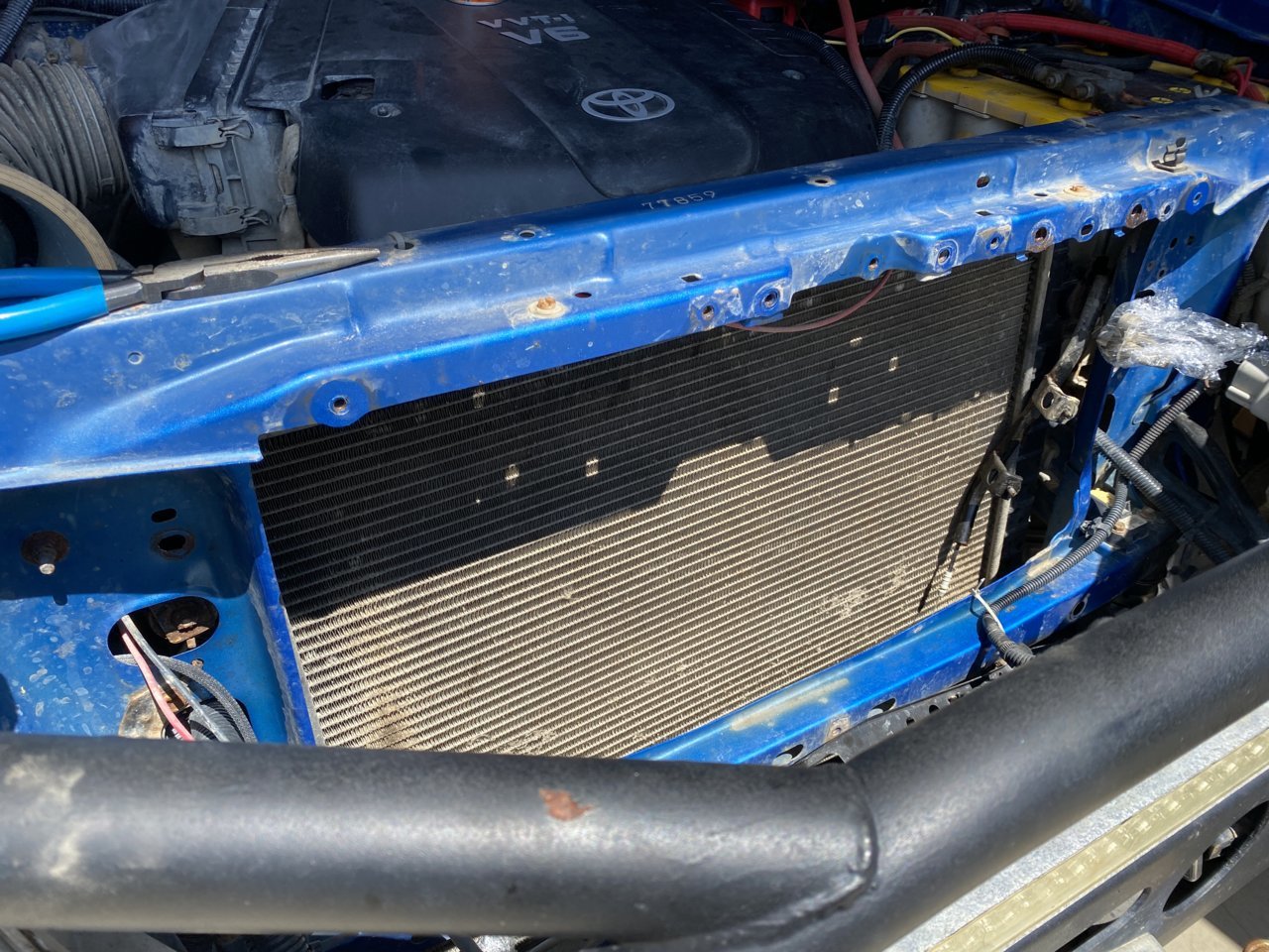

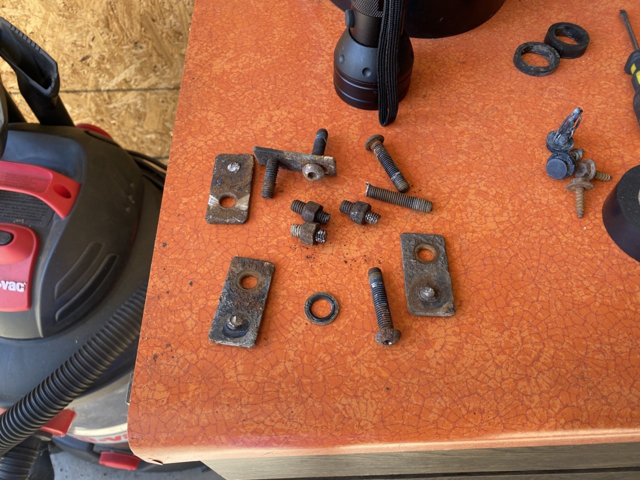

    Old condenser is out. Nothing is ever easy. The drop brackets for the radiator were rusted to hell, broke 3 of the 4 of them. It isn’t a job until you get the sawzall out :rolleyes:
    ordered new hardware and brackets from roger brown, guess I’ll have to wait til that gets in to reassemble. Also blew about a pound of dirt out of the radiator :D

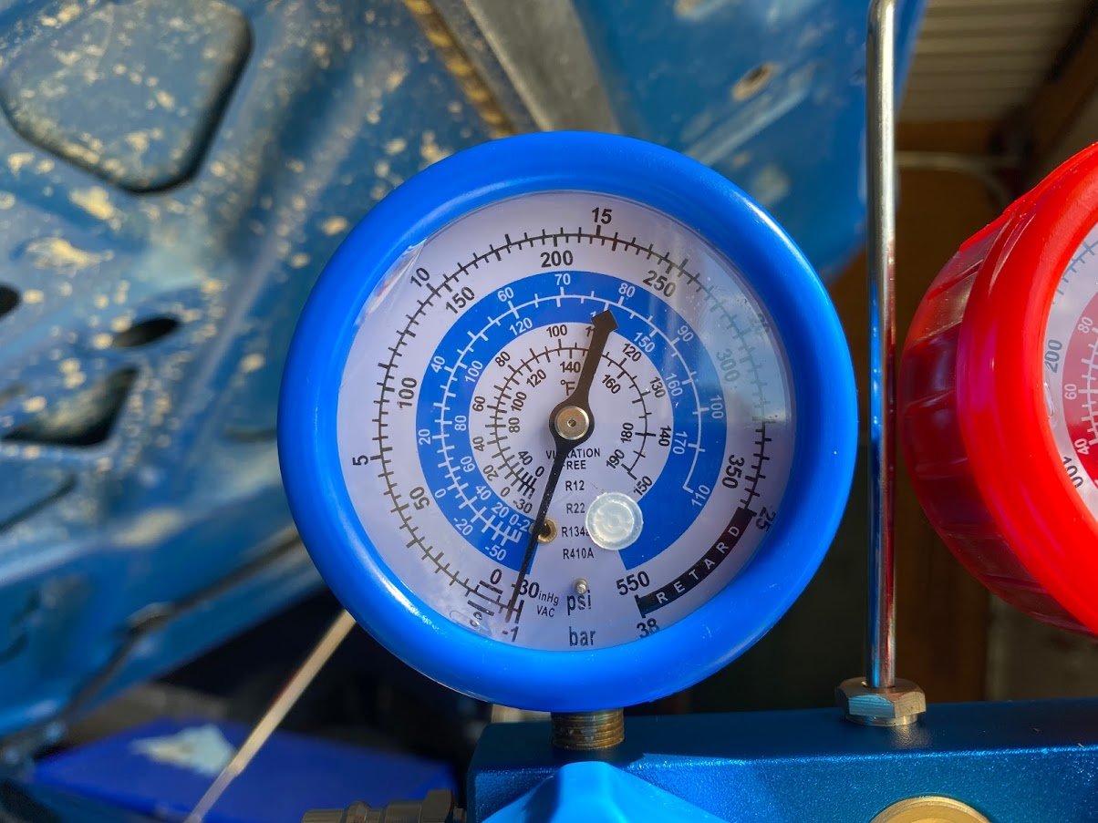

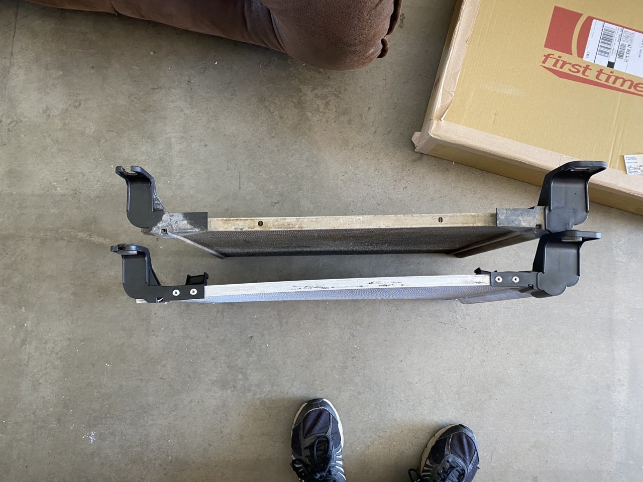

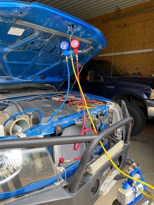

    Rad hardware showed up today. Replaced the condenser, added 1.4 oz. of PAG 46 oil to the condenser and torqued up the new seal connections to 66 in. lbs per the FSM. Drew vacuum for about 10 minutes and let sit for 30 minutes, no further leakage, that's a bonus. I then proceeded to draw a deep 1 hour vaccum and refill with R134A, ~22 oz, the AC is now blowing cold at 42 degF
    Old one was leaking towards the bottom as noted from the dye test. You can see the oil that seeped out at the bottom 1/3, note that I had the original painted black to blend in with the theme of the truck, but with the raptoroshi grill, the zinc coating does not show through so I left as is from Denso :)

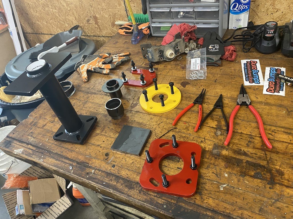

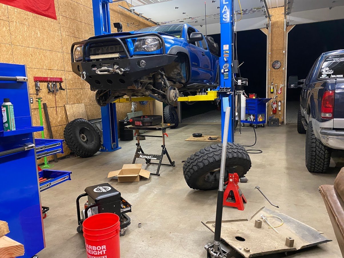

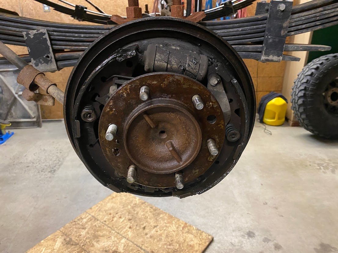

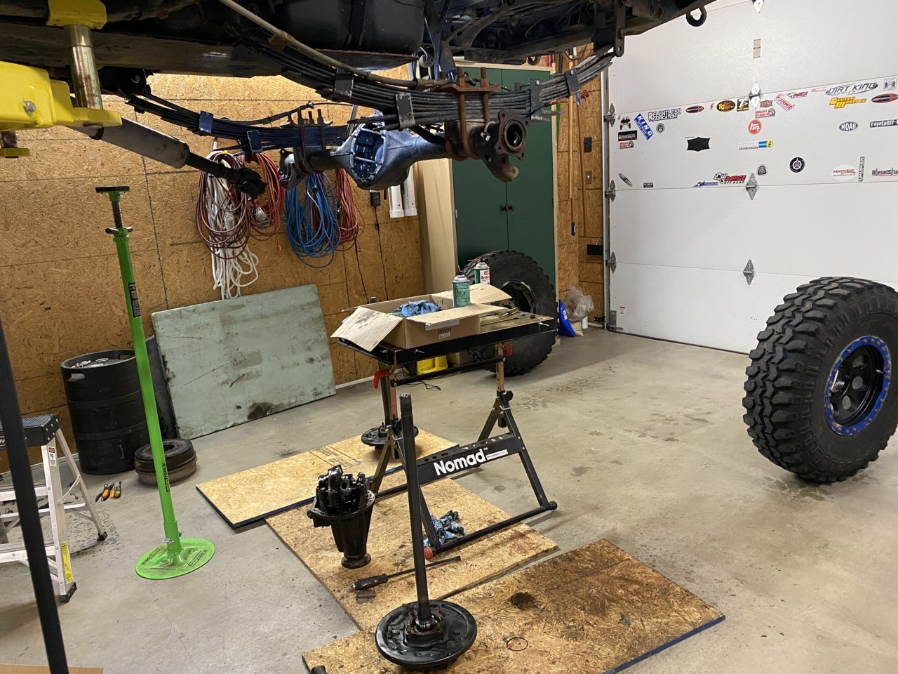

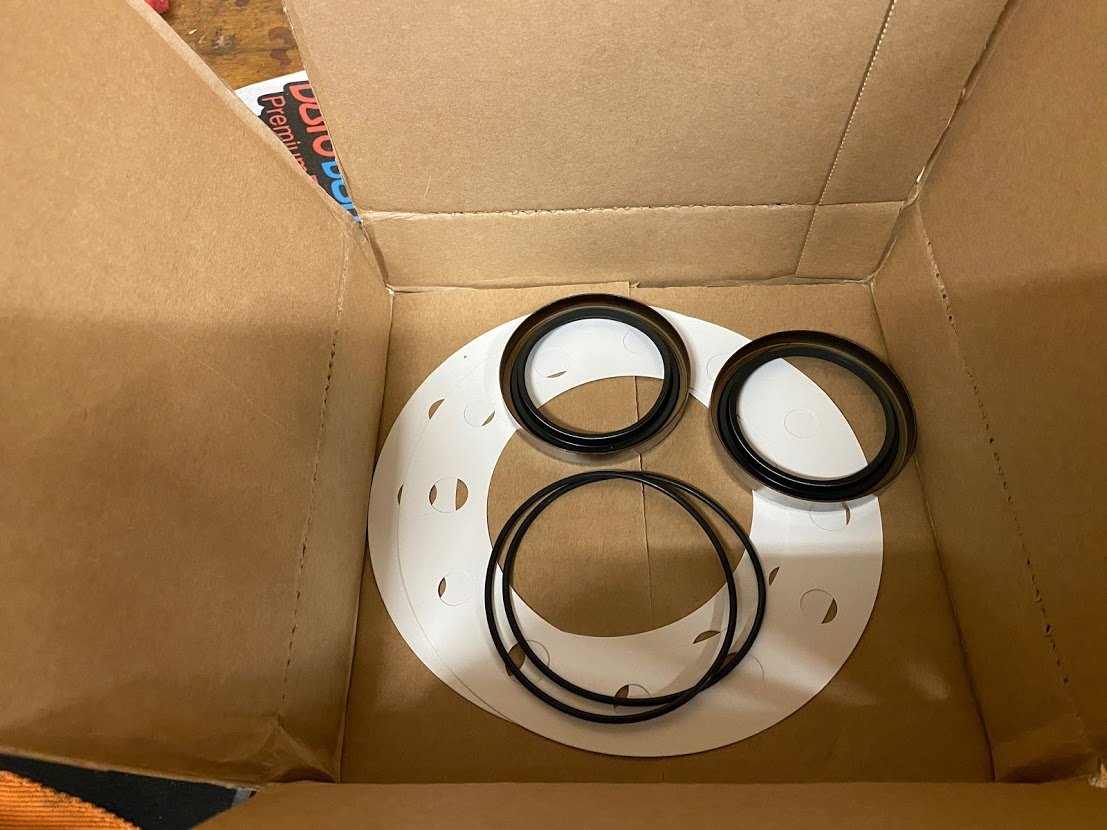

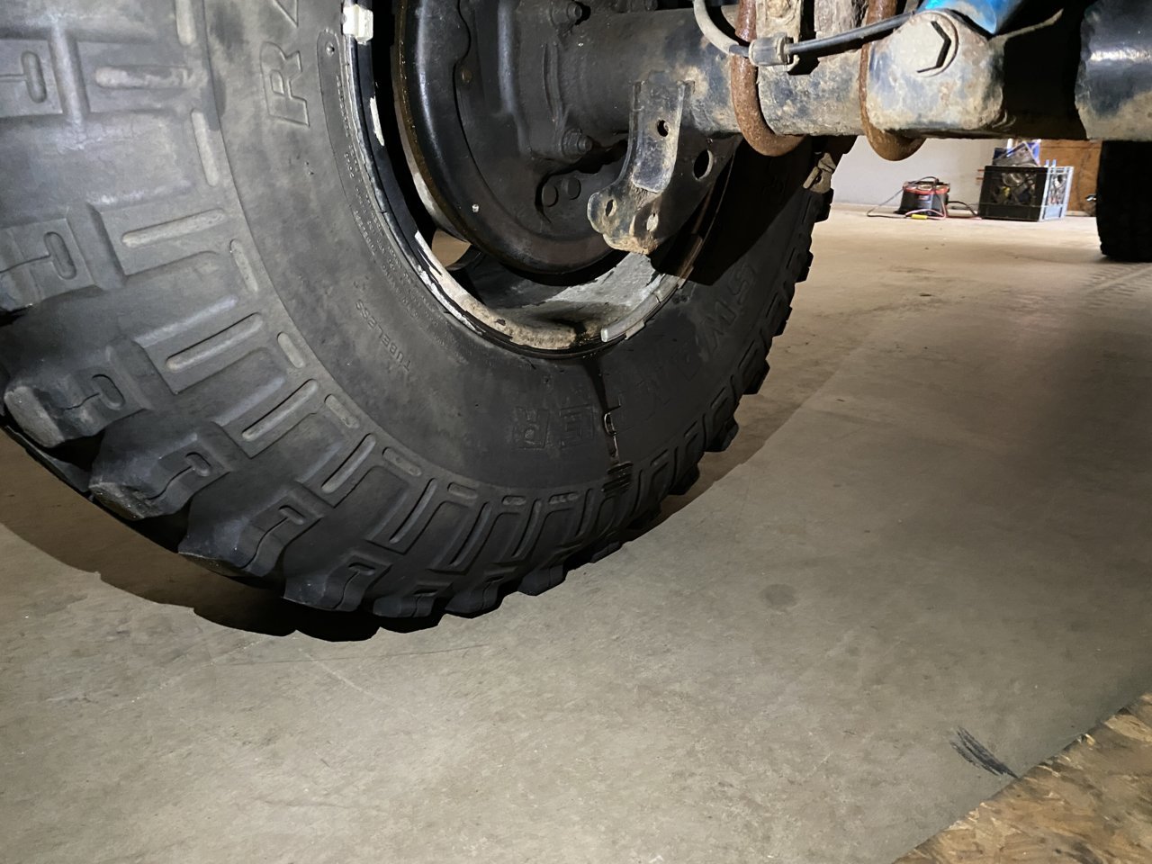

    Got started on the truck today. Put up on the lift, drained the front and rear differentials for a fluid change
    Drivers side brake setup, filled with gear oil and brake dust which equals nasty goo.

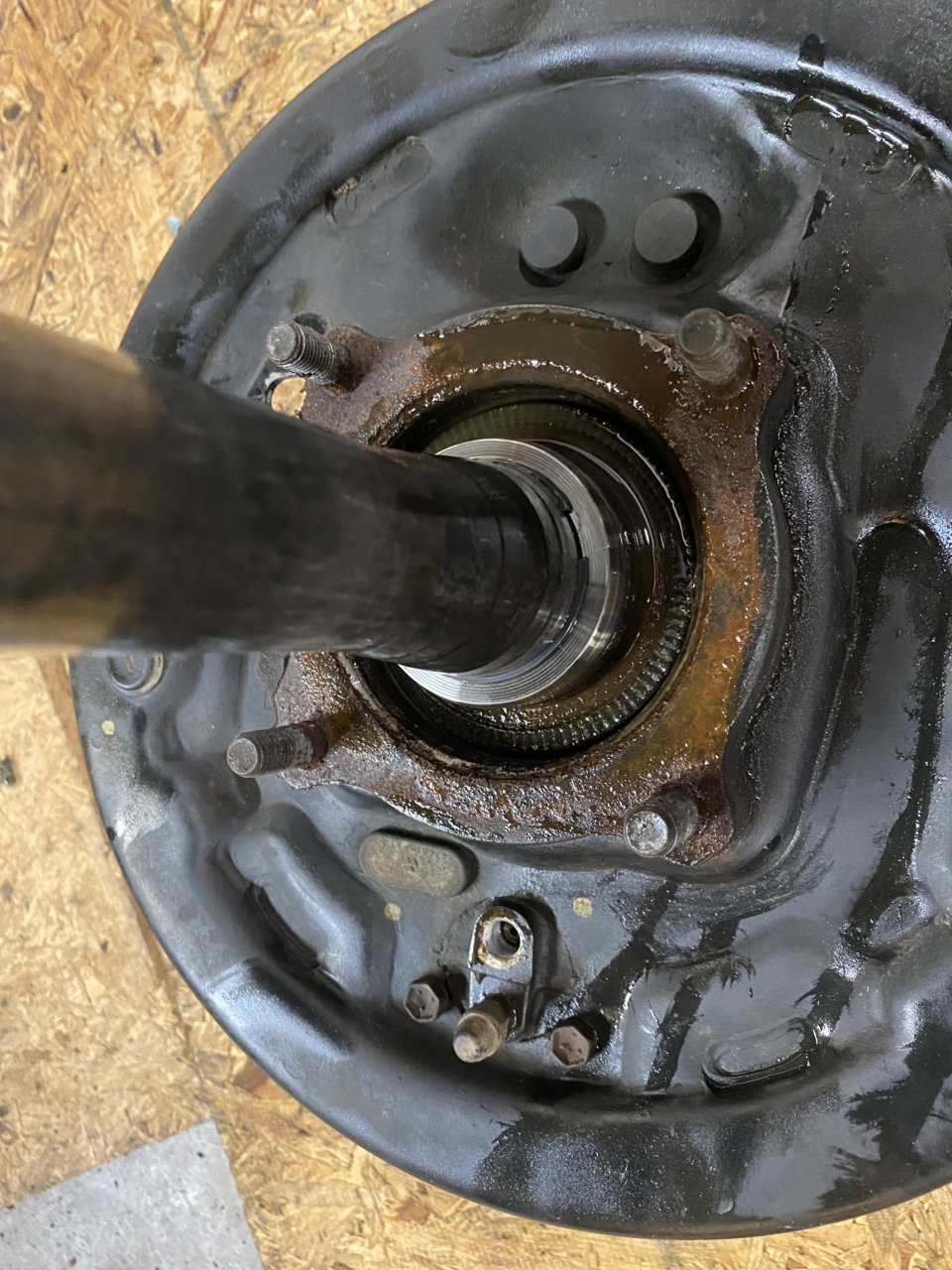

    I cleaned up the axle and the brake components today, tomorrow I'll tackle replacing the seals and resealing the 3rd member. The new axle seals showed up today around 5pm from the fedex man

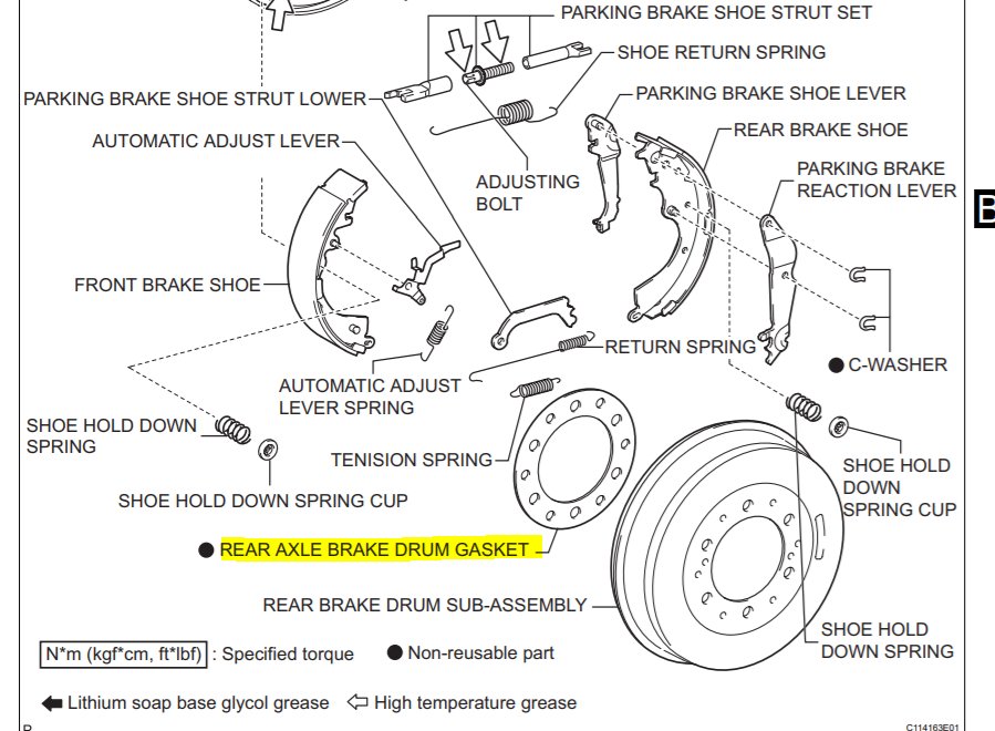

    Those white things are the rear axle brake drum gaskets, I've never heard of them or don't think I noticed them installed on my truck before. Does anyone know if these came from the factory with them? Seems they go between the hub and drum, possibly to keep the drum from seizing up? Don't currently have them installed on the truck, so not sure they are entirely needed but they were only $1 a pop.

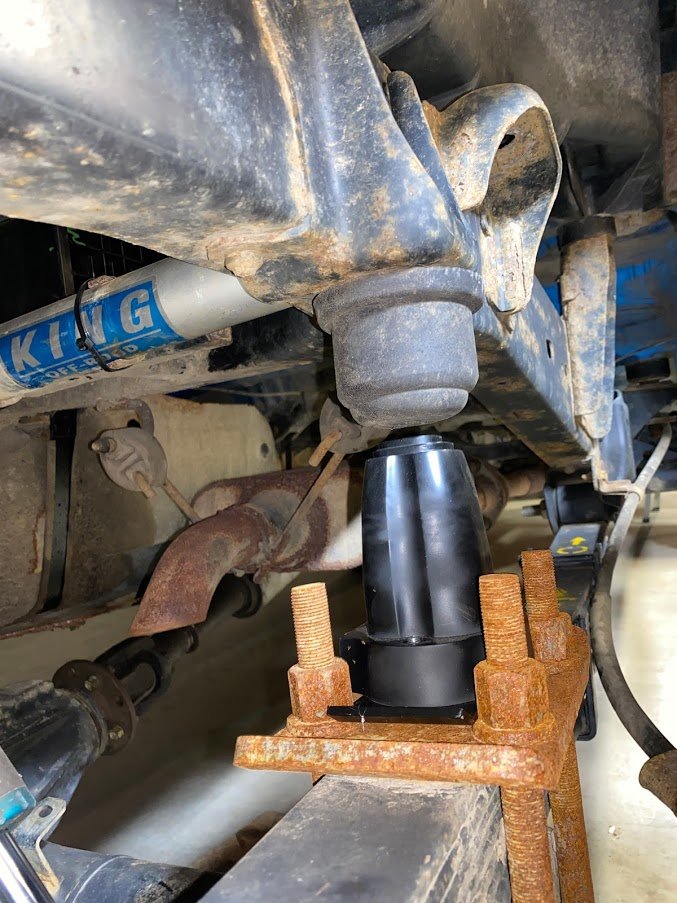

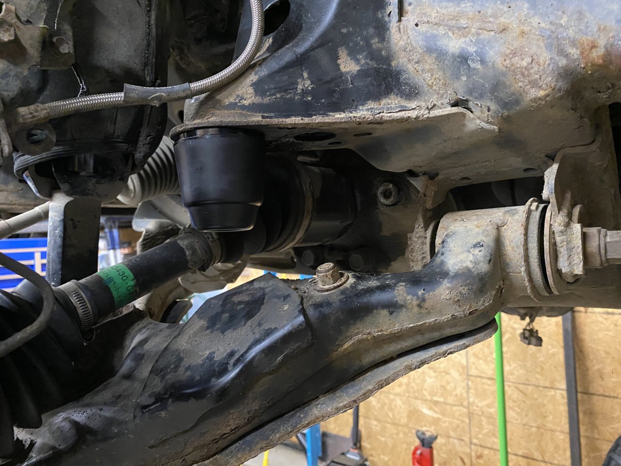

    I sprayed down the bolts for the front bumpstops with Kroil today in hopes they will come loose tomorrow so I can install the duro bumps
    For the rear, I'll ditch my wheelers setup on top of the frame strikeplate and put the durobumps mounted to the ubolt plate. I'm going to need to take some measurements and fabricate a spacer to limit the uptravel. Not sure I'll get to this tomorrow or not.

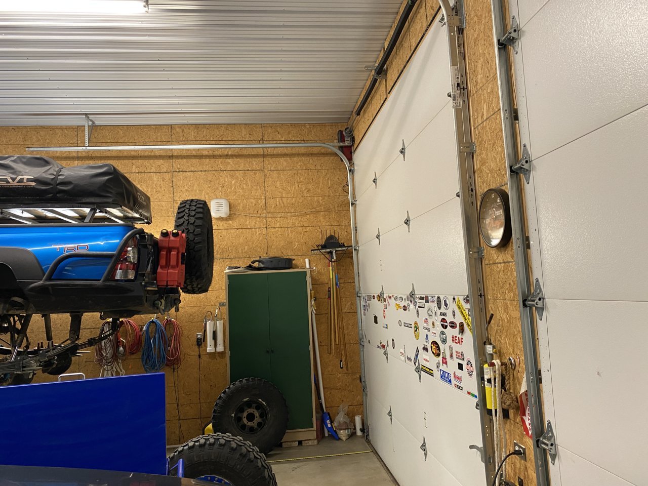

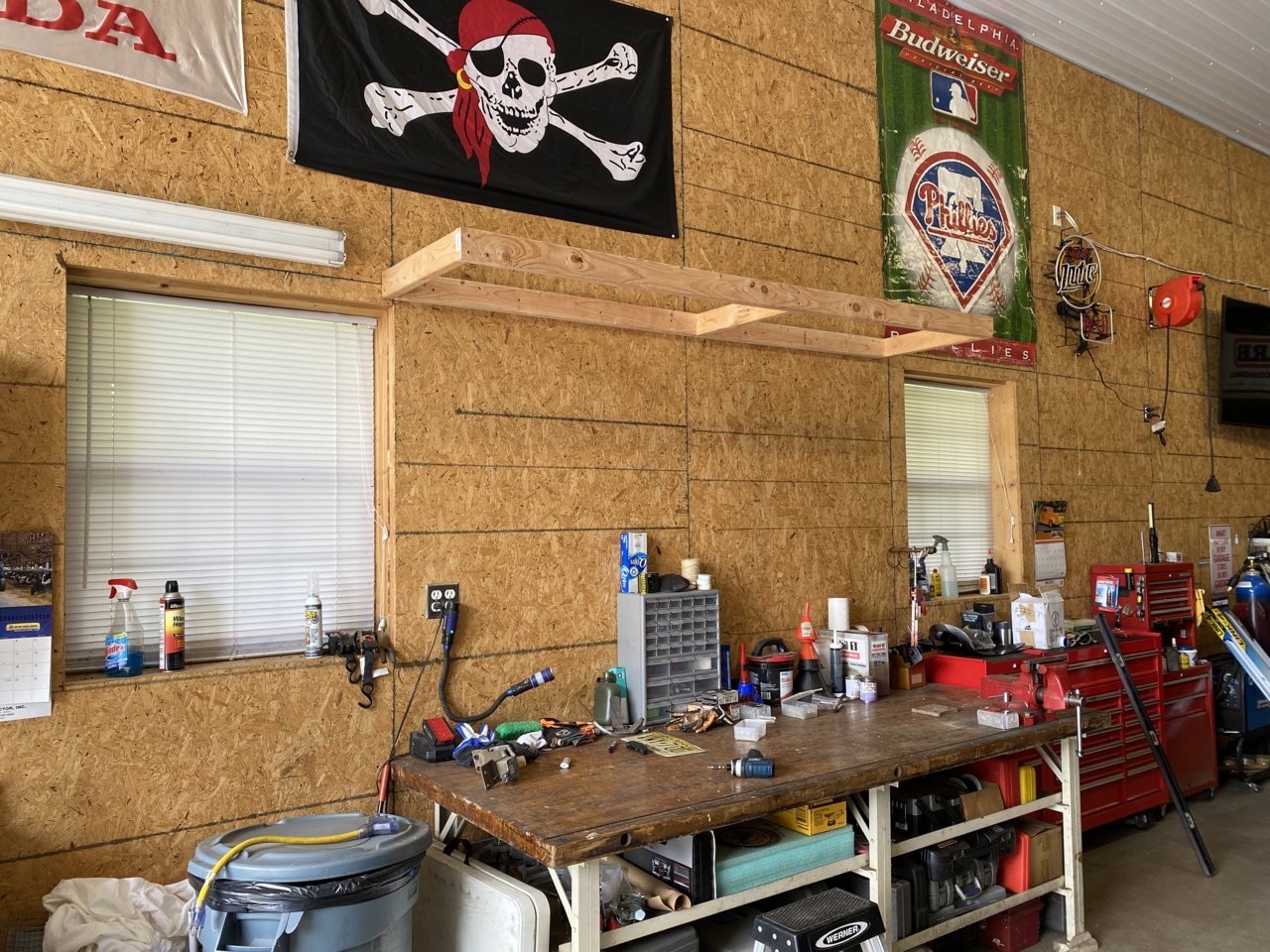

    Random question... how far is your lift setback from the door?
  15. Jul 6, 2021 at 8:46 AM
    #1475
    6 gearT444E
    6 gearT444E [OP] Certified Electron Pusher
    Feb 3, 2018
    #243372
    7,798
    Deep South
    Herculiner Hootus

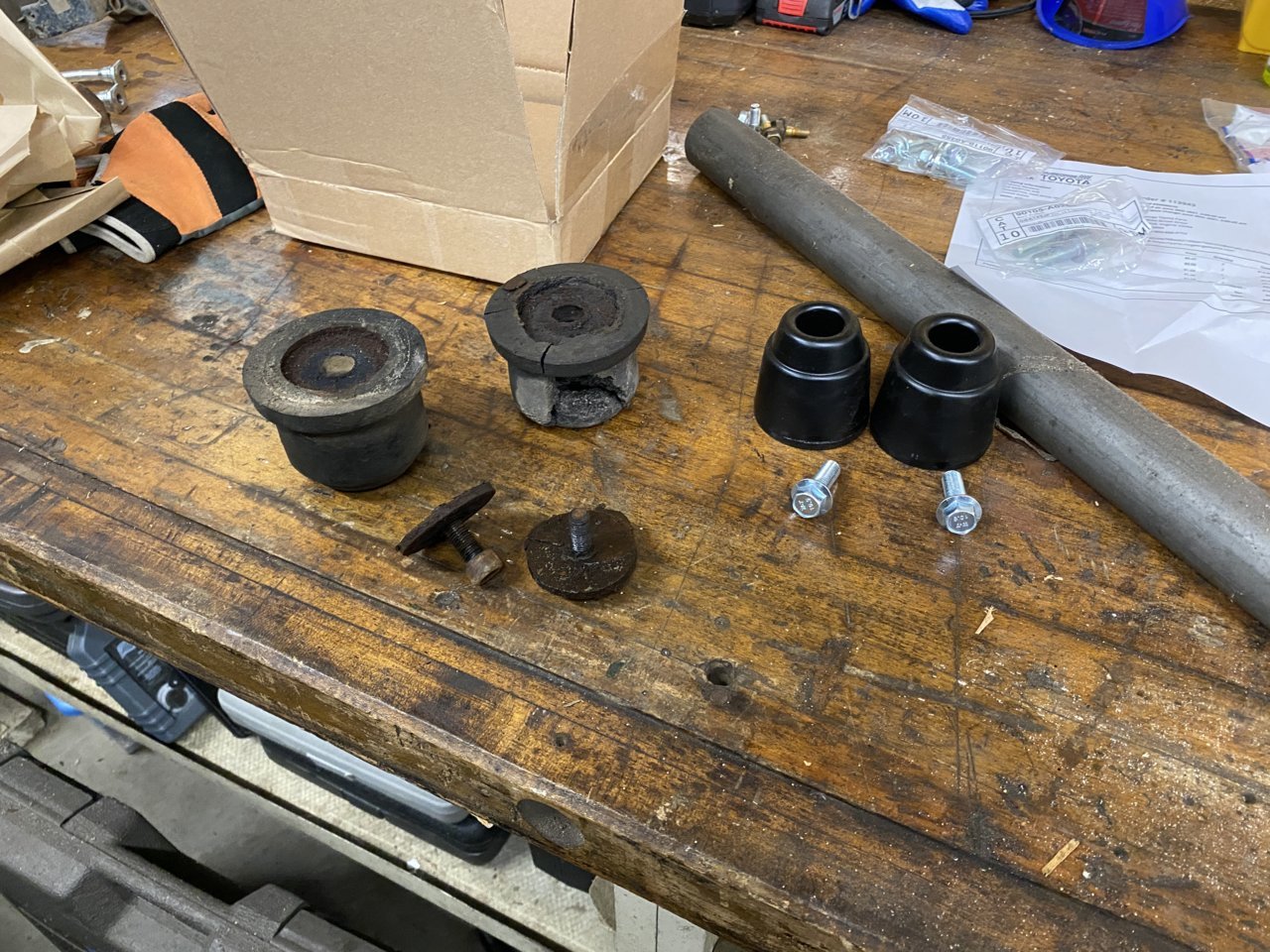

    I went out and measure this morning, it’s right at 17.5’ to the center of the lift post from the door. This leaves me about 6’ of clearance from the back of the tailgate to the garage door while on the lift. A full size rig or a long bed taco will obviously be a little less clearance. I’d place it to where you have at least 3-4’ of working room based on the largest vehicle you plan to put on there.
    got the old bump tops off this morning. The passenger front one was a struggle. Glad nothing snapped though, used plenty of kroil for several days. 10 year old wheelers bumps vs new durobumps
    Off to pick up some RTV and mess with the axle seals this afternoon.

    Well looks like it’s time for some new wheel bearings too. Fawk me

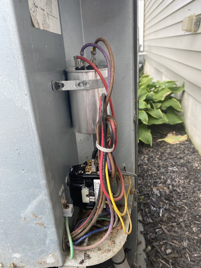

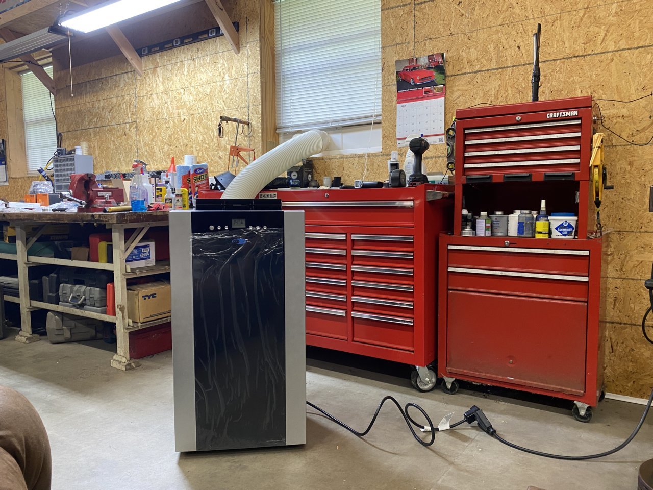

    Well things are progressing anyhow. I was out of town last weekend and this week waiting for parts to show up. These came today, the bearings and brakes should be here thursday, and I haven't gotten a shipping notice on the retainer and lock ring yet hopefully that will ship and get here by end of the week.
    Instead of working on the truck I got to replace cap and contactor since my AC decided to take a shit last night.
