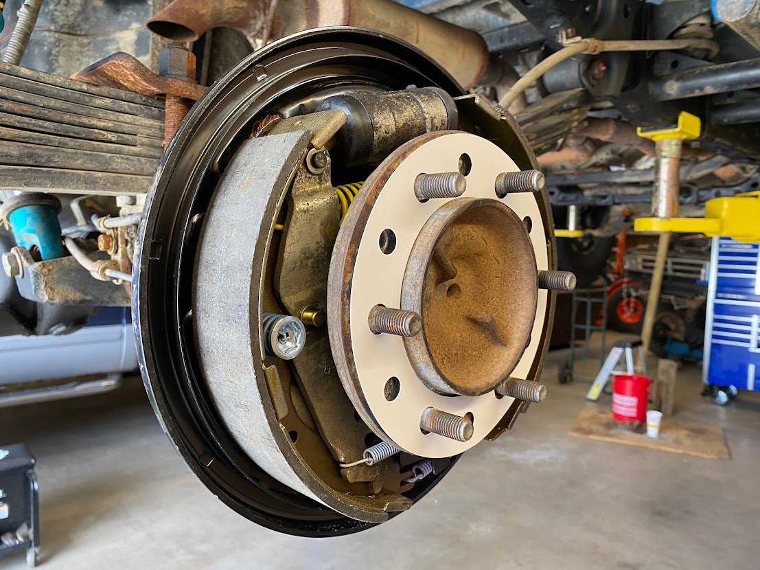

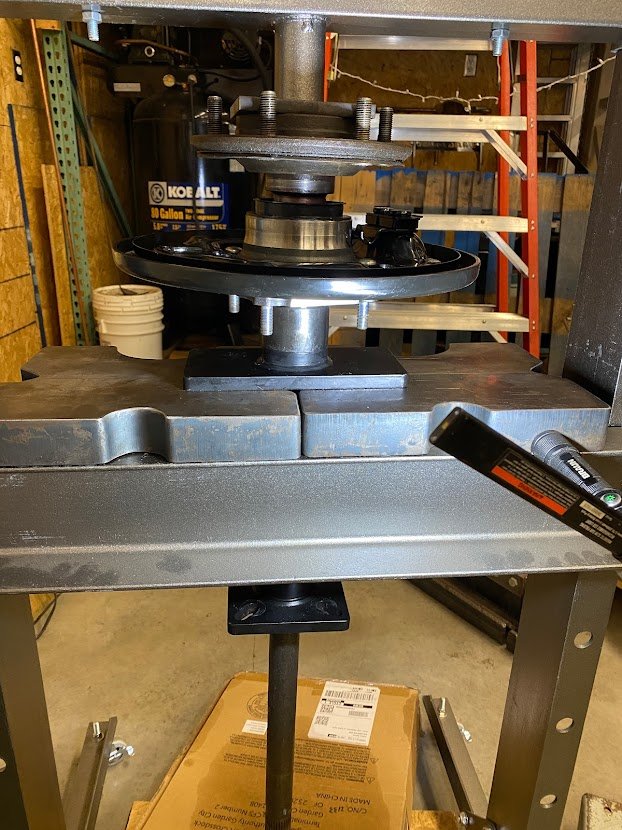

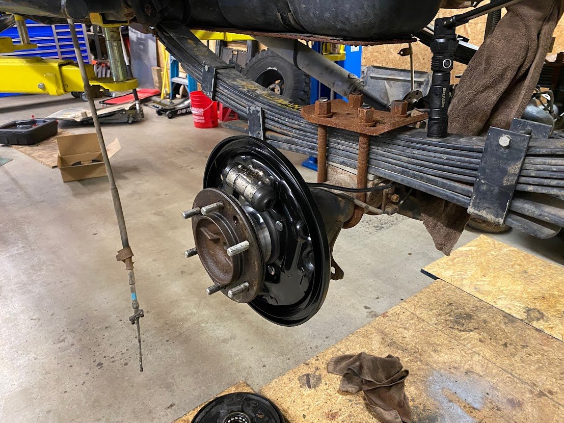

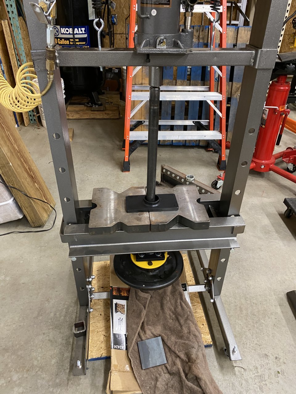

    Ok well I'm going to attempt a rear bearing replacement and writeup today to help others in the future suffer through this misery with me. Y'all know misery loves company.

    the bearing that’s pressed onto the axle?

    yeah. I got one side done yesterday but beer got in the way of the other side. Maybe I’ll finish today. Hope I remember to take pictures otherwise it won’t be much of a write up :rofl:

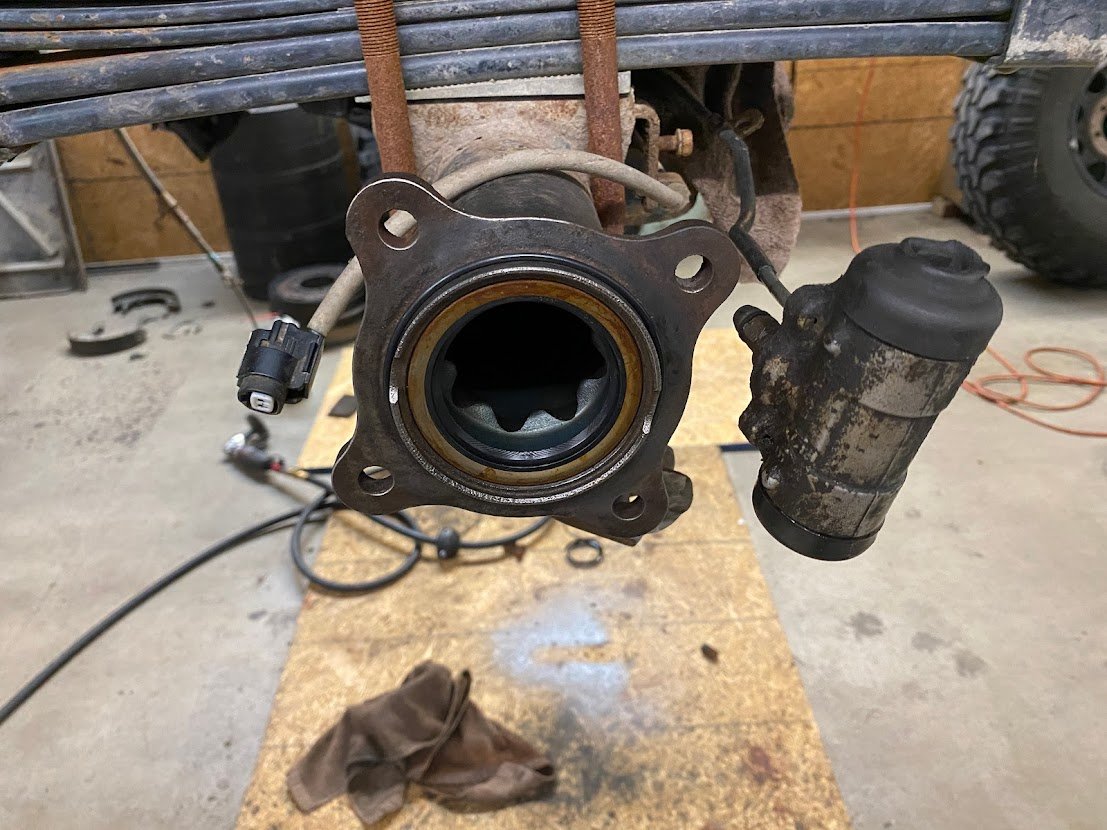

    Deep South
    Herculiner Hootus

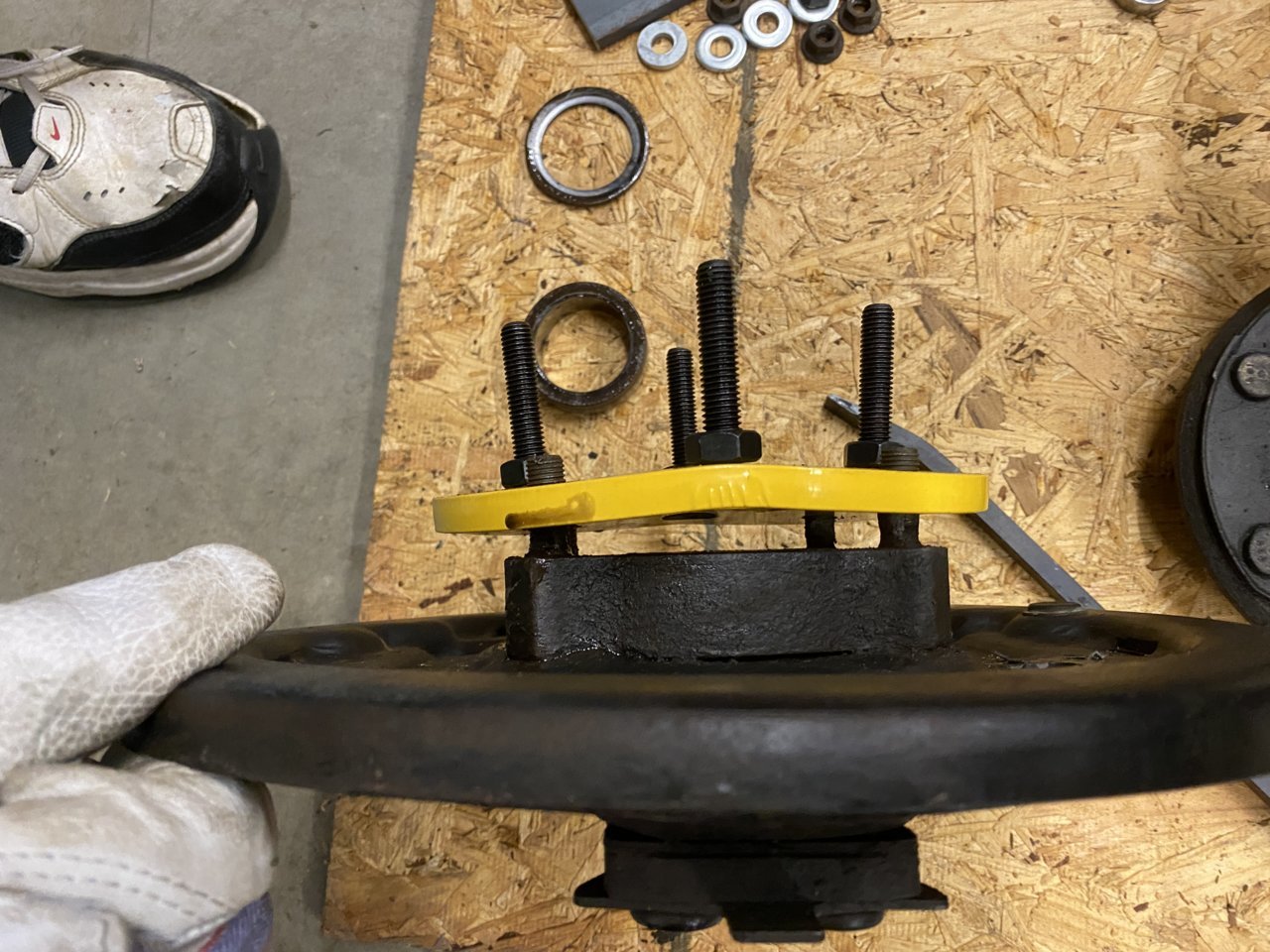

    2nd side was fun, bent the adapter plate, and the studs are seized in the housing. I ordered a new backing plate to avoid dealing with this any further.

    nope, not with me. I’d have been better off lighting the axle on fire and calling insurance. At this point the whole axle assembly will be new minus the wheel cylinder and the shaft itself :rofl:

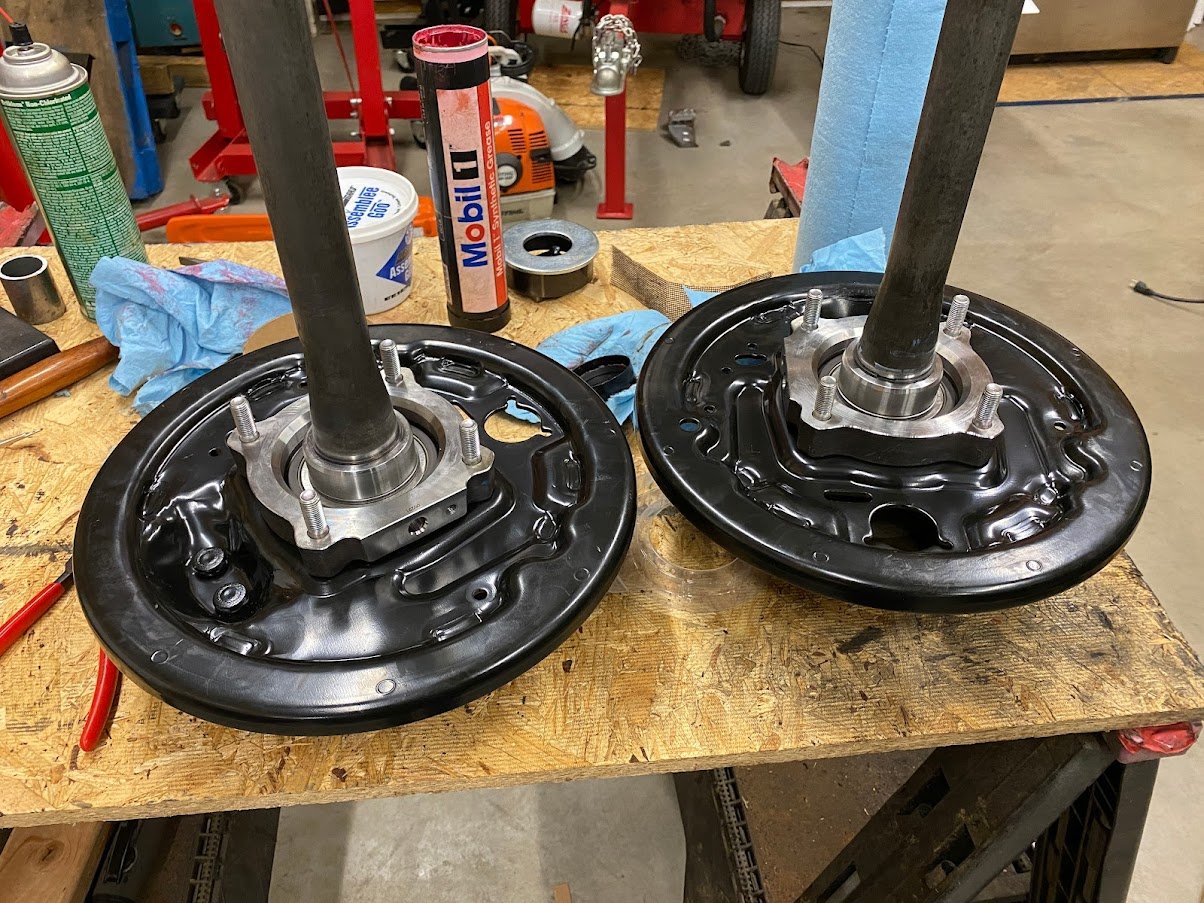

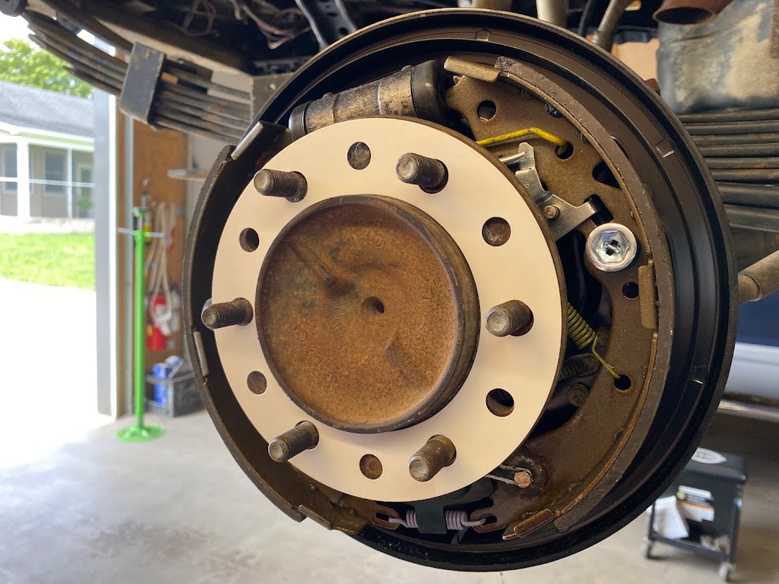

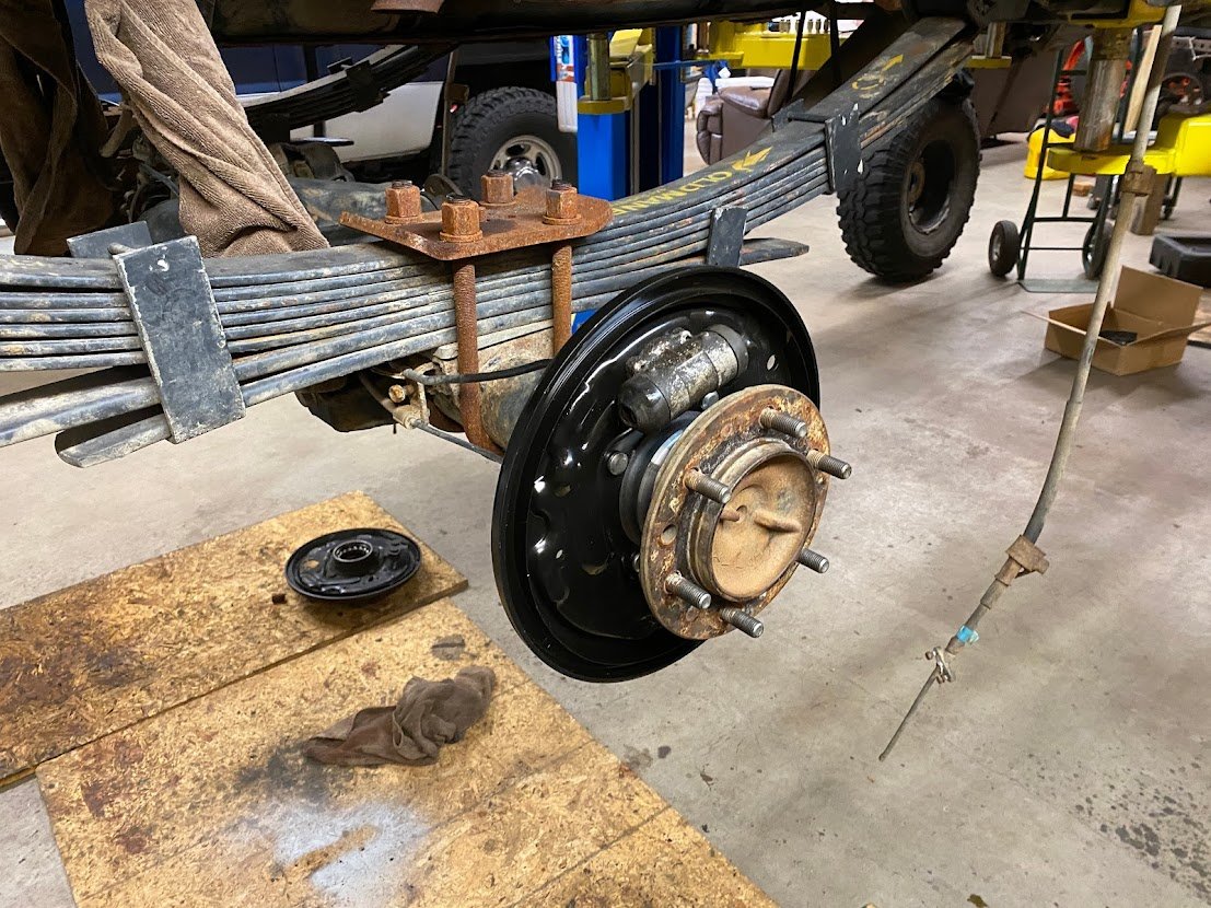

    New bearings, backing plates, studs, retainers, belleville washers, snap rings are installed. Now just to put everything back in the axle housing.

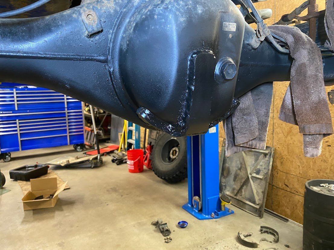

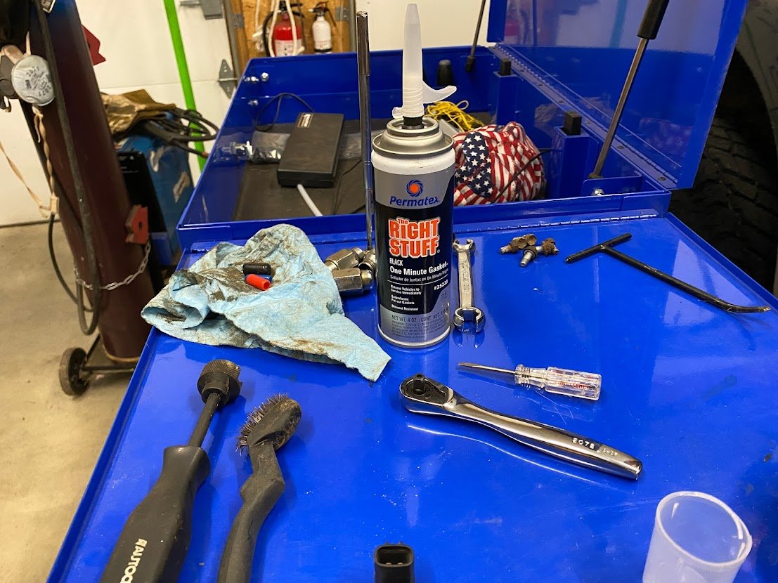

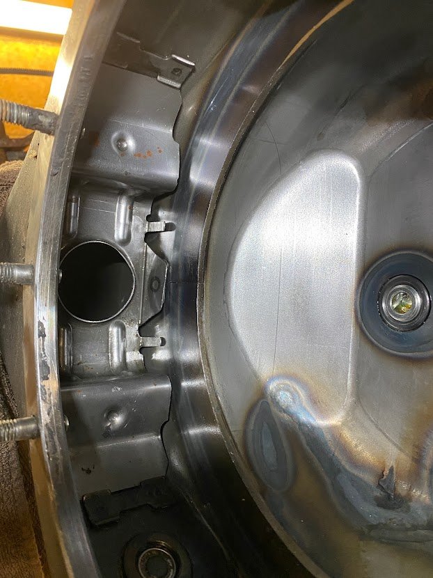

    Herculiner Hootus

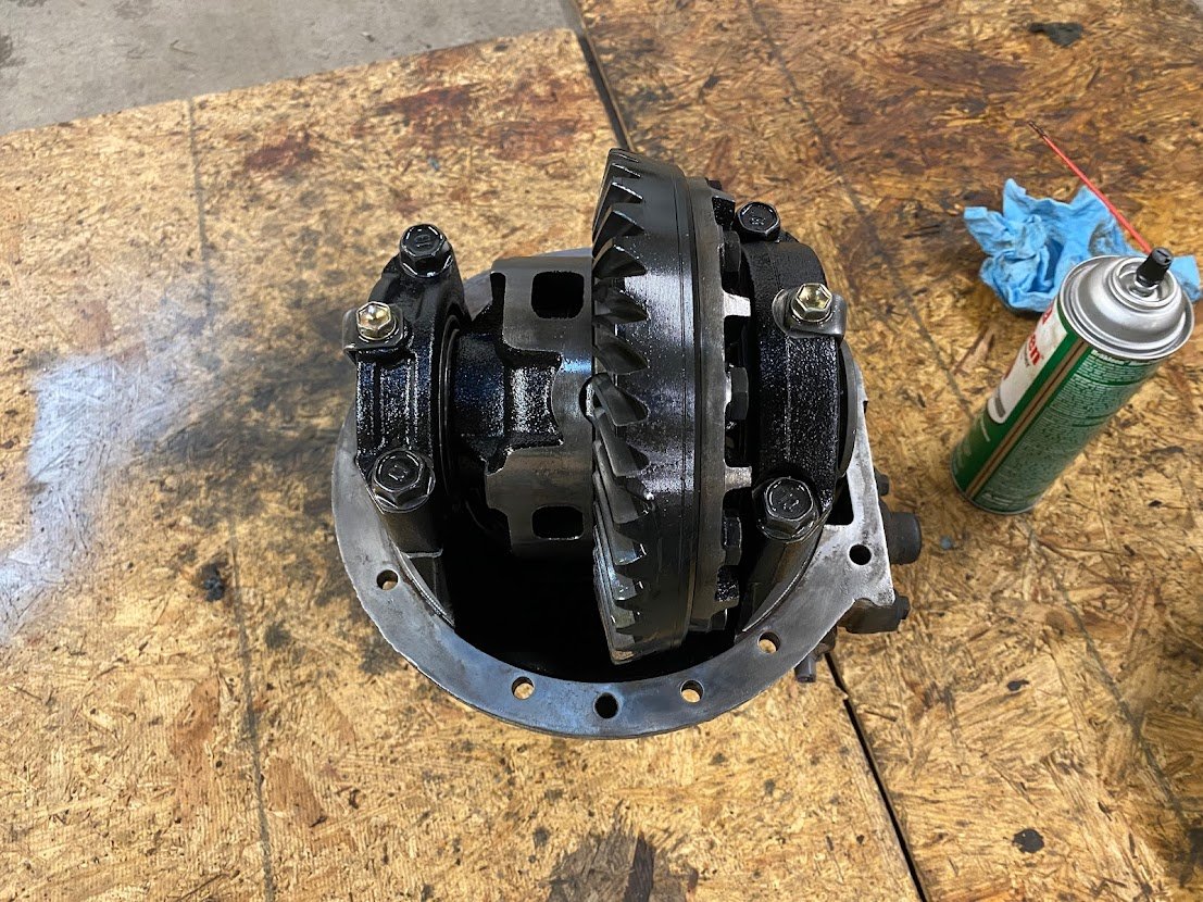

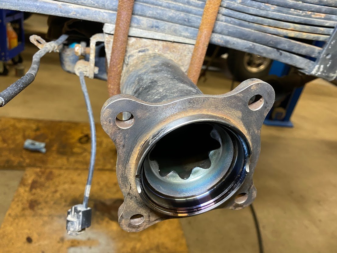

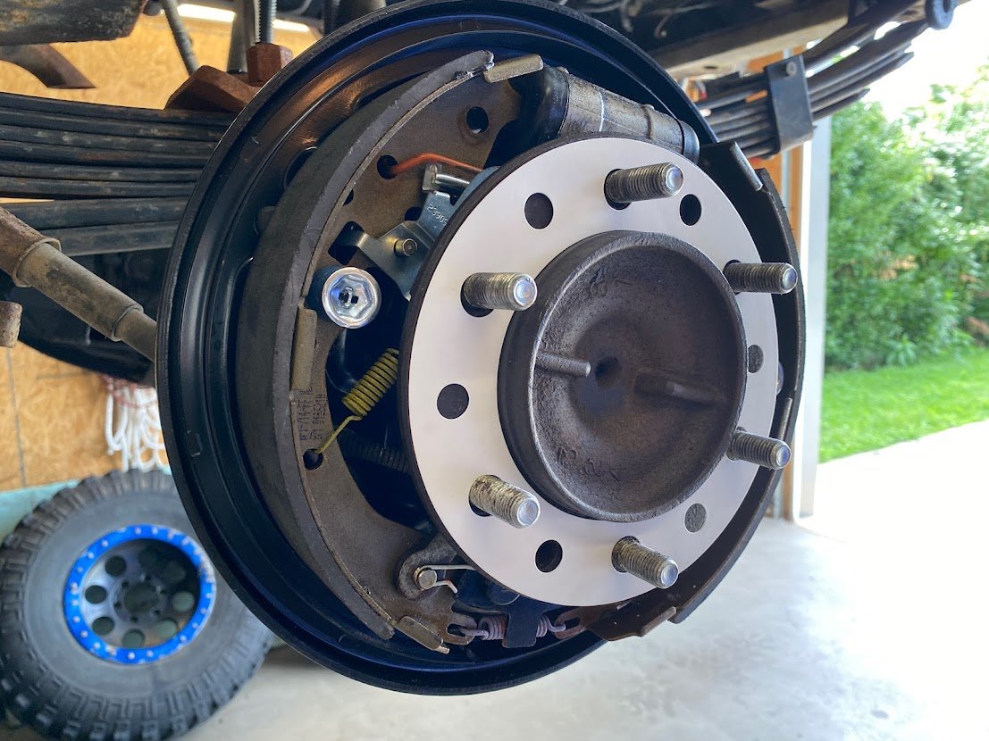

    Got the diff armor welded up today while the 3rd member was out. I had this thing sitting around the shop for around 2 years, think @Chux gave it to me LOL
    3rd member sealing surface cleaned up
    Take note not to fuck with these baffles, I had hit one with the axle shaft and bent it a little bit. It's only held in via a few welded tabs and spring pressure. If it comes loose it will make lots of funky noise.
    This is the only RTV I'll use now, the other shit always ends up leaking. Never had any problems with "the right stuff"
    Axle flanges all cleaned up
    New seals and o-rings installed

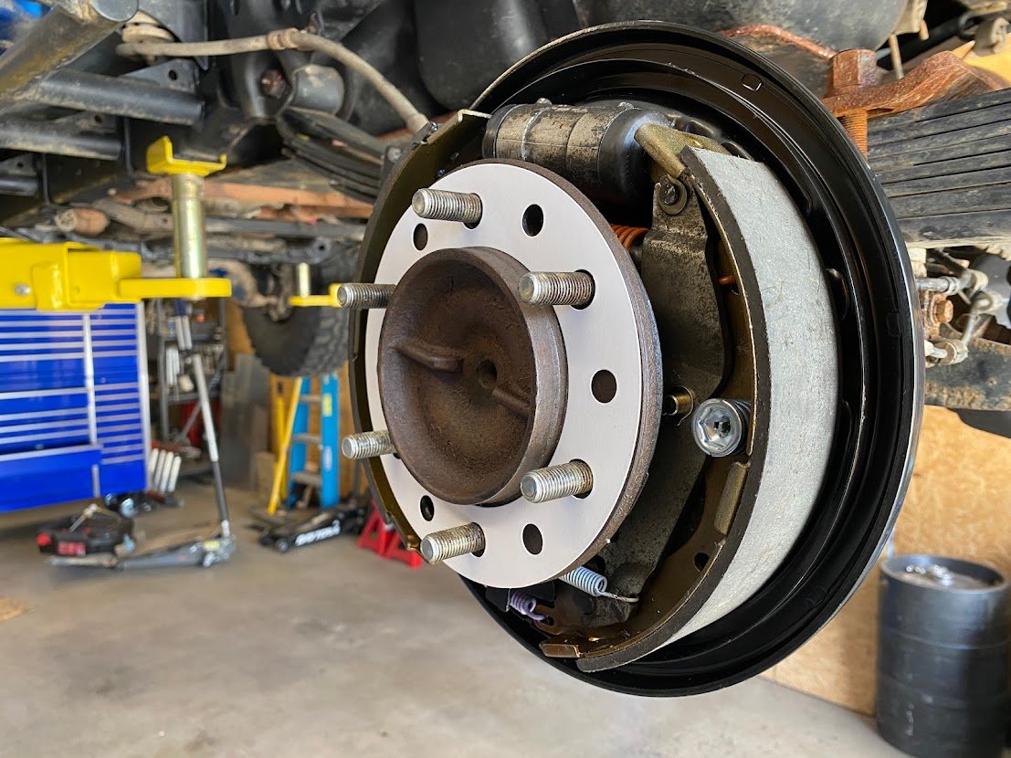

    Both axle shafts installed and torqued. Tomorrow's job is to install the brakes and fill up with diff fluid and I should be good to go. I also trimmed my rust ass ubolts a bit so I can get the rear bump stops set up properly, that'll be next on the list to knock out.
    Bastek, Chux, geekhouse23 and 4 others like this.

    For real, this morning I got the driveshaft u-joints all greased, brakes installed, bled, and adjusted, and touched up the frame with Eastwood rust encapsulator
