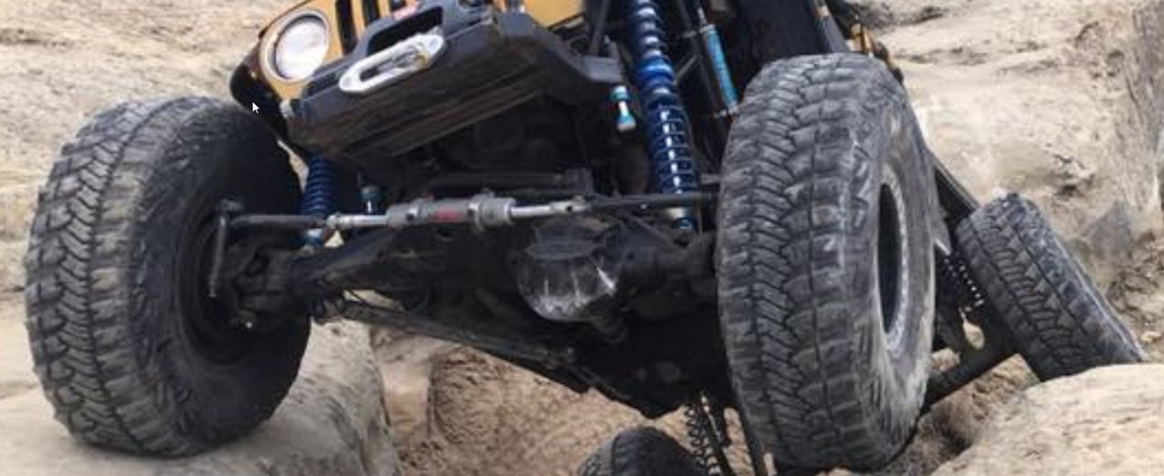

    So I would not weld on a truss that you need to cut off again to install something else. I went full in on my steering. To run a full hydro and make it last, the truss needs to be beef.
    The kits are spendy, but if you look and piece mail the required parts it could be cheaper. Aluminum links through wide open design are the shit...fyi.

    Another thing is you don’t have to mount the top link on the top of the truss. I mounted mine to the back to get the geometry right.
