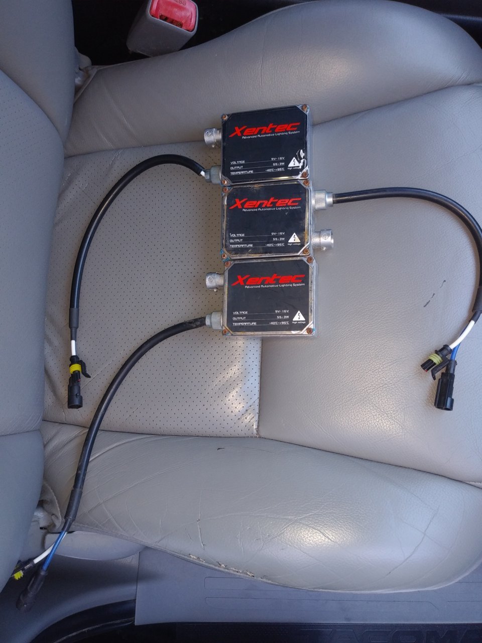

    Marsauto LEDs in license tag lights Marsauto LEDs in map lights Yorkim Red LEDs in High mount brake light Zevo LED in dome light (may change that, it is not too bright)
    Okay, my inquiry is this: I have a 2012 Prerunner TRD Sport V6 Double cab with the standard reflector headlights but a coworker gave me these.
    How would you go about installing them, what type of refitting/retrofitting would be needed to avoid harming other drivers?

    Sure thing man! The nice thing about these trucks is that those housings are MASSIVE. You can fit really anything you'd like in there Projector-wise! Personally, I would look into either a Mini H1 HID Retrofit setup or the Mini D2S 5.0 Setup from Morimoto. You'd have to find a shop to get that installed at, or look into some other projects to see about doing it yourself. (I'd be happy to help you source a near-by Shop!)
    The Mini H1 and the D2S 5.0 from Morimoto are Awesome Projectors. Every little bit of Quality is there and honestly I have yet to find a better projector. The Retrofit Source would be your best niche with a Custom headlight setup!
    TRS Projector Retrofit Kits: https://www.theretrofitsource.com/projector-kits/retrofit-kits-universal
    Those are 55w Ballasts in your photo with an AMP Igniter connection that is commonly found on aftermarket ballast setups. You can use those with your Retrofit if you prefer, but I know Morimoto HID Kits are about $150 for the full setup and they pair well with their Projectors.
    Let me know if you have any more Qs on this one - I know it's an In-Depth topic! :)
