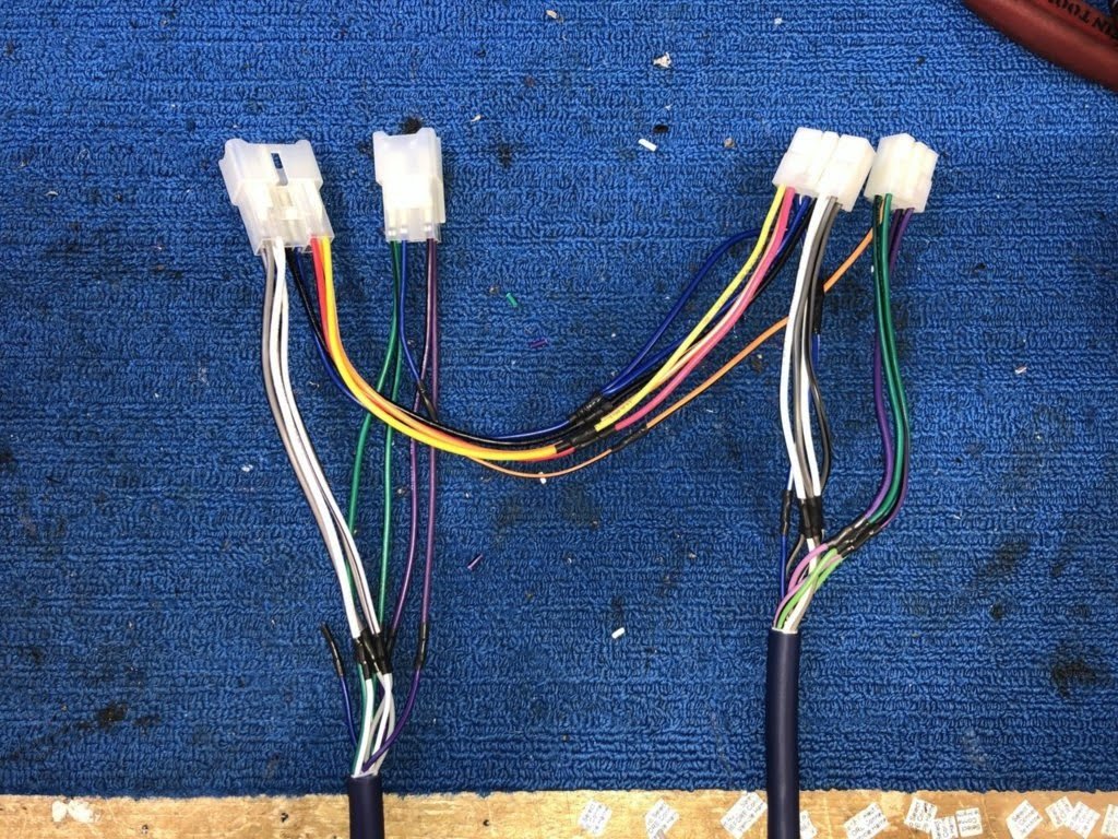

    I made the custom harness to retain the factory headunit, LC7i, did a 4 channel amp, all new speakers and 2 8" subs and was pretty disappointed.

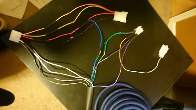

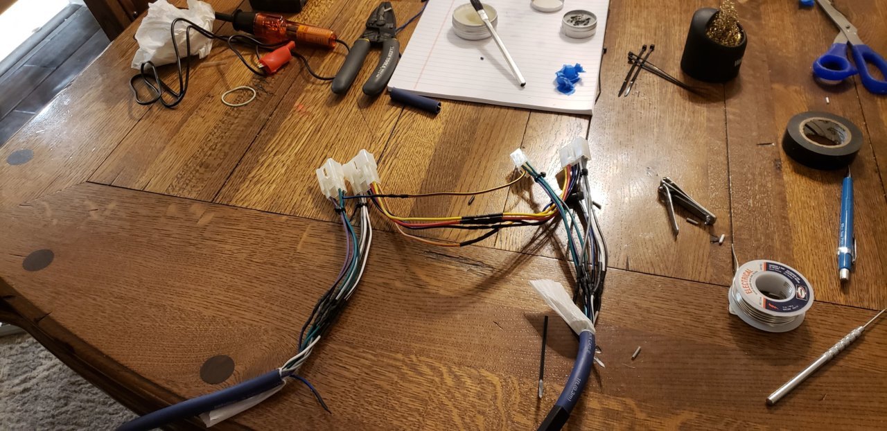

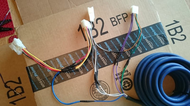

    Here are some photos of the harness I did and that someone else did for your reference though:
