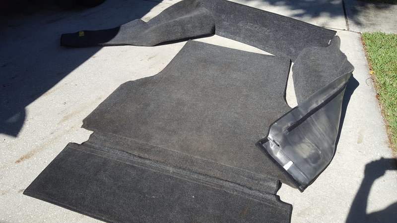

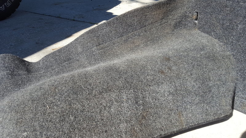

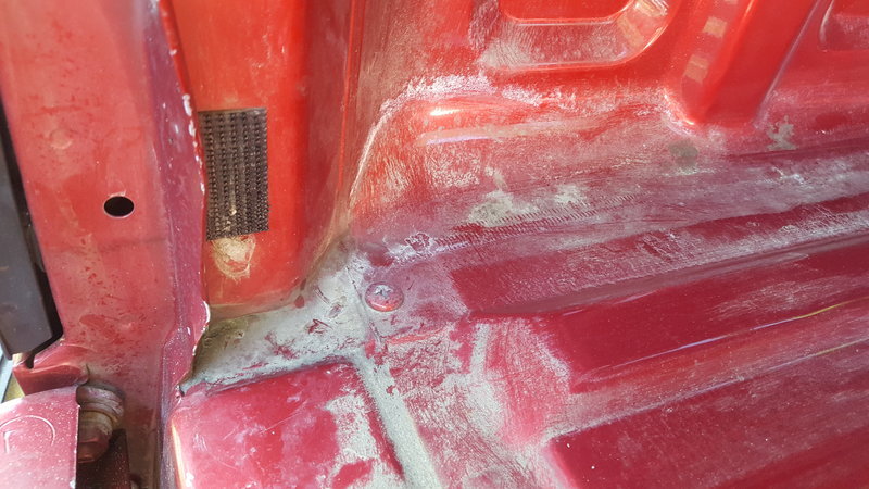

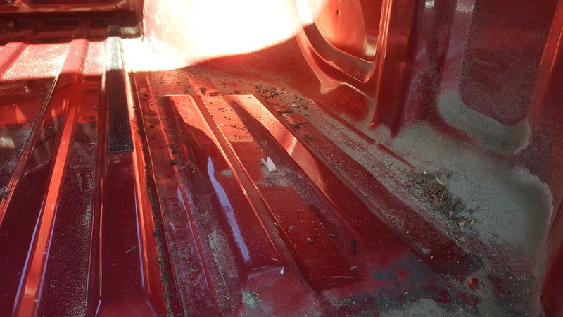

    I recently replaced my wrecked 2003 extra cab with a 2003 double cab wiiiiith, a snugtop cap and bedrug. I've been giving her a full detail this weekend and started on the bed just a few minutes ago.
    Zipper. I used some WD-40 to get it started, then sprayed a little more on the tongue whenever it stuck. Worked like a charm. Also, if it's dirty, vacuum the track FIRST. Figured that part out halfway through.
    This was a one owner vehicle and to my delight, there is a virtually new truck bed under the rug. There is a couple of rust spots and a few areas where dirt built up, possibly rubbing the paint. Still easily 95% of the paint is flawless.
    Now the bedrug itself isnt terribly stained and is in great shape overall, however it's as dusty as Afghanistan. I'm going to use a carpet vacuum on it first then wash it with some laundry detergent, a scrub brush, and hose.
    Ill post some photos in a bit.

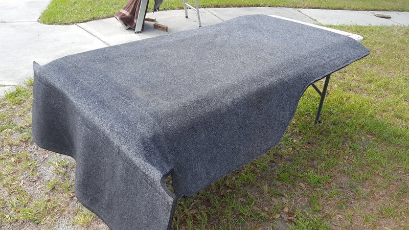

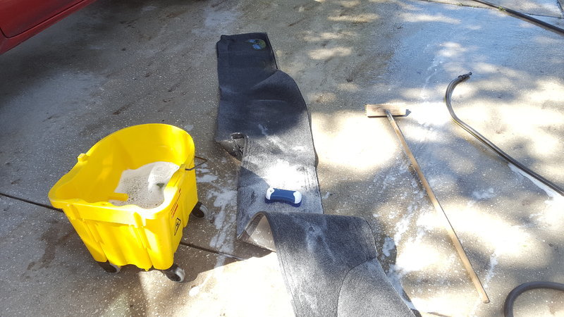

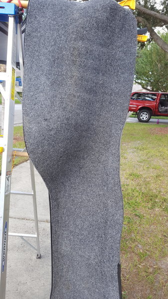

    All finished. This thing dryed surprisingly fast and cleaned up nicely. You can see some of the dirt build up but it didn't do too much damage. Defiantly a quailty product! Very glad it came with the truck!! ;)

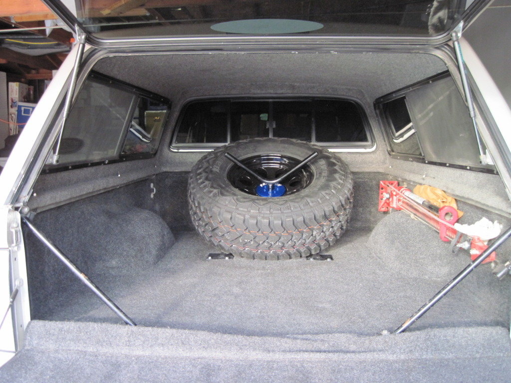

    without my shell...
    with my shell...

    I really like what you've done with your set up! Seeing it makes me excited about the possibilities knowing it performs as well without a top. Also, never thought to bold hardware threw the rug as you have. Great idea.

    It was very surprising to see how mint the Bedrug kept the actual bed. Also, real easy to clean! Mine is clearly from DOP, thus 13 years old. The underside of yhe rug looks like it was purchased a year ago.

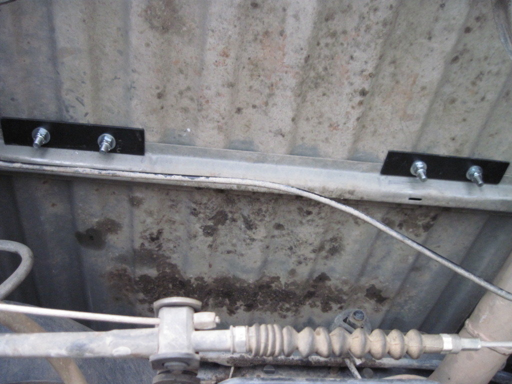

    Thanks... tho' I must admit I was somewhat reluctant
    to poke holes thru the BedRug to install my spare tire mount.
    But the tire is really too dang big to stow underneath unless on the tarmac.
    So in the bed the spare had to go.
    The underside of the tire mount is supported with backing plates
    that cannot not bend when the bolts/nuts are tightened.
    So it's a solid mounting.
    here for more... http://s426.photobucket.com/user/TTORADell/library/Fabtech spare tire mount?sort=3&page=1
    I repainted the areas of the bed I had to drill thru
    to minimize the chance of rusting.
    I also used silicone to seal the bolts holding
    so that water cannot intrude thru those.
    This tire mount will however sandwich and likely flatten the BedRug some
    in those areas that the spare tire mounting pedestals mount.
    But quite honestly I doubt I'll ever remove my spare tire mount...
    and expose the holes remaining in the BedRug.
    Unless I pull the BedRug out for cleaning or what's underneath it.
    It's mostly in there to save my knees when crawling around/inside the bed.

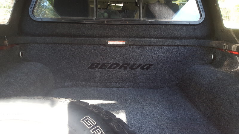

    Threw a little black paint to accent the lettering. TacoDell. Yeah I checked out your album, nice rig!
    I think the foam material underneath has a lot to do with its ability to repel water and not smell. That foam has no absorption at all.

    I have found that some dust - dirt ends up underneath the BedRug.
    Likely because the bed, tail gate /or shell are not sealed well.
    And so dirt and dust can still enter and permeate thru the rug
    ending up underneath that and on the bed's surface.
    If that residual remains ignored underneath the rug...
    it can cause abrasion to both the BedRug's under foam material...
    as well scuff (marr) the beds painted surface.
    If the bed's painted surface becomes marred enough to expose metal...
    any moisture trapped in/under the rug can cause the bed's surface to rust.
    So a wet BedRug could create more problems if moisture is left unchecked.
    So in other words...
    expect to occasionally remove the BedRug and clean out any dirt or dust under the rug.

    Yes the dirt trapped underneath is the Achilles heel.

    Great job on the lettering fati tacoma. Which paint did you use?

    Thanks!!
    Some acrylic hobby paint and a brush. Put on kinda thick, took about 20 mins.
