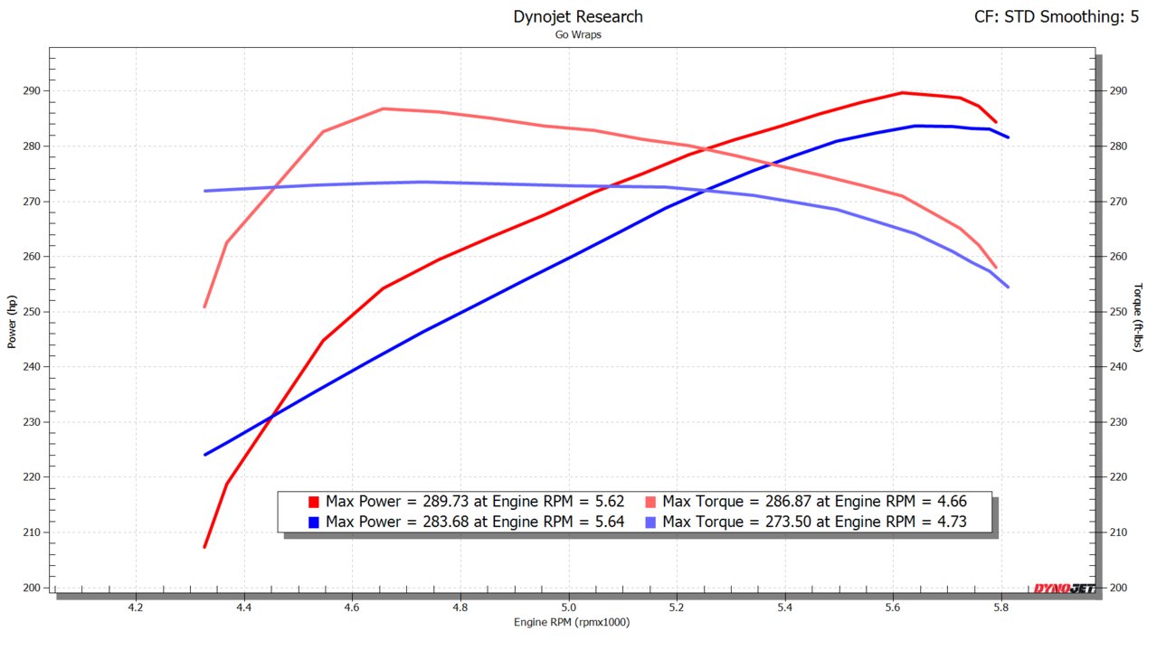

    Dyno chart of before/after on my personal truck. Its not about peak HP gain @Revelations The delta between the two curves is what is significant.
    Blue=stock solenoids
    Red=modified vvti solenoids
