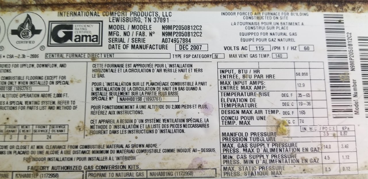

    Take a pic of the data plate and post it.

    The filter is only about 2 weeks old - something that makes it take longer is that I have dual zone with a huge open foyer and the upstairs heat is not always on to equalize so some of the heat just goes upstairs. Data plate?

    Billy
    Largo Florida
    '13 5 lug AC w/convenience package
    A few OE parts from fancy trucks
    Something like the sticker in your truck door jamb. Like this

    Data plate is on the inside of the unit, bottom or side, you will see it. It will look similar to what Bill posted.

    Now you tell me lol. Do you have a probe type digital thermometer? The air temp entering the furnace, and the temp leaving the furnace will show the temperature rise. Data plate will show max temp rise. I'll bet it's over limit. And the high temp limit switch should cut out before a rollout switch.

    Temp rise is the temp difference between the air entering and the air leaving the furnace. It will be listed on the data plate.

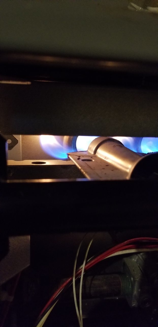

    I think I've found the problem. The metal tubes, they look like the flamethrowers, spit out the fire. Well, it looks like the fire is coming out through the sides on the business end and hitting the metal on the OUTSIDE of the tube that goes into the heat exchange. Sure enough, I looked at the "good" furnace upstairs (exact same) and the flame went 100% into the heat exchanger.

    Update: I swapped the tubes from the working upstairs one (which looked great) to the downstairs one and the flame did not shoot out the side like the old one onto the metal. Time will tell if it works. I cleaned them both good with a copper brush, the old one was very clogged.
    EDIT: Didnt make a difference.
    Ran it with the door off for 30ish minutes, ran.
    Closed the door, 5 minutes later, turned off. I felt the tripped rollout sensor and it was very hot. I was watching the flame the entire time and it never "rolled out" but I believe the heat is traveling from across the metal to heat it up from the heat exchange inlet.

    That's a lot of yellow flame on that burner which causes more sooting (lazy flame). The flame should be about 1.5 to 2 inches long and 90 percent blue for the length of the flame.
    I am not a hvac guy, but I work with a lot of gas appliances.
