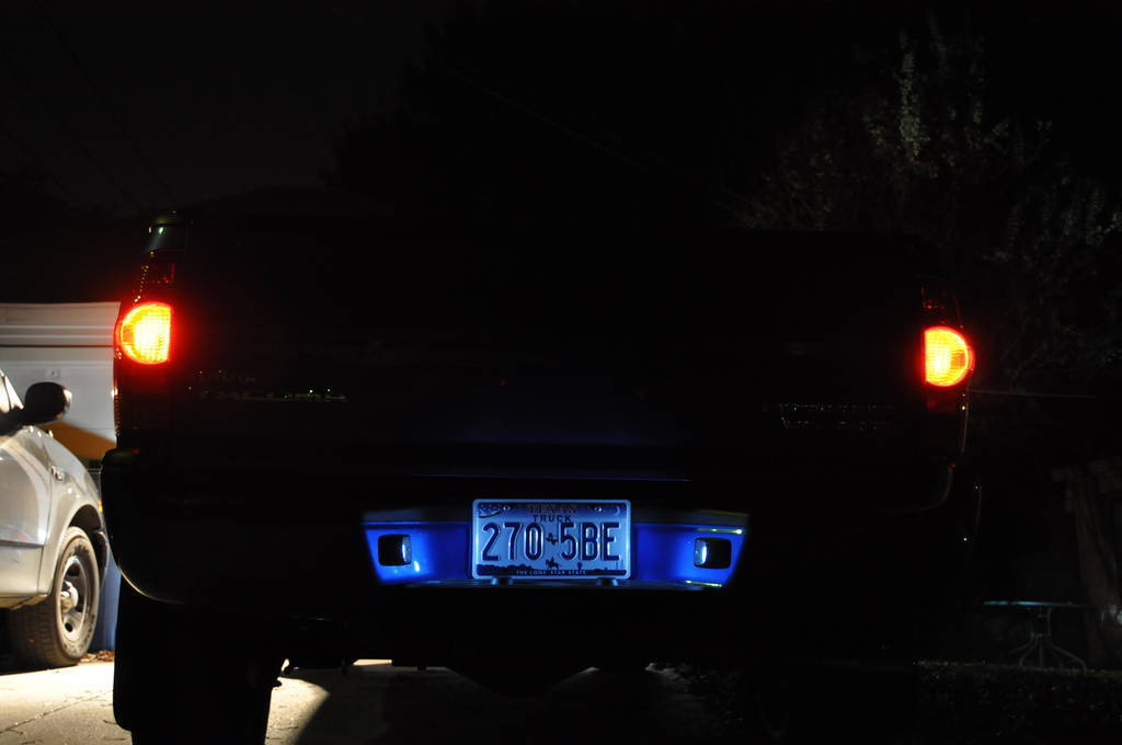

    I finally got some pictures of the truck, here's the LED lights:

    Those looks crazy blue.. but then again your truck is blue! So its hard to truely tell

    Yeah, it does look a bit blue in the picture, especially next to the very yellow light of the driveway, but in person it's a clean-white light on the plate. The blue of the truck tends to tint it a little. The best comparison that I can make is to that of the LED license plate lights on late model Lexus cars, it's roughly that color.
