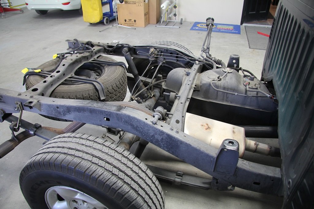

    That doesn't look like a factory muffler in that pic.

    Muffler in the pic already looks like some sort of flowmaster or other chambered muffler

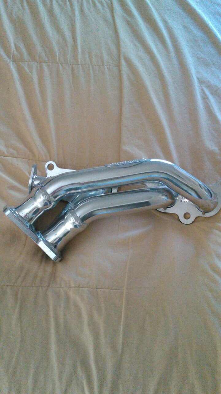

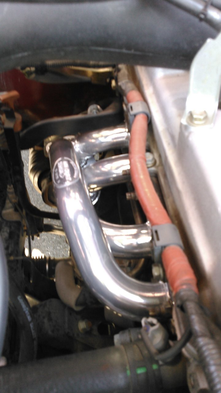

    Put a header on the 4cyl and the exh note will sound alot better . I'm running a Doug Thorley Shorty Tri Y # 511y1c on my 02 Tacoma DC Pre Runner . I was recommended this design header as I'm running a supercharger. This design help to quickly scavenge exh gasses and will make more hp , plus it has a high temp finish on it
    Cylinders #1 and #4 share one collector and cylinders #2 and #3 share another collector
    I'm also running a magna flow cat back and I've been told by friends the exh note doesn't sound like a 4cyl but more like a 6 cyl

    Nice and thanks for the pic. How much

    I think I paid $450 for this header and its a direct bolt in requiring no modifications
    Just checked Summit Racing and they've have that header listed at $329.00

    A tri-y header like the Doug thorley is better for bottom end power, where as a long tube header will give a bit more top end power.
    I have the cheapo pacesetter long tube on my 2.7 and definitely noticed some gains.
