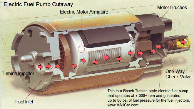

    It's less Tacoma and more mod
    This is an old wives tale, the pump actually pumps fuel through it's internals (armature, brushes... All that) so as long as you still have fuel the pump is more than adequately cooled

    So gas is running thru the motor..... Armature, brushes, etc. Sure it is. Ever seen brushes arc? I have but not running in gas. And I don't want to.

    I won't make you eat crow, but @Crow_of_judgement might
    It takes more than some snark to be correct

    Hey, I was just about to post the same motor cut away that @Speedytech7 did. In lieu of that, the why it is OK to run fuel through the pump from Wikipedia:
    Though electrical components (such as a fuel pump) can spark and ignite fuel vapors, liquid fuel will not explode (see flammability limit) and therefore submerging the pump in the tank is one of the safest places to put it.

    I stand corrected. My apologies. I was thinking of a drill motor running in near dark and saw all the arc.
    I'll sit down and STFU now. :oops:
