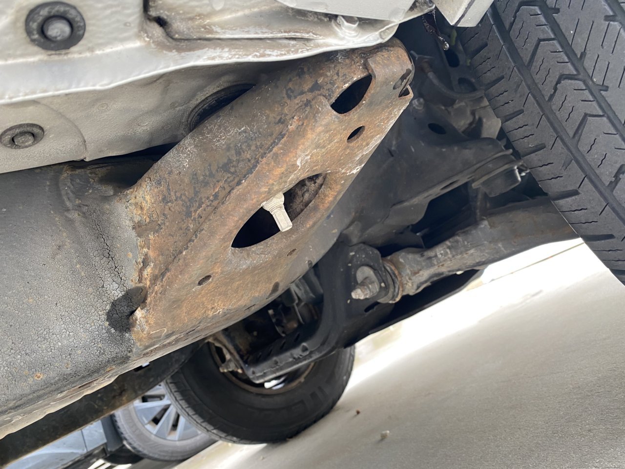

    Got this truck a couple months ago, haven’t used much, i Have noticed wen rains under the driver side by the front wheel gets more wet than the left side.
    Do far it’s dried inside, carpet is dry, no funny smells.
    Any ideas? Repair suggestions? Just leave it alone?
    Thank you.

    Pull the carpet back, it looks like water is coming from where the cab mount is.

    Put a 1” body lift on it, while you have the truck body and frame separated to instal the pucks, look and see what, and where it’s leaking. I’m fairly certain there’s a hole or tear in the stock body mount under the driver, might just be loose.

    Sorry for the misunderstanding, the truck has been parked all the time. Its a second car i have and it’s parked. I am undercoating the frame so wen I went to inspect, I noticed that.

    The cowl drains into that area when it rains. Do you park on a slope? Is the passenger side clogged?
