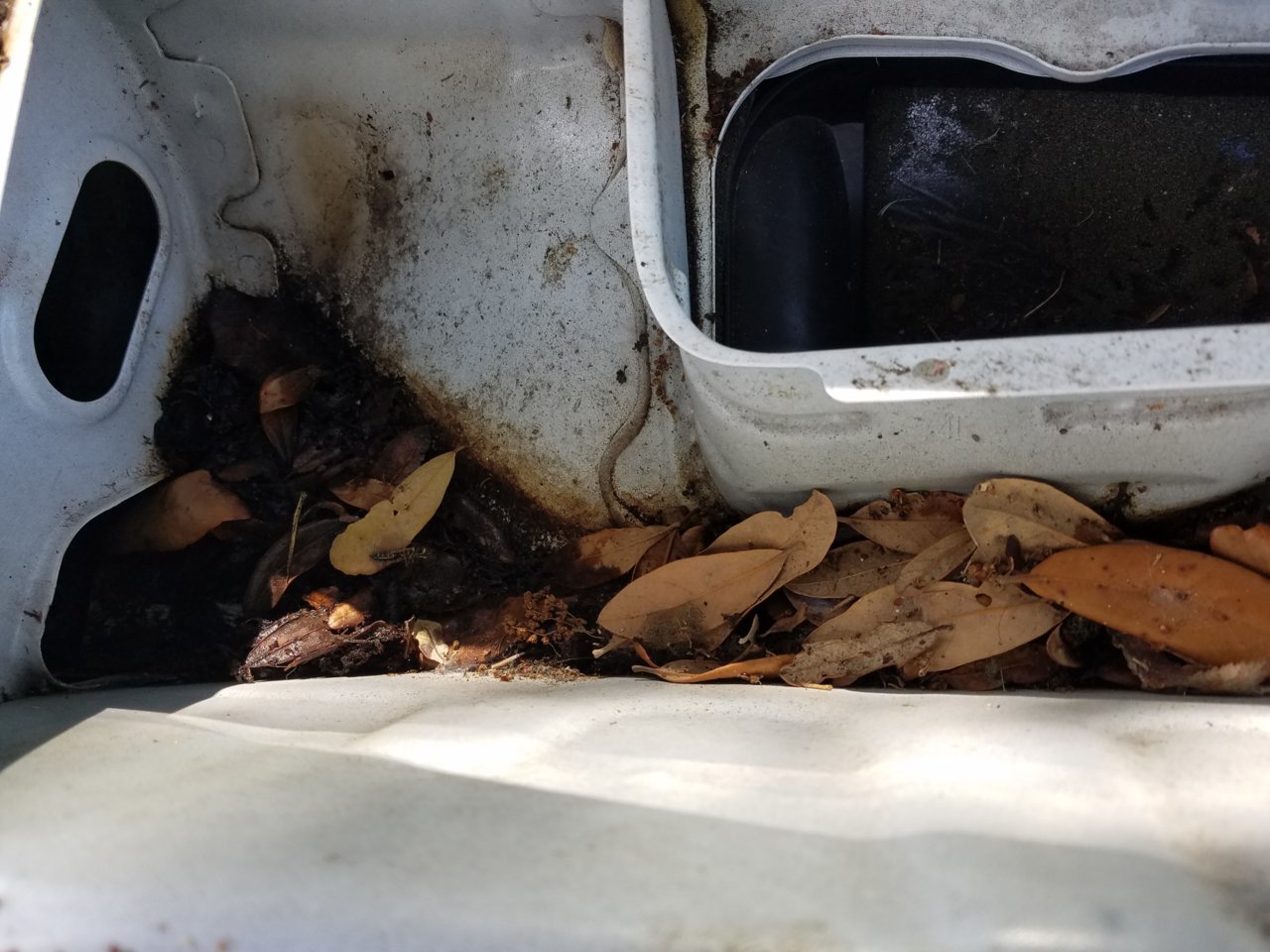

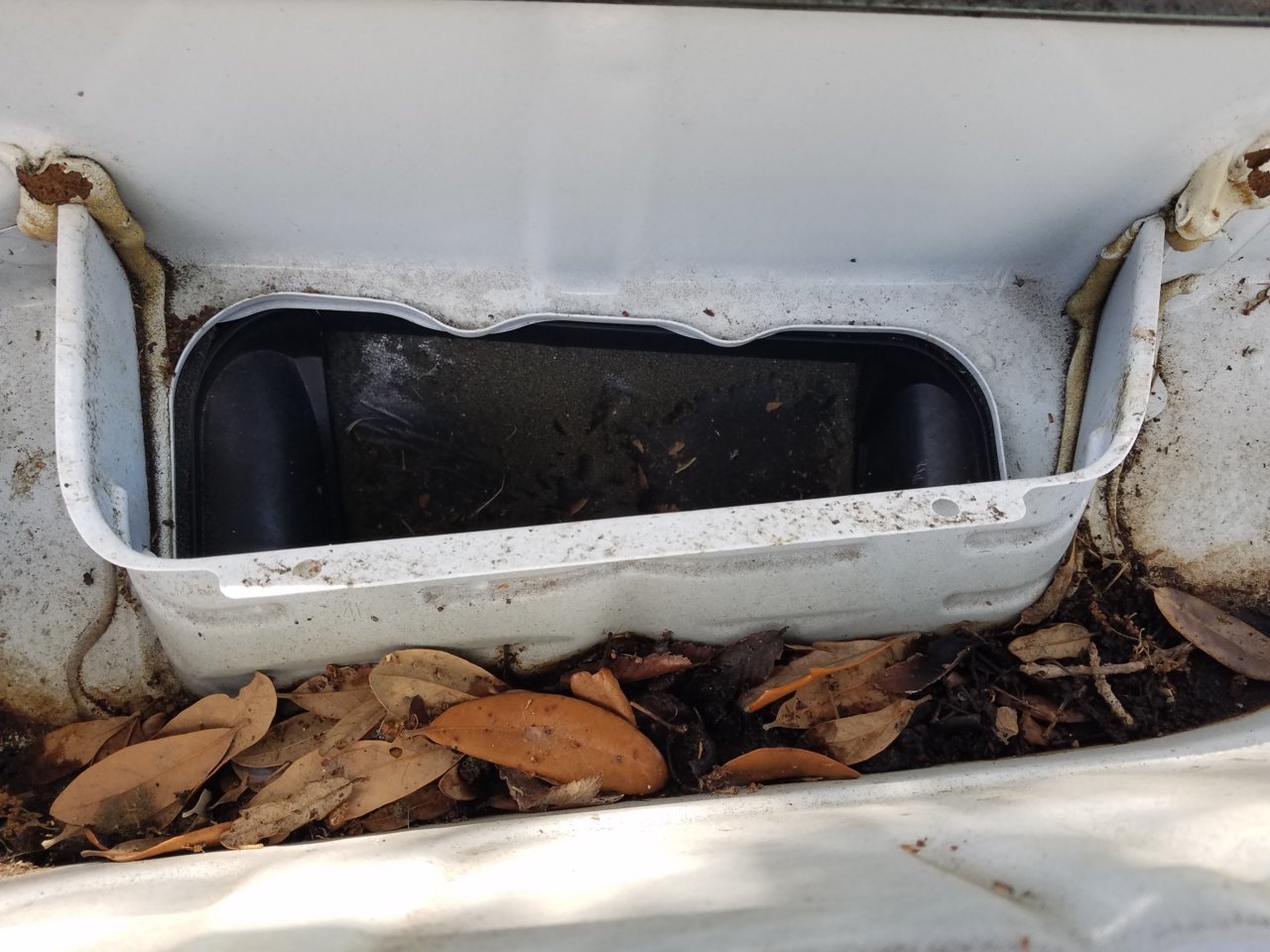

    Apparently I should clean out my inner fender drain area more often. :anonymous:
    The other side was almost as bad
    Now the next project will be prevention / reduction by modifying the cowl area.

    I stumbled across a similar stash of pine needles, leaves and muck in the lower fenders. It was just chance that I found it. I saw a few pine needles sticking out while waxing the truck. They must be easy to miss if you don’t know to look there. The detailer at dealer’s used car department clearly missed it a few months earlier.

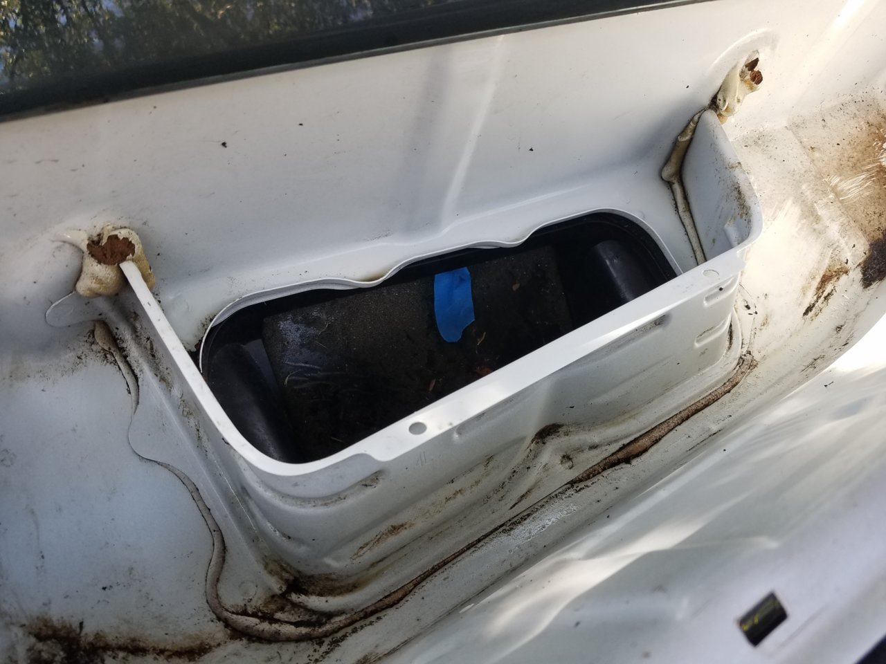

    This is the AC fresh air intake chamber.
    This shows the chamber and the cowl channel drain for the passenger side.
    This is how gooped up the wiper shaft basket gets. Not much to do to prevent that.
    See the blue tape down in the AC fresh air intake? That's for reference. It's on the damper that is in the closed position when running the AC in recirculate. You can see that it has a lousy foam surface. Its one of the sources of foam blowing out your vents that people often wonder about.
    This shot is with recirculate turned off. Now the damper is open for fresh air. You see the trash that gets dumped on the filter. If you wonder how the trash gets in that air intake chamber, since it's covered with the cowl cover and doesn't get water, its from the turbulance of air in the cowl chamber when driving the vehicle. It's also your entry point for vermin that folks sometimes find in the AC. They have climbed up the fender drains into the cowl chamber, then over into the air intake. We're gonna fix that.

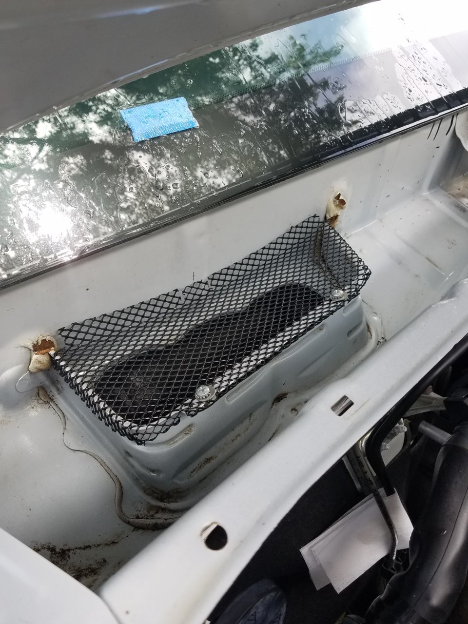

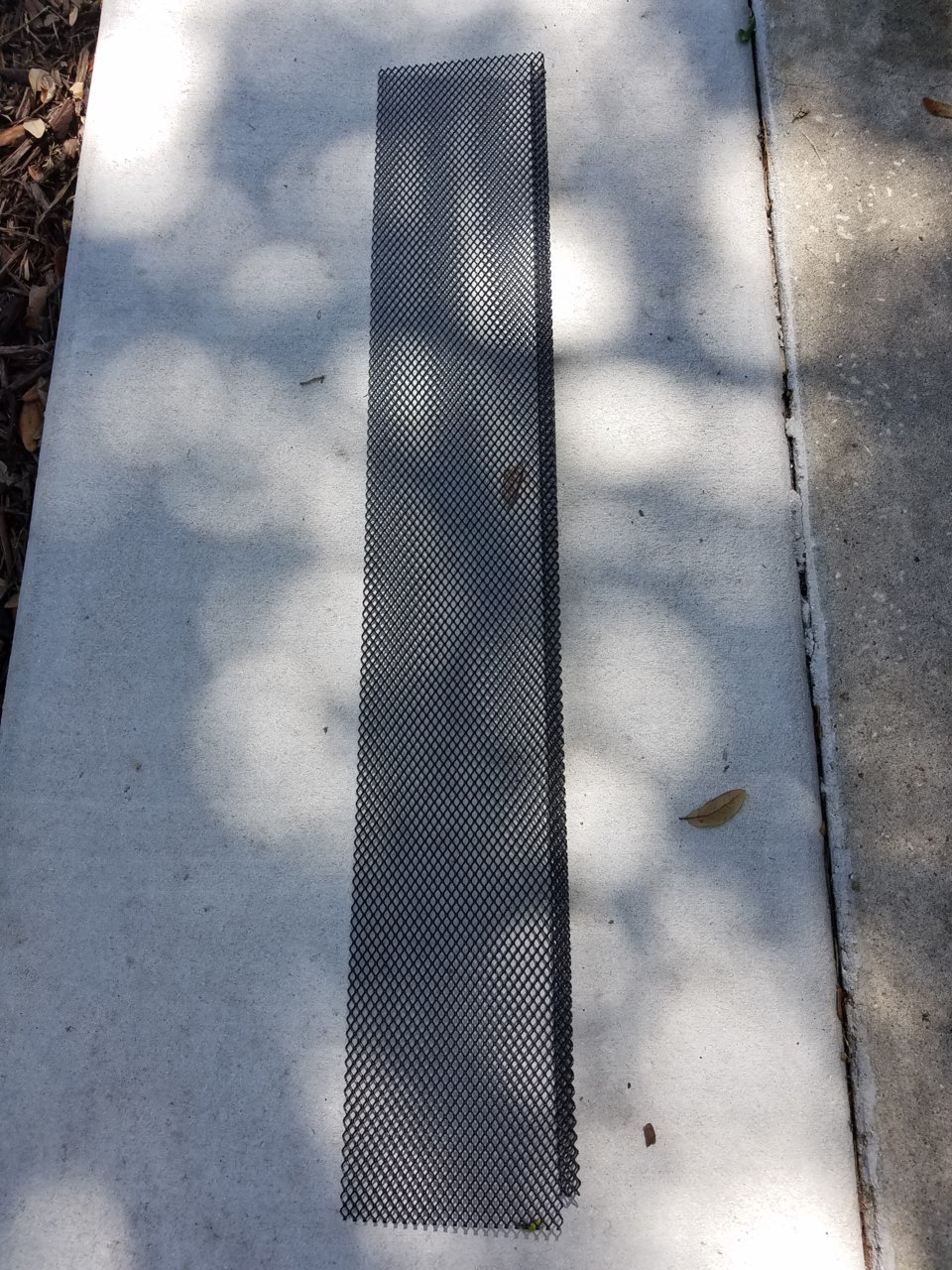

    This is rain gutter screen. Metal, poweder coated. ~$3 at Home Depot
    After spending some time carefully fitting, cutting, snipping and painting the raw edges

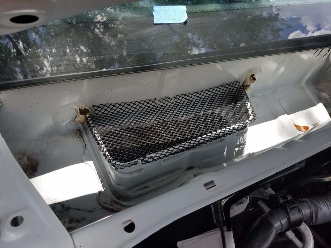

    Mounted using 2 holes already in the leading edge of the box. As mentioned, several others have done similar. Now the AC intake is protected from much of the larger debris getting in, as well as any vermin. I did not try to screen the drains on either end of the cowl chamber as some have, as I didn't want any risk of blockage of debris or water that needs to flow out the drains. If something crawls up the drain, they have no where to go but in the chamber or down the drains; no cab access now.
    Blue tape you see on glass was my mark of wiper position prior to removal, so no need to dink with it on reinstall.

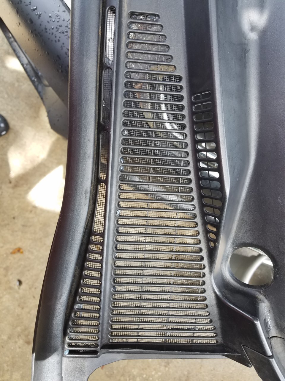

    Here's the part that might be a bit different than others. The main entry for debris into the cowl chamber is via the horizontal slots in the cowl cover. There are vertical slots in some places, but not as much gets through there. So on the back side of the cover I hot glued fiberglass screen.
    The end result should be less debris in the cowl chamber, less debris in the fender drains, lots less debris in the AC air intake and no vermin in the AC system.
