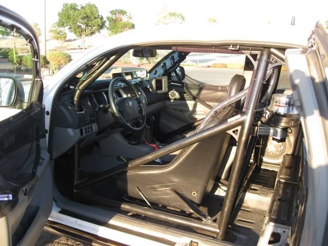

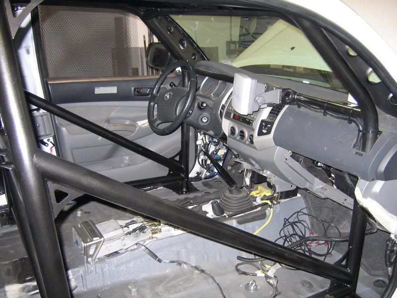

    I noticed in some of your other cages you bend the A pillar tube around the dash, have you considered running it through the A/C vents? (like MJP2)

    I have considered it. Doing that is a very involved process that is a customer service nightmare. Not something I'm interested in getting involved with because of the install headaches. The last thing I want to deal with is someone who drilled a 2 inch hole in their dash in the wrong spot.

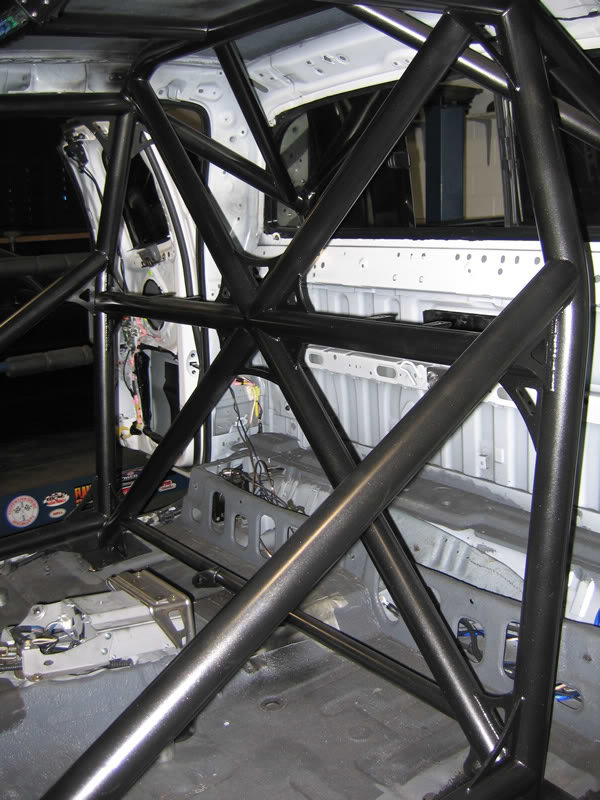

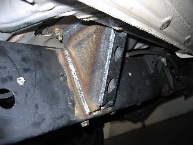

    I'm running a 12 point cage made from 2" .120 chromoly tied into the A pillars and the frame. In areas where it passes through the floorpan, the pan itself is sandwiched between steel plates bolted together. The bottom plates tie into the frame like so:
    The rear supports pass through the rear glass, which has been replaced with lexan. I wanted to keep the rear slider functional. :)
    Regarding interior, it's all there except for the main sound deadening components. The headliner and carpet were removed prior to installing the cage have not been reinstalled. The metal has been coated with bedliner to provide at least a little sound deadening while protecting the metal.
    The cage does not make contact with the sheetmetal in any spots.
