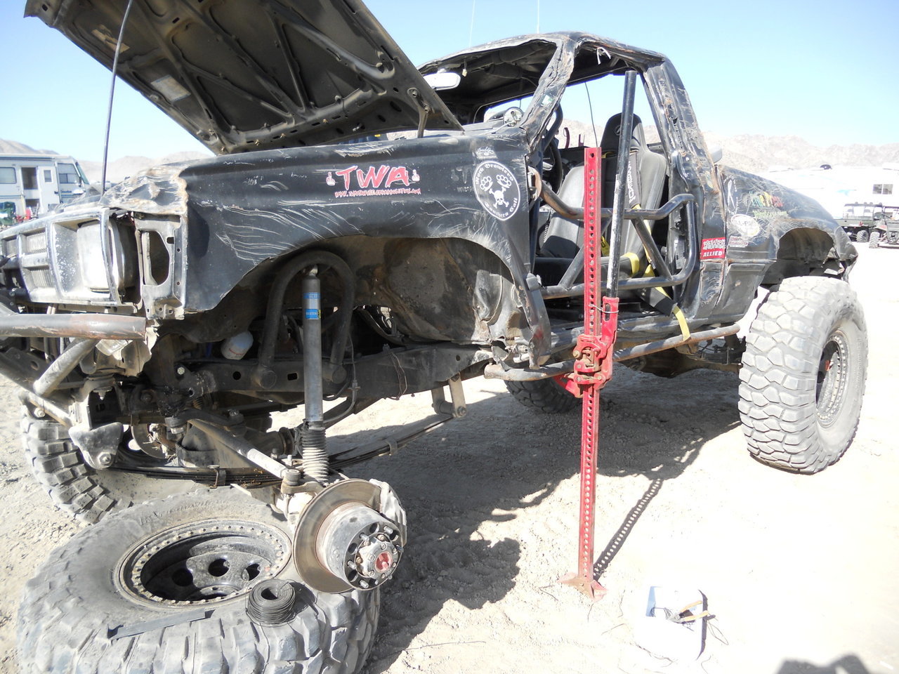

    Do you have a picture of where it currently lands, so that I could figure out whether or not I can cut the stock dash to accommodate the tube?
    My intent is to add a dash bar, harness bar, and some triangulation of the B pillar and ceiling tubes.
  20. Oct 19, 2013 at 7:56 AM
    #100
    traxman25
    traxman25 [OP] 4x Innovations Vendor
    Oct 15, 2009
    #24343
    493
    Adam
    Platteville Wi
    Too Many!
    Here's a couple. Just quickly looking at it in my rig it looks like the pillars would be just a little farther forward than the air duct opening. Maybe by about half a tube diameter.
