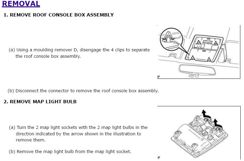

    I have seen the tape trick on YouTube and have also been told to pull the entire piece off the ceiling and remove the bulbs from the back. Not sure which way I will go at this point.
    I will disconnect the negative from the battery.

    I highly recommend the VLEDS interior lighting kit over any other brand. Their end fire plate lights and their VTAIL tail lamp conversion are very good also. Pull the roof console down to change the bulbs. Easier than pulling the covers and jacking around with tape to yank the bulbs out.
    I’ve never had anything but issues with diode dynamics trash, same for cheap Amazon and eBay garbage. I’d stick to better brands.
