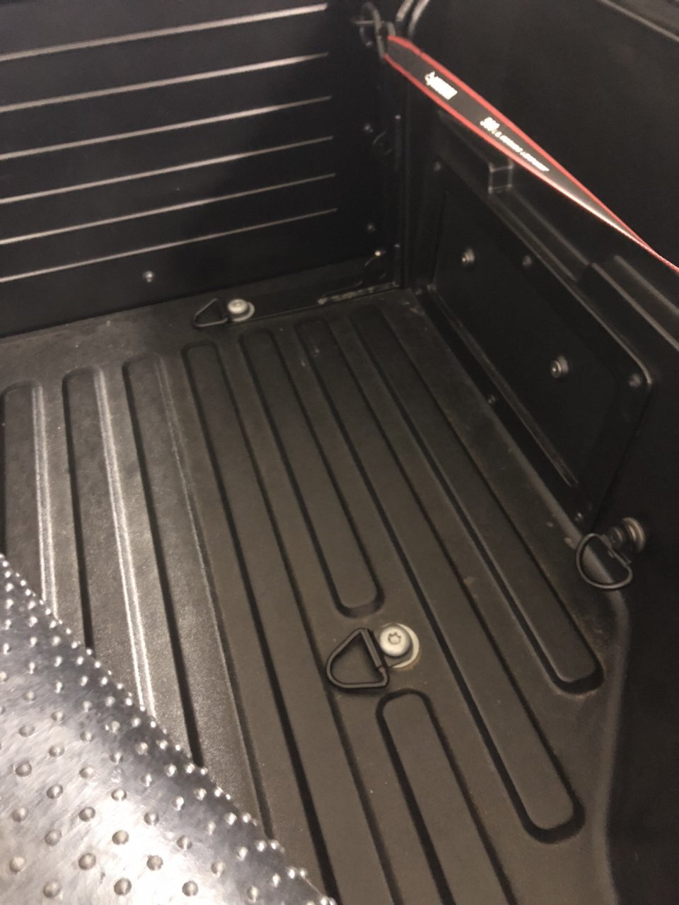

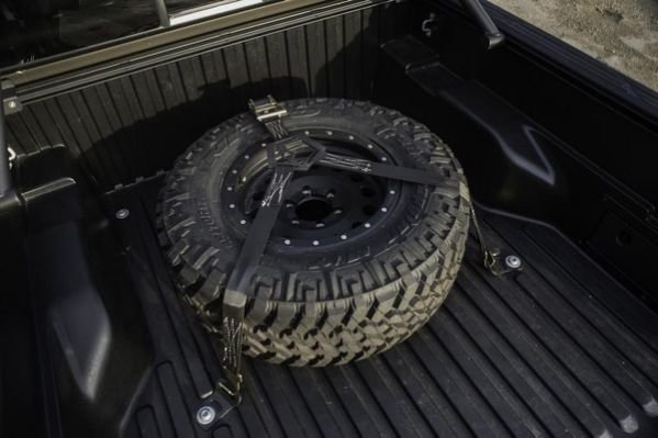

    Does this attach to the floor of the bed? If so, it’s a waste and you’re not going to be able to use a bed mat.
    Why not put $2 D rings in the bed bolts and secure the spare down with ratchet straps?
    No drilling required and a lot less money. Plus, you have your bed available with just taking the tire and straps out.
    The above picture isn’t the exact d rings or strap, but it’s cheap to do.

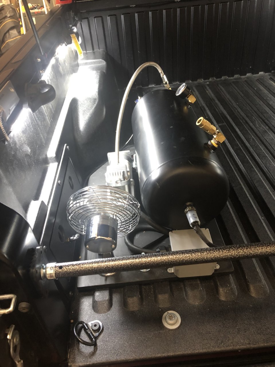

    I drilled to mount the air for tires and horns. No problem that I can see

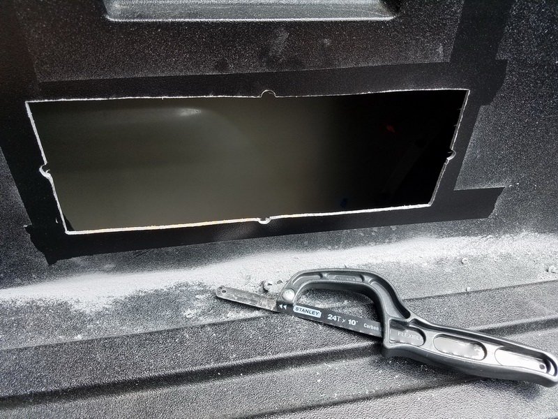

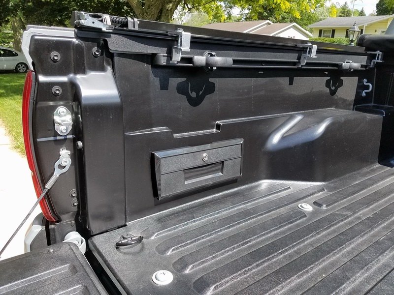

    I did plenty of cutting and drilling when I installed a driver's side storage box (taken away on the 2019s). It's like a fiberglass compound. Cuts and drills nicely.
