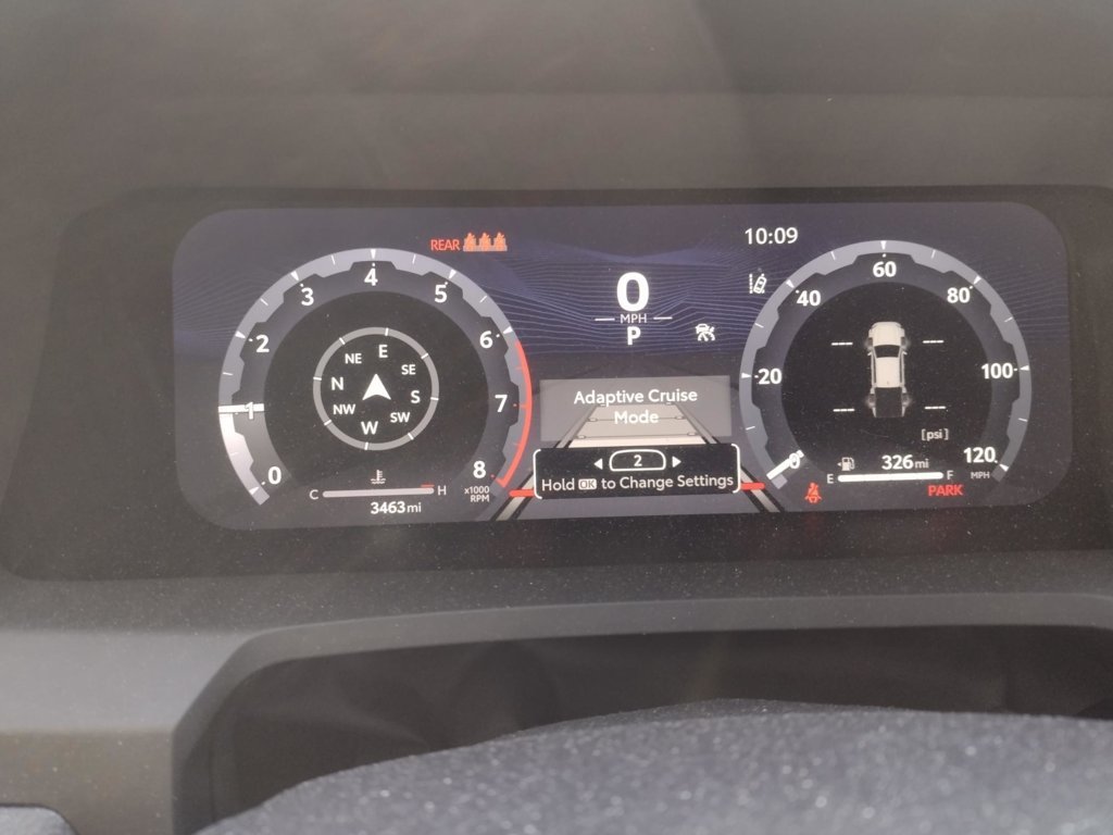

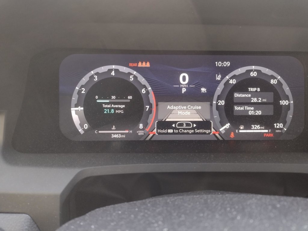

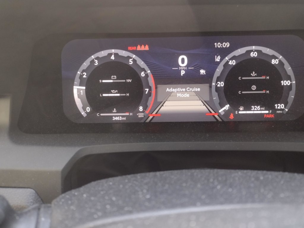

    If someone who experiences this wants to try setting up to match mine, here are the 3 pages in order.

    So I have my tpms on the second screen like you. First screen is compass and boost where I always leave it. 3rd is my l per 100km. My second screen tpms changes to a trip like your 3rd screen every 4-6 times I switch to look at the pressures

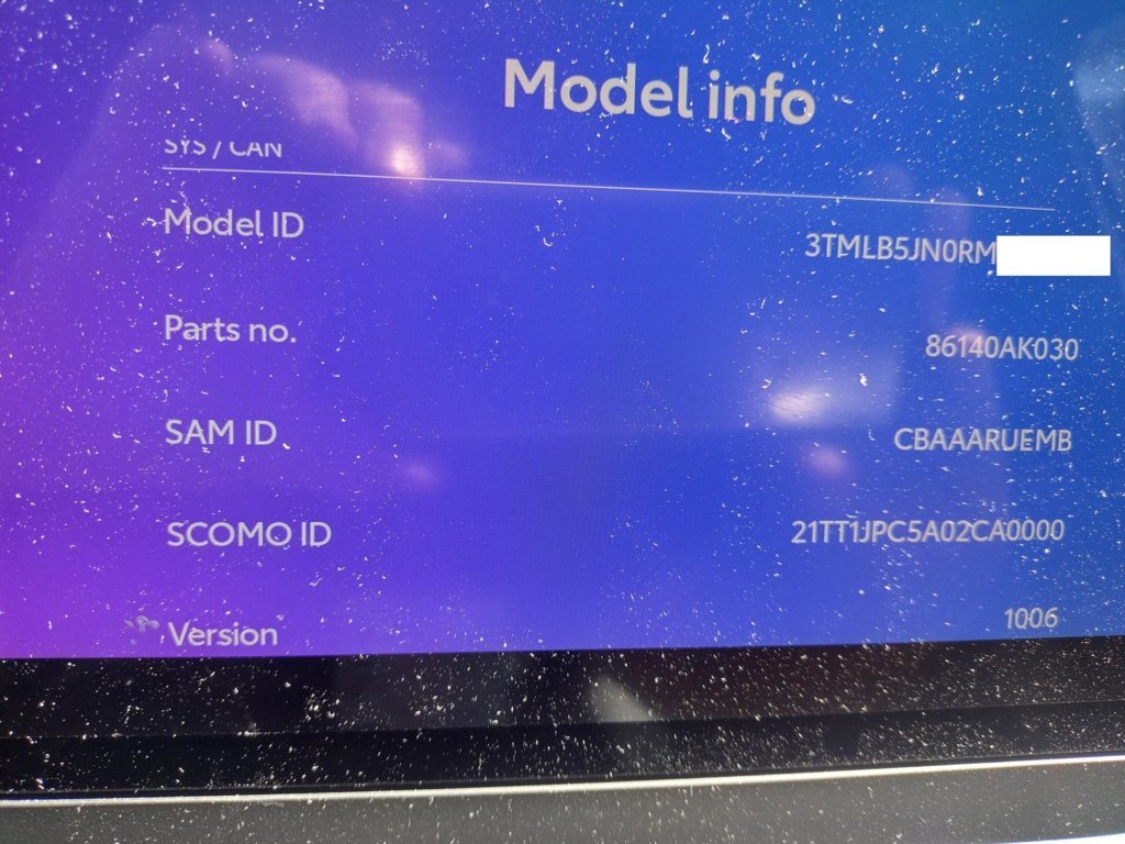

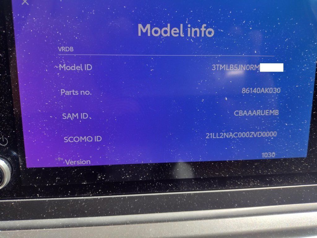

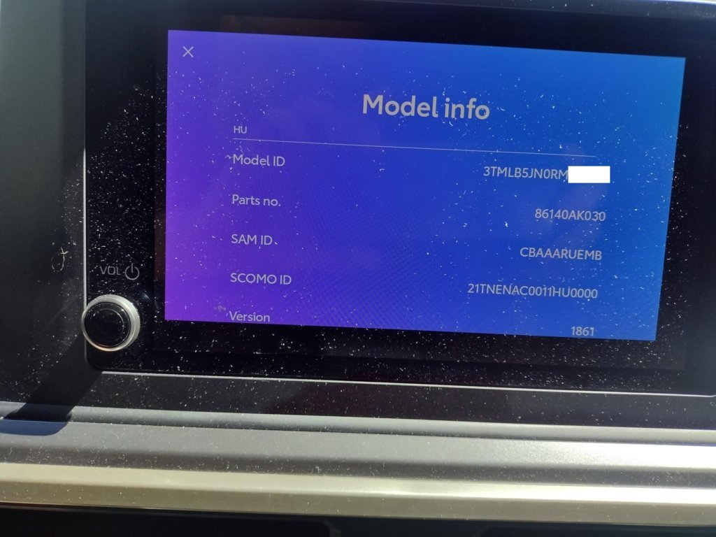

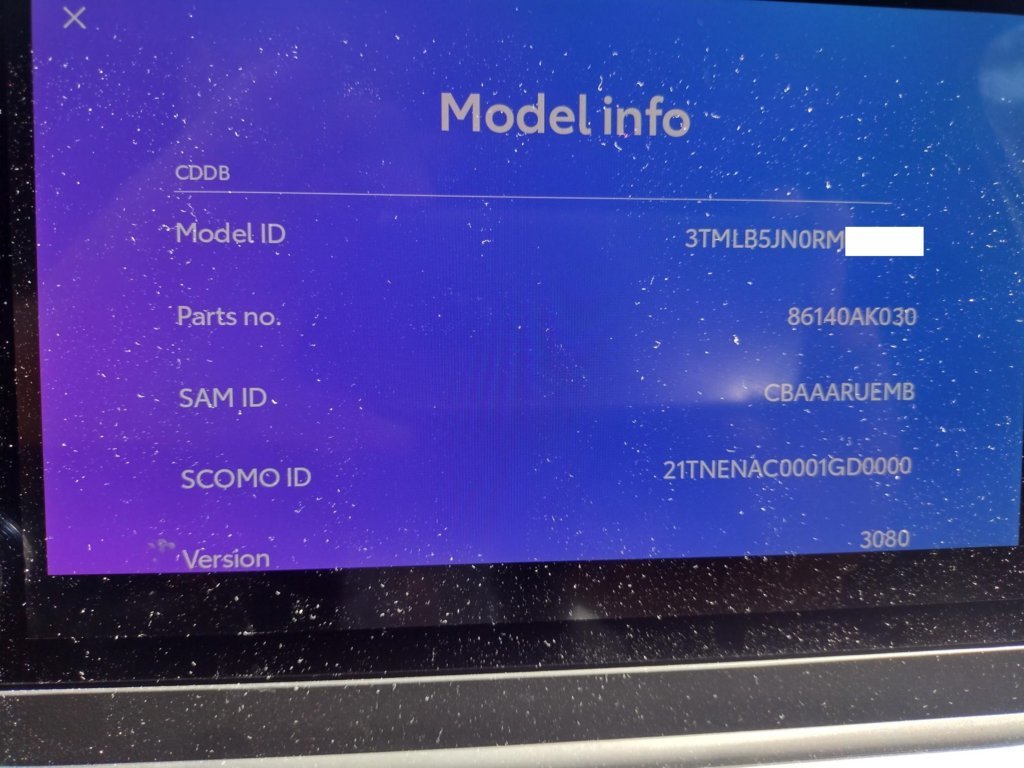

    Only thing I can suggest would be to set up exactly like mine and see if that makes a difference. I'll go get some shots of the software versions but I'm not sure which one would apply to this.

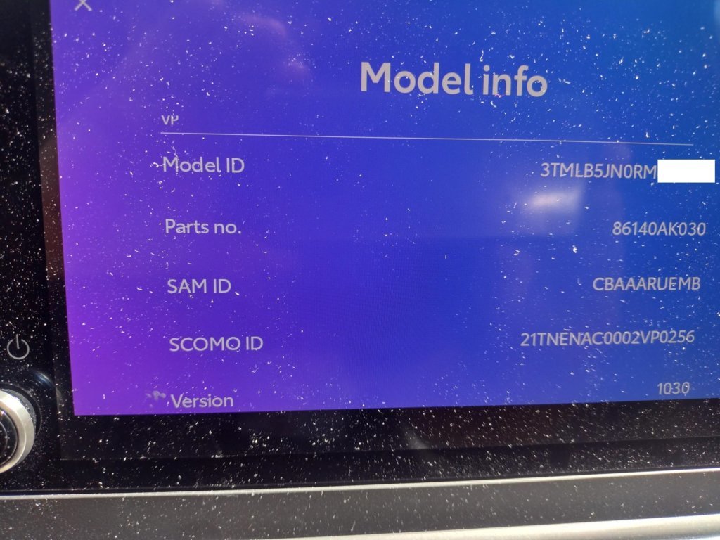

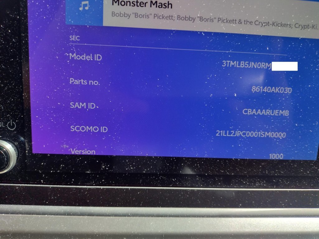

  19. Sep 27, 2024 at 12:04 PM
    #19
    snickers
    snickers My new, overpriced heaping pile of shit
    Nov 22, 2017
    #236679
    2,215
    2024 Tacoma Tailhunter 5ft bed Bronze Oxide
    I am one of those with a disappearing TPMS. All versions match yours. Only differing numbers are VIN and SAM ID. You are the one w/o the problem, right?
