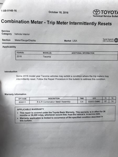

    Well. Guess what. Toyota has put a TSB for this. T-SB-0148-16. Released on October 18, 2016

    My service manager just gave me copy

    T-SB-0148-16 has been issued (18 Oct. 2016) and my '16 goes in for corrective surgery this coming week.
