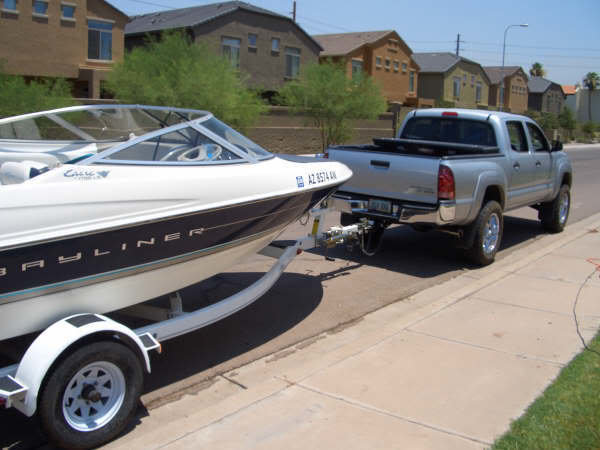

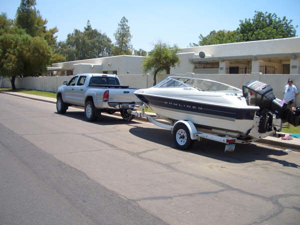

    chris4x4 With sufficient thrust, pigs fly just fine. Moderator
    May 8, 2008
    #6497
    112,751,538
    FlimFlubberJAM
    Tenoe, AZ
    2019 Rubicon 4 Door,
    4.10 gears, sliders, and lots of buttons.
    OME/Total Chaos here:
    Rides great, and tows just fine :D

    SamSter0077
    SamSter0077 [OP] Happy Camper
    Aug 7, 2008
    #8396
    1,702
    Katy, TX
    09 Tacoma 4x4 TRD OR
    OME 886 Coils, and Struts, Rear Toytec TSB AAL/ OME shock absorbers, Fog Lamp anytime mod, Voyager Brake Controller.
    LOOKS SWEET! What size tires? Call me crazy, but I want to keep the stock rims and just buy bigger tires.. 3" looks good to me. I can still Tow my Camper, and look cool. Total Chaos? ok, maybe I am clueless.. is that a kit or something?

  8. Aug 29, 2008 at 7:56 AM
    chris4x4
    May 8, 2008
    #6497
    112,751,538
    FlimFlubberJAM
    Tenoe, AZ
    Total Chaos Upper Control Arms. Gives a bit more travle, clearance, Added caster, and a stronger ball joint. Im running 285/60/18's right now. If you are gonna run stock rims you can get a 265/75/16 with out rubbing. ANy wider on the factory wheels, and I think your gonna rub your Upper Control Arms. :)
