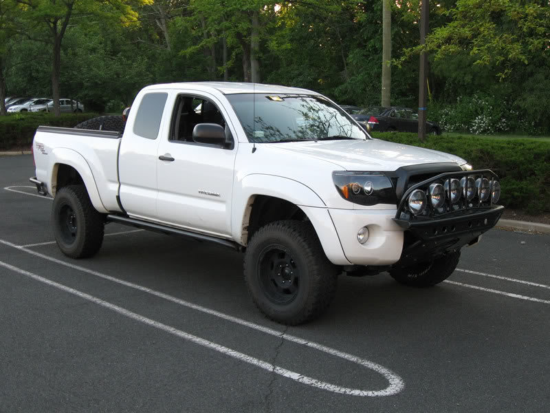

    Scaffolding and a painted grill
    With the AllPro 3" leaf springs. Tires measure around 31.5" tall.
    My latest setup:

    Dude, what leaf pack is that? Do you have enough lights to drive at night? :)
    Nice pic's, thanks!

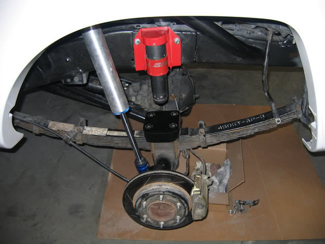

    It's the All Pro 3" pack. The shock mounts and Light Racing jounce shocks are more custom, obviously. :p
    As for the lights, well, it gets pretty dark at night here in NJ. ;)

    So it's all-pro 3" leafs with Bilstein shocks?
    sorry to keep asking, when I looked at the kits for All-pro, the mention two Shock companies I am not familiar with.

    I was running Walker Evans reservoir shocks and they worked really well. I had interference issues with the rear disc brake conversion so I had to redesign and am now running Fox 2.5" reservoir shocks in a custom configuration out back.
    Fox is well known and established as making very high quality products, and All Pro worked out a deal with them for a custom shock specific to the new Tacoma rears. I believe All Pro is the only company carrying these as they were made to their specs.
    Like I said -- I was happy with the W/E product but I only used them a limited amount. I've heard they have corrosion issues over time, whereas the Fox shocks should last indefinitely and can be rebuilt if need be.
