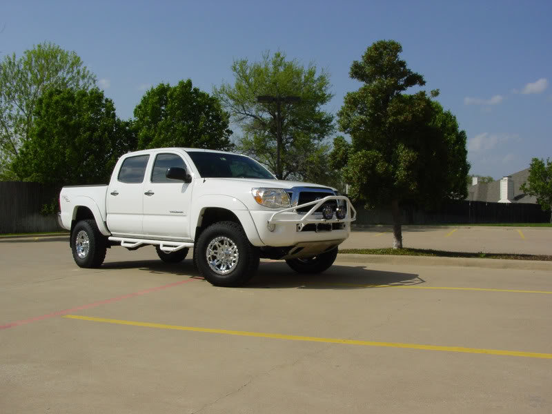

    If you save the picture you see this as the pic name "3inTuffCountry-285-75-16" Thought this might help you out.

    Yeah, I noticed that.. and the TRD shocks.. it just didn't look lifted to me, maybe it's the tire size. Either way, I settled on 5100's.. Maybe Santa Claus will leave them under the tree..

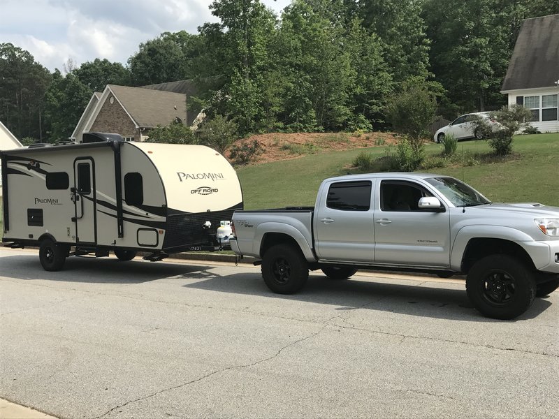

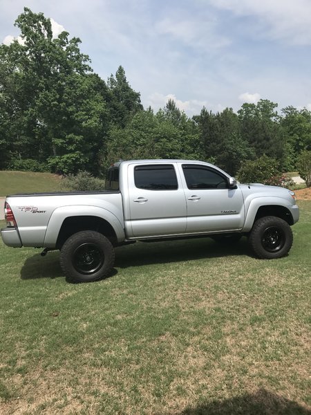

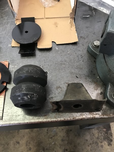

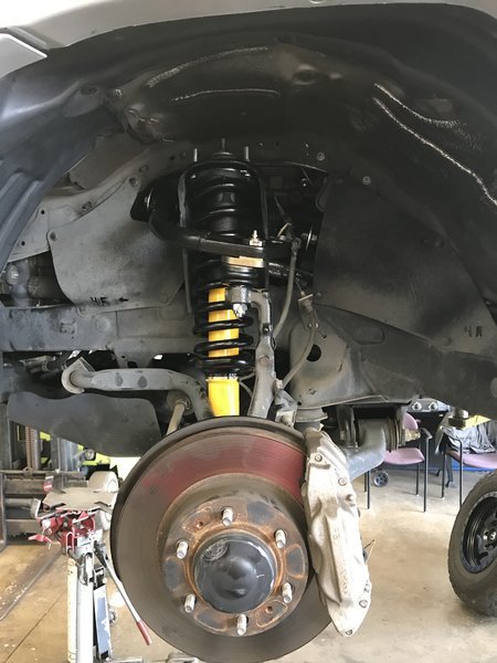

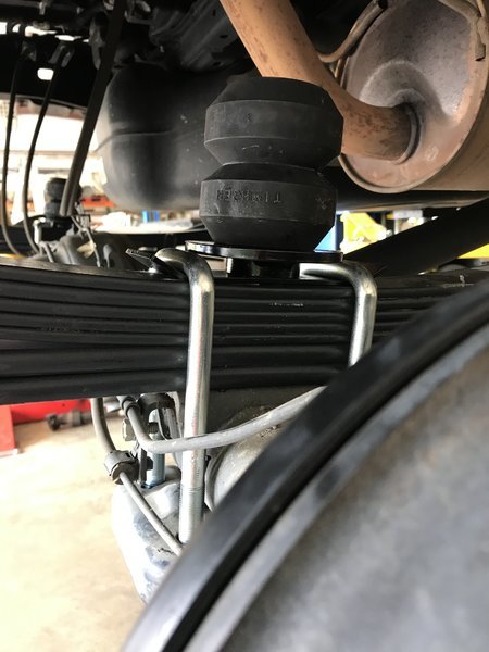

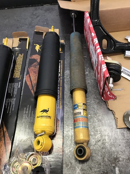

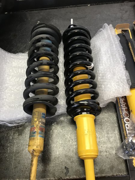

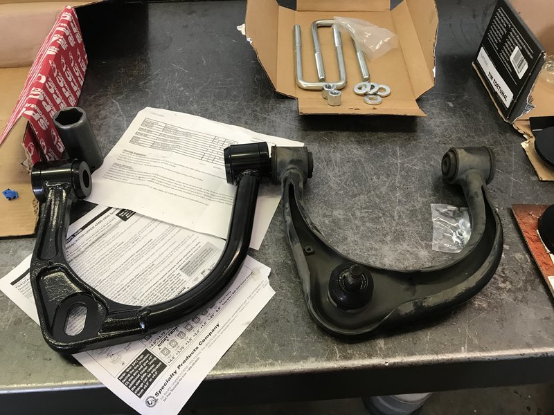

    Here's a couple of pics of the long awaited upgrade to my truck. It's a 3" OME with Dakkar 2.75 leaf pack and Timbren spring system along with Light Racing UCA'S. After endless hours of reading this forum and research I called ARB and they directed me to Wheelers Off Road where Taco Dan led me to this setup that works amazing for my application. I hope these pictures help in some of your decision making. I'm towing a 2016 Palomino Palomini 177bh with off-road package. 2800 lb. dry weight and 3500 lbs fully loaded and ready to camp. I have just over 400 lbs of tounge weight due to upgraded queen size mattress. I wanted the nice look of the lift kit but my ultimate goal was efficiency in towing and to eliminate rear sag.

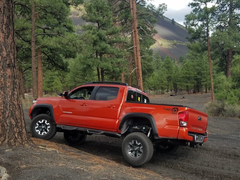

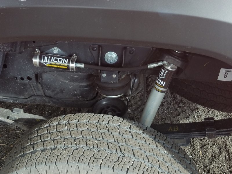

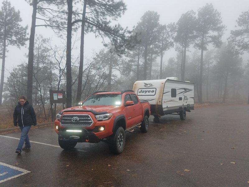

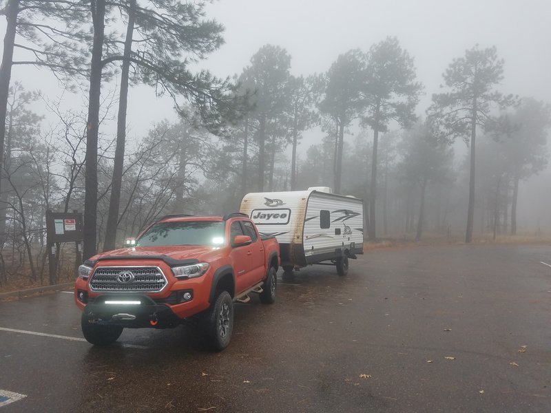

    Your setup looks great! What size tires are you running? I lifted mine 3"s a year ago and added firestone bags and daystar cradles. I'm still on stock rubber (265 70r16) and am curious how much a larger tire will affect towing performance. As of now Im thinking of just keeping it a little more practical with a 265 75r16MT. I'd love to run 255 85s or 285 75s but I think the larger rubber and travel trailer will be a bit too much for the V6.

    That's a super nice setup you have there. I'm running 265/70 17 BFG KO2 . I've had them on for 33k miles now and they are still at 10-11 on the depth chart . These tires will not wear out . I'm probably going to go with a 285/70 17 next just to fill the wheel well a little more but I'll definitely be staying with the KO2s . I'm very pleased with them . I'm not sure about how it's going to effect my towing yet because I just had the lift installed yesterday. We have a trip coming up soon and I'll have a better idea then . What's the weight of your Jayco ?
