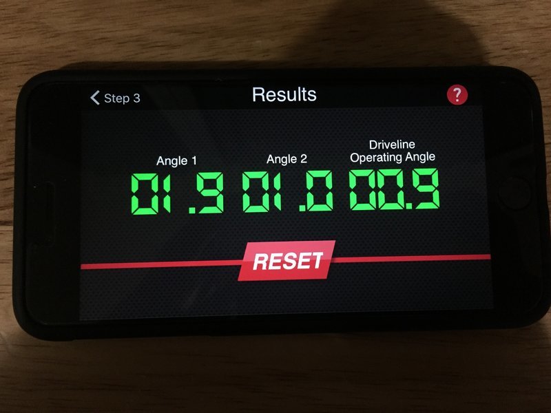

    Tried it. Looks like I pass :thumbsup:
    Setup: toytec springs/5100s set at .85 for 2.5" lift. 1.5" AAL in the rear. TC UCAs and street tacos carrier bearing drop. 3 degree shims. No vibes.

    Hi do you have any info on the carrier bearing drop you used I have almost same set up but used OME carrier bearing drop and still have slight vibe also I have deaver 1.5-2 add a leaf
