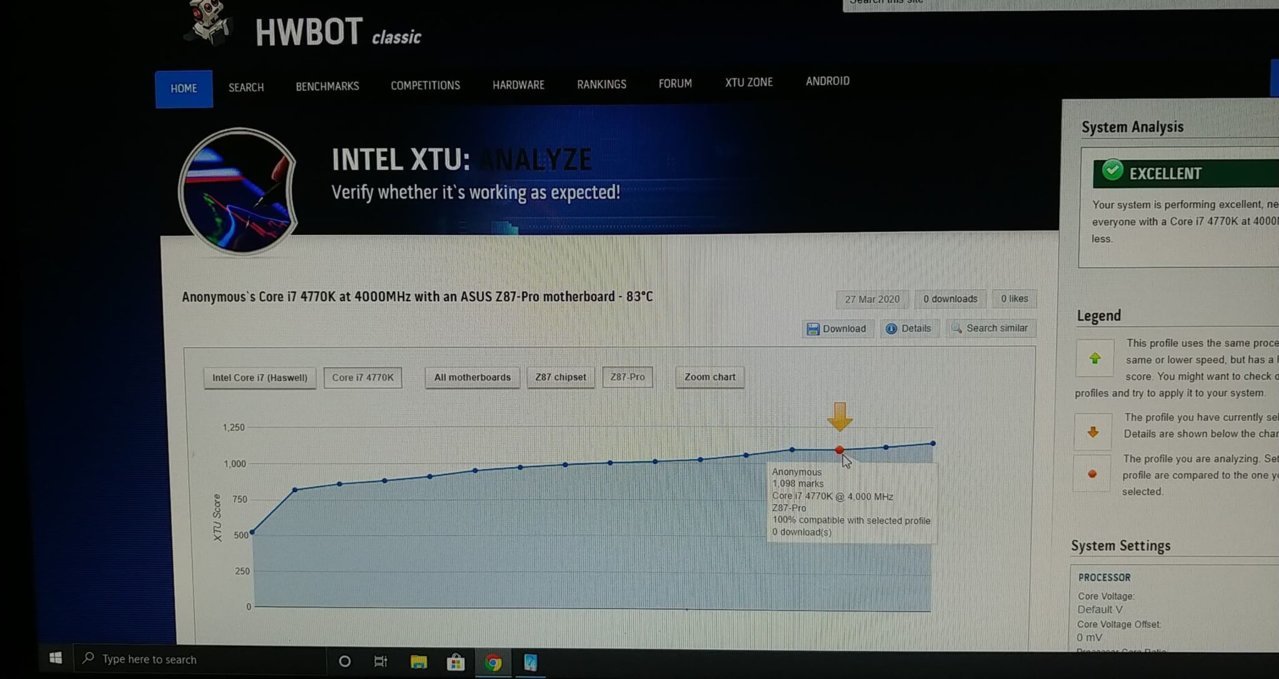

    alright fellas. Looking for advice. I'm a pretty much a novice when it comes to computers.
    I bought my rig used:
    Asus Z87 pro, i7 4770k slightly over clocked @ 4ghz, and Corsair H55 water cooled
    GTX1070
    16 gb ram
    I'm noticing that newer games won't maintain 60 fps on ultra settings, Far Cry New Dawn especially, it can drop as low as the 20's for a hot second. My understanding is that my mobo/cpu/cooler are all old generation and all 3 will need upgraded at once. I don't have any spare parts or socket adapters or whatever for the mobo or cooler.
    I did some benchmark a while ago and it said my i7 was under-performing compared to others at the same setting. It was at 3.7 core 3.9 cache. I then clocked it to 4.0 on both settings.
    Then I re-ran the benchmark, and it said it was outperforming ones clocked to 4.5-4.7
    90876546_618376582048383_352014772255850_3ed71d113a26ba19f3b1a121cd3d95946c137d38.jpg
    So what should I be budgeting to upgrade in the future? Is the mobo/cpu/cooler just fine for a while to come? Or should I look at replacing those when I do a graphic card upgrade in a few months? I'm guessing my graphics card is the weak link in my set up. There's also a strong possibility I get into VR if that makes any difference in the upgrade route I should go.

    What resolution is your monitor? What refresh rate? What is your target/desired frame rate on each game?
    Every game has slightly different requirements. I recommend first looking at what resolution/framerate you want in the games you play at and then look into the hardware you need to pull that off.
    The 4770K is definitely long in the tooth but can handle it's own in 1080P on non CPU intensive games. Far Cry is CPU intensive though. To compare the "worst" AMD chip right now is the Ryzen 3 3100 and that chip bests it by 10-20% per core. Intel upgrading automatically means a new motherboard in general and everything now uses newer DDR4 ram, so yes you will need to do all three if you want a better CPU. There is no such thing as a socket adapter anymore. I haven't seen something like that since the P1 days.
    AMD is going to likely drop their newest chips in the next few months, so you may want to wait until then if you want to buy once cry once. Alternatively, because AMD often uses the same socket for several generations and we know the next one still uses AM4, you could buy a cheap Ryzen 3 3100 or 5 3600 now and then upgrade to the newer Ryzen 7 4000 series chips once they are available if you need the horses and money isn't a big deal.
    The cooler is probably compatible with newer sockets but I wouldn't run a used AIO in a new system. You're better off getting something newer if you buy Intel or using the stock cooler if you go AMD.
    The 1070 is a very good 1080P card at 60-100fps with new games. Anything past that though and you should look at upgrading.

    Yeah I think if you're budget conscious I'd go with:
    • MSI b450 Tomahawk Max Mobo ($120)
    • AMD r5 3600 CPU ($175)
    • Crucial Ballistix 16GB 3200Mhz DDR4 Ram ($70)
    You'd have a full system upgrade for less than the cost of a new GPU. That'll make it easier to do a GPU upgrade sooner since you're not dumping a ton of money.
    If you're less budget conscious I'd pretty much go with the same as above, but look at the 3700x CPU or anything in tiers above it.
    Still can't recommend Intel in 2020 and don't see them being recommendable for the foreseeable future.

    I was planning to go AMD this time :)
    Monitor is just 1920x1080 144hz

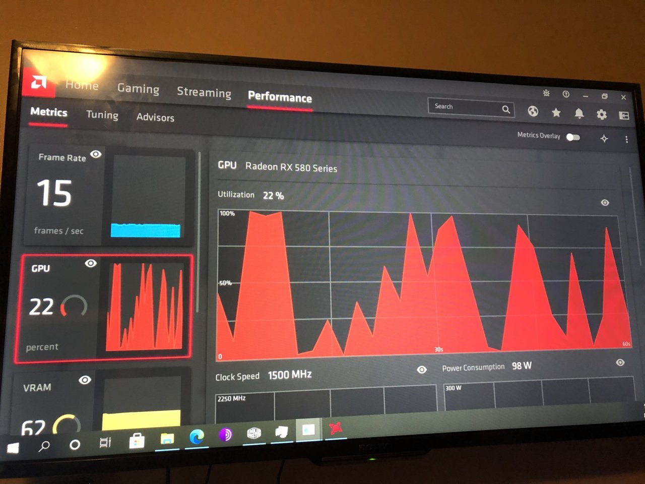

    Well this is interesting, I was playing X-plane tonight and was watching my task manager to see resource allocation and my COU usage was around 20% (using 4 cores of the R5 3600), RAM usage was about 80% (16GB kit), and VRAM usage was about 50%, but the GPU would spike to 100% and throttle down and frame rate stayed rock solid at 15 FPS.
    I thought maybe my drives could keep up with the demand for data but my drives were showing 0% in task manager, could it be a driver issue?
