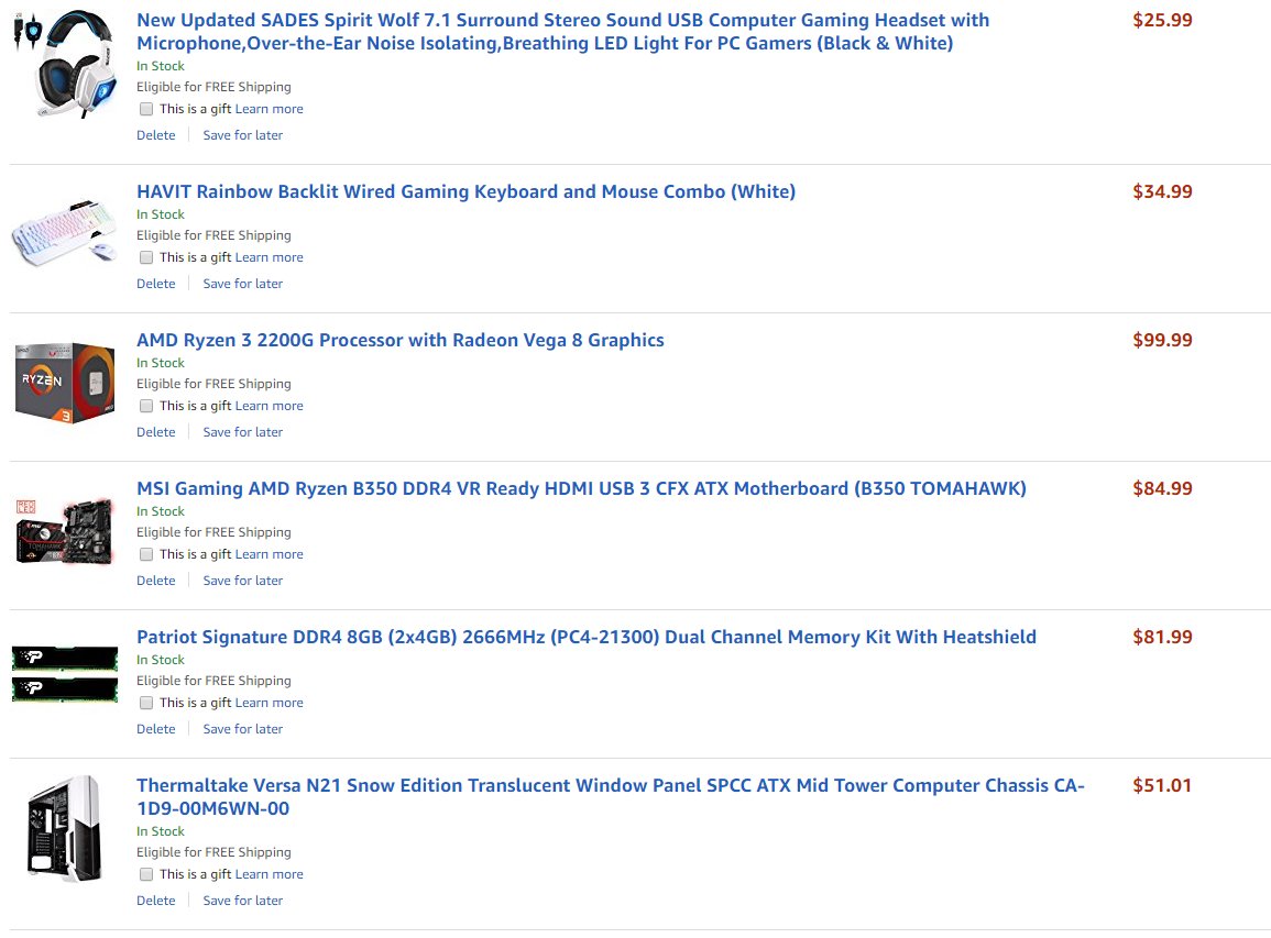

    Here is what I ended up putting together: (keep in mind my focus is budget, I plan on using my current graphics card and psu until I can upgrade later on)

    Ryzen 3 is not a bad choice. I might try to spend the extra $70 on the Ryzen 5 I mentioned though since it has triple the threads and double the cores. That’s going to last a lot longer for gaming at acceptable frame rates and likely pair up better in the future to a new graphics card. If you don’t want to spend that $70 look at a lower end 1st gen Ryzen 5, since that Ryzen 3 you listed has Vega cores that do nothing for you and is limited without hyper threading.
    No worries on disagreeing. There are a lot of ways to get to where he wants to go. I haven’t seen many 400 series boards apart from the X470s and that board is the bargain of the bunch. I’d tell him to get a 300 series board but he’d need a 1st gen Ryzen to update it which I don’t think he’ll be able to find cheap. I picked the 580 because of availability and cost. A 580 can run all day with a 1060 but it can be found on sale for cheaper and even local stores often have 580 stock. The 1070 is a great option, it’s what I run, but they want crazy money for them right now and availability sucks. For PSU 80 Gold is a good recommendation but on a budget anything 80 rated with good review will get him by.
    I totally agree on the Ryzen 7 1700. He needs to go up into at least the Ryzen 5 range IMHO to be future proof for his next graphics card. I wonder, would a Ryzen 2400G without his 770 behind actually be better (ie is Vega 11 better than a 770?) That might be a good option.
    Edit: Nope, I found some comparisons and he’s better off with a non G series Ryzen 5 or 7 with his 770.

    On board graphics are often very basic, so i am not too surprised to see the 770 would be better. I agree bumping up to the ryzen 5 is a good idea for small amount extra. Wait for a sale or even a combo deal and it may be about the same price.
    I didnt realize the older 300 series boards would need an older cpu just to update bios to take a newer one.
