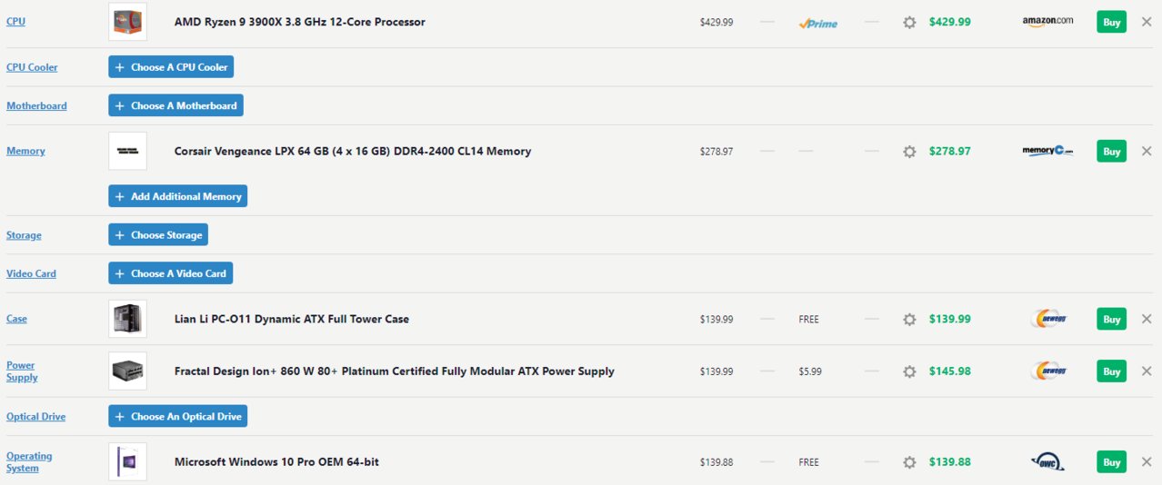

    Wait a couple weeks for zen 3.
    Do you need 64gb of ram? Those sticks are also a bit slow IMO at 2400...though case 14 is good. I'm more of a cas 16, 3200 or 3600 ram guy for amd.
    You can get windows cheaper

    As the others said wait for Zen 3 (AKA The new Ryzen chips being announced on October 8th)
    Why that motherboard? For the parts you're running a B550 board will offer you a better board at that price point. While the Prime isn't a bad motherboard it is pretty basic for a X570 design.
    The Lian Li O11 has lots of room but need lots of fans or else it'll run hot. It's a water cooling case. If you're on air there are possibly better options IMHO. This is coming from someone who does run one lol.
    Get 3200 mhz or higher ram, as @velillen said. I wouldn't over focus on CAS timings necessarily but CAS 16 is better if you can find it. If you can find CAS 18 3600 mhz ram that's pretty much the same thing but slightly faster since frequency > CAS timing with Ryzen 3000 and above.
    The Windows comment is a little vague he made though. Are you going to run any VMs? If not, just get Windows 10 Home. There is nothing Pro really offers anymore that a normal user needs except maybe the ability to run VMs through Windows.

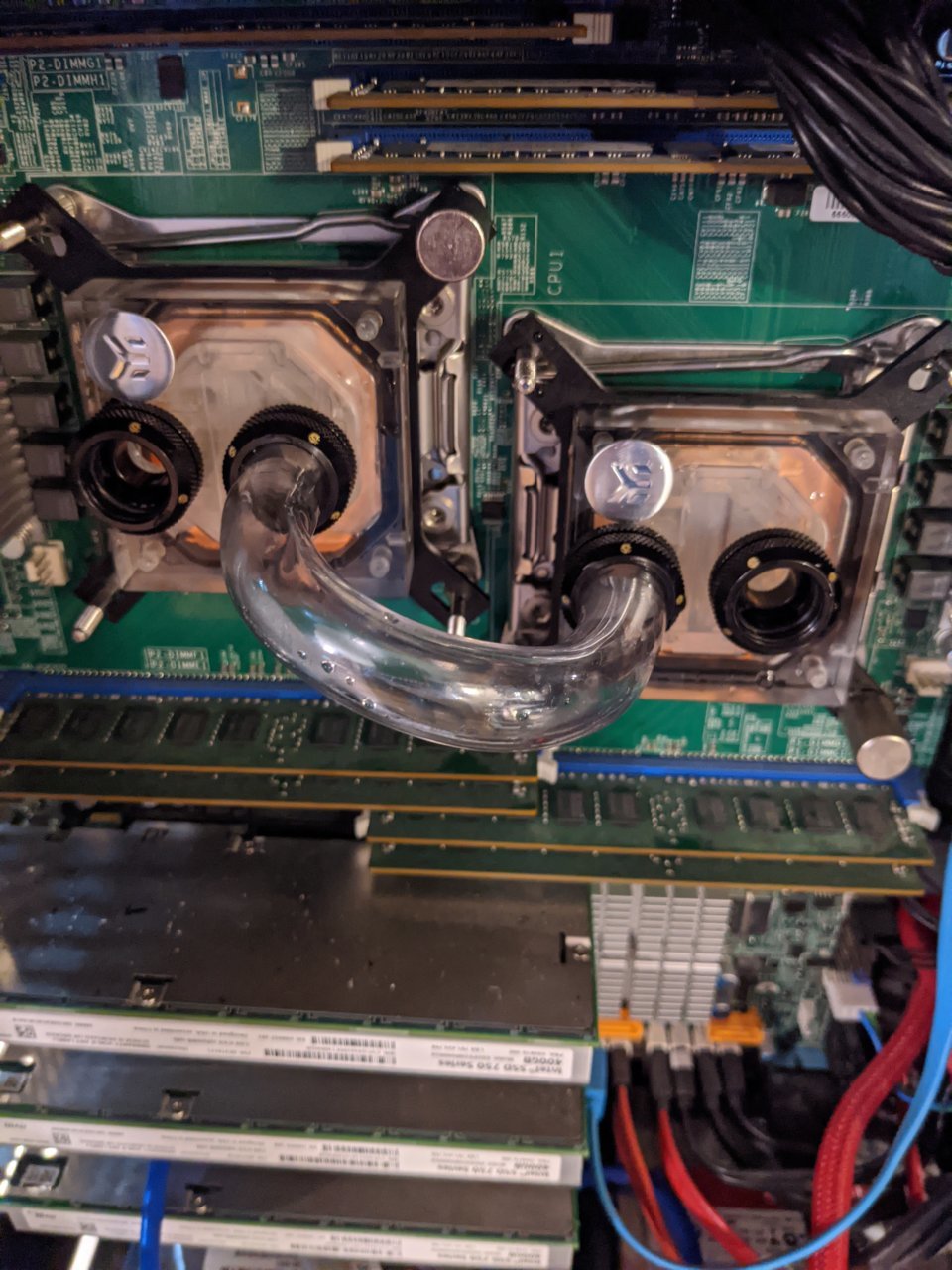

    Jester243 and replica9000 like this.

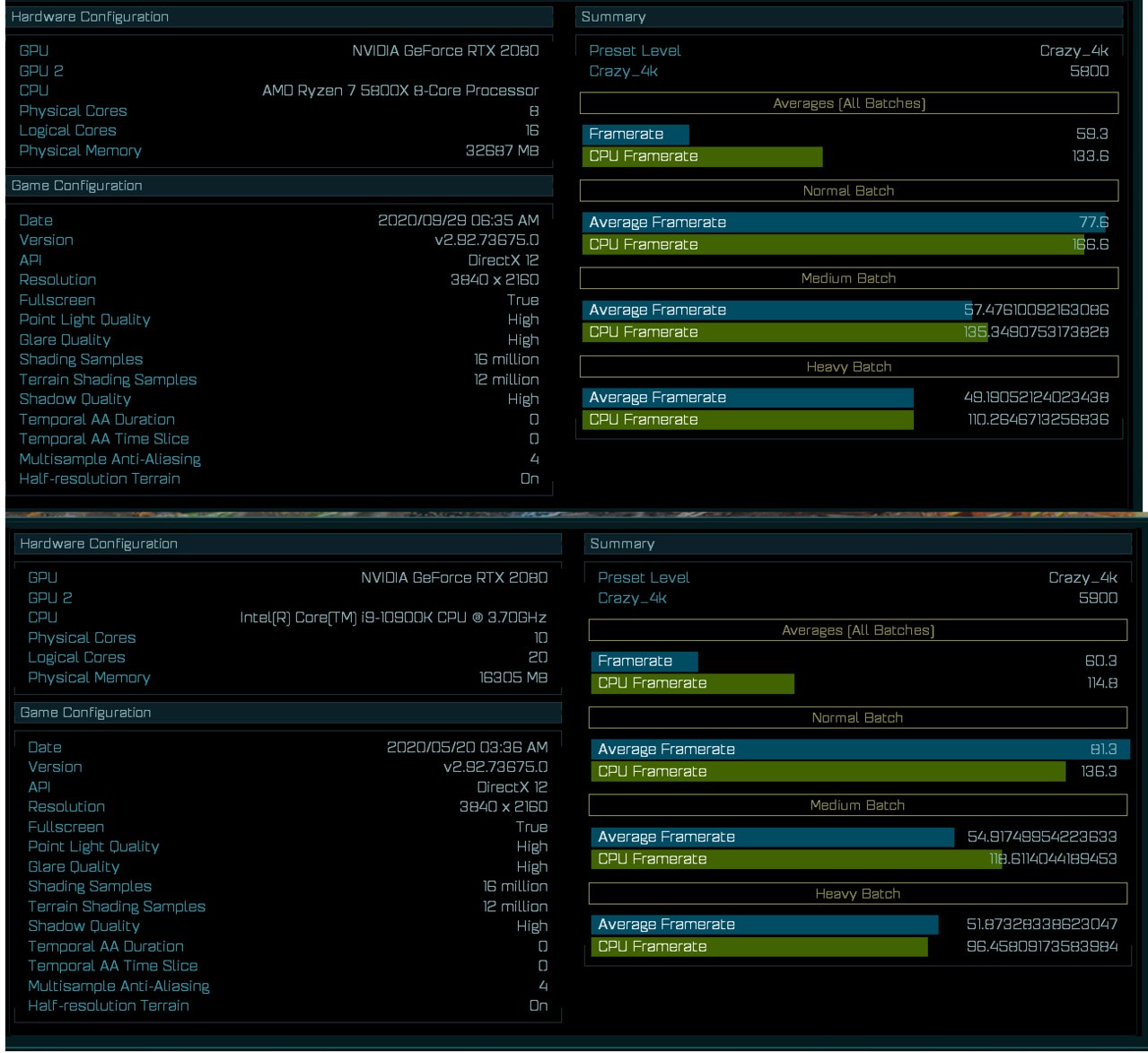

    Assuming this is what your talking about,
    I'm not sure I would call that a "leak". For all we know, this thing was running on LN2. With that out of the way, I have high hopes for it.

    That and a website posted some "leaks" claiming some 10% higher numbers in CS:Go with a 3080 at 1440P over the 10900K that have since been pulled down. I totally agree, no one knows what the conditions were but it is exciting we might see a huge jump on the CPU side to match up with the shiny new GPUs.

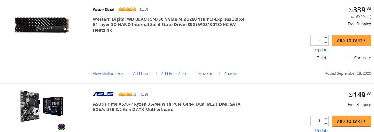

    thoughts on this ram?

    A link would be helpful. I don't want to have to type that whole thing out.

    any good recommendations for a case, i'm not planning on water cooling at this time, preferably fullsize ATX.
