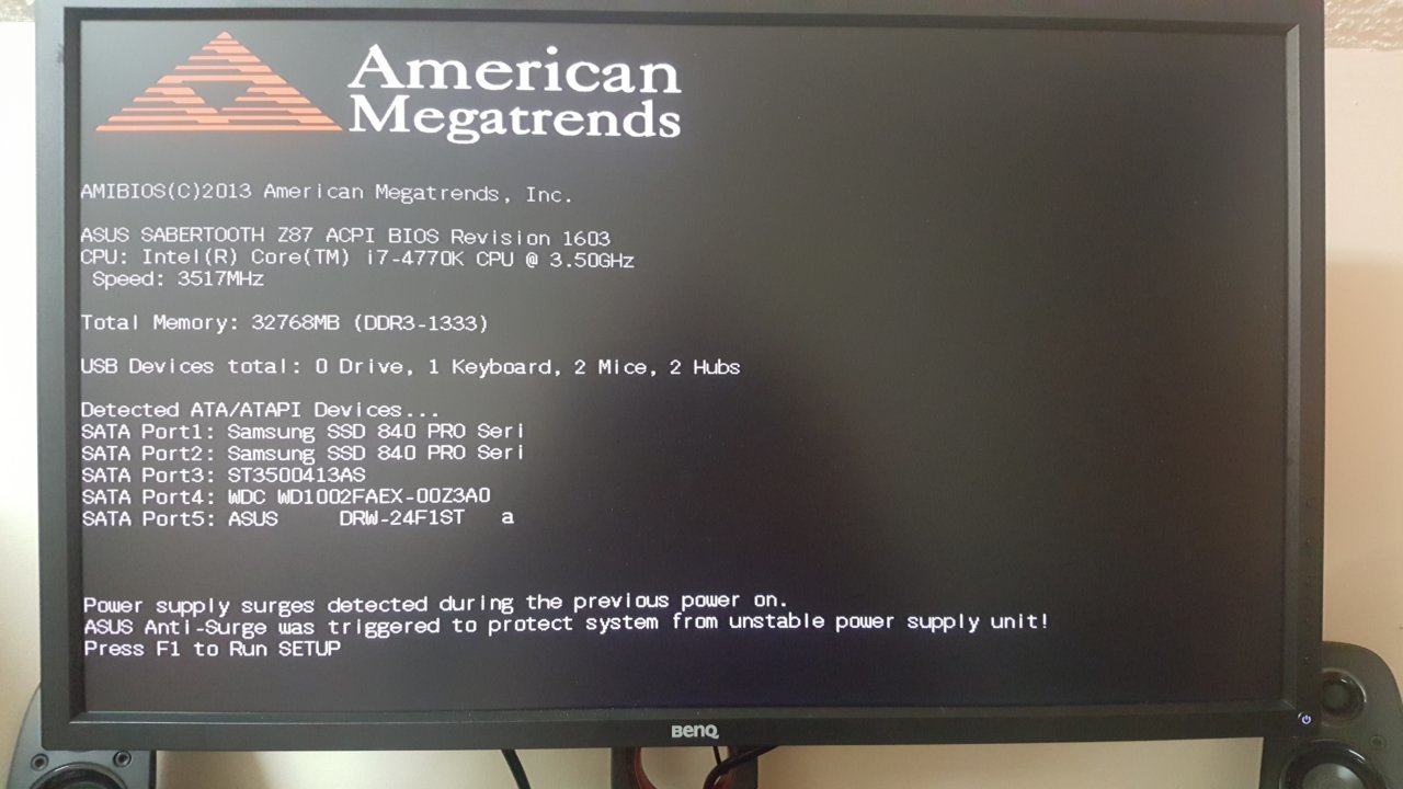

    I'm having some crashing issues lately.
    Sometimes it runs for days with no issues. Today I cant keep it running for 5 mins.
    I have a seasonic 1050 watt power supply that I think might be going bad. its fully modular and has been in for several years.
    So I guess im looking for another power supply.
    I'm running a I7 4770k, and 2 1080's
    Does anyone have a reccomendation on a decent modular power supply?

    Check the warranty. I think that PSU has 5-7 years.

    I'm partial to EVGA power supplies. They seem to be built very well, and EVGA stands behind their products. Also, (and I'm sure other brands have this) it has an ECO setting that only turns on the fan when the power demand requires it.

    Even before seeing the BIOS message my thought went to PSU as the easiest thing to try. After that, it kind of becomes a crap shoot as to which component is going bad, but typically mainboard, graphics, or RAM.
    I've used Corsairs for a bit and been happy, but basically you get what you pay for with PSU's. I don't go cheap there, learned that lesson a long time ago.

    Its alittle over 7 years since the build.

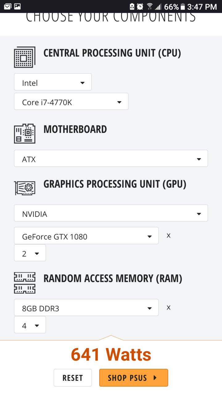

    Would an 850w work for me?

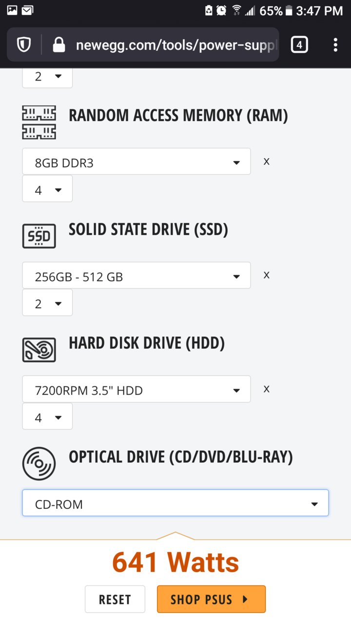

    Probably, I personally like to have a bit of headroom. Looked up your cards and CPU, and that's 525 watts right there, so 850 would give you more than 1.5x that.
    Matic[QUOTED] likes this.

    I would say 850 would still be a good idea. Leaves you room to upgrade to a power hungry CPU and or a power hungry GPU
