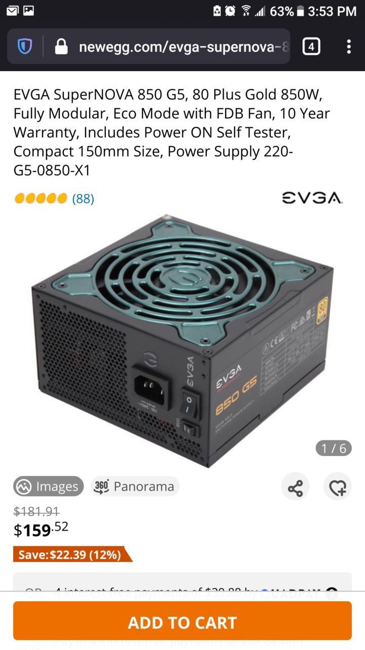

    8fiddy it is.
    Much appreciated everyone.

    corsair rm850x has been a solid work horse for me

    Yeah.
    I just used one of those in my daughter's new 5800X build, that thing is hyoooj! Still waiting for new GPUs to be more available, for now she's just running an old 970 in the new one while she gets stuff moved over. Her old system is a mess. Kind of like her room.

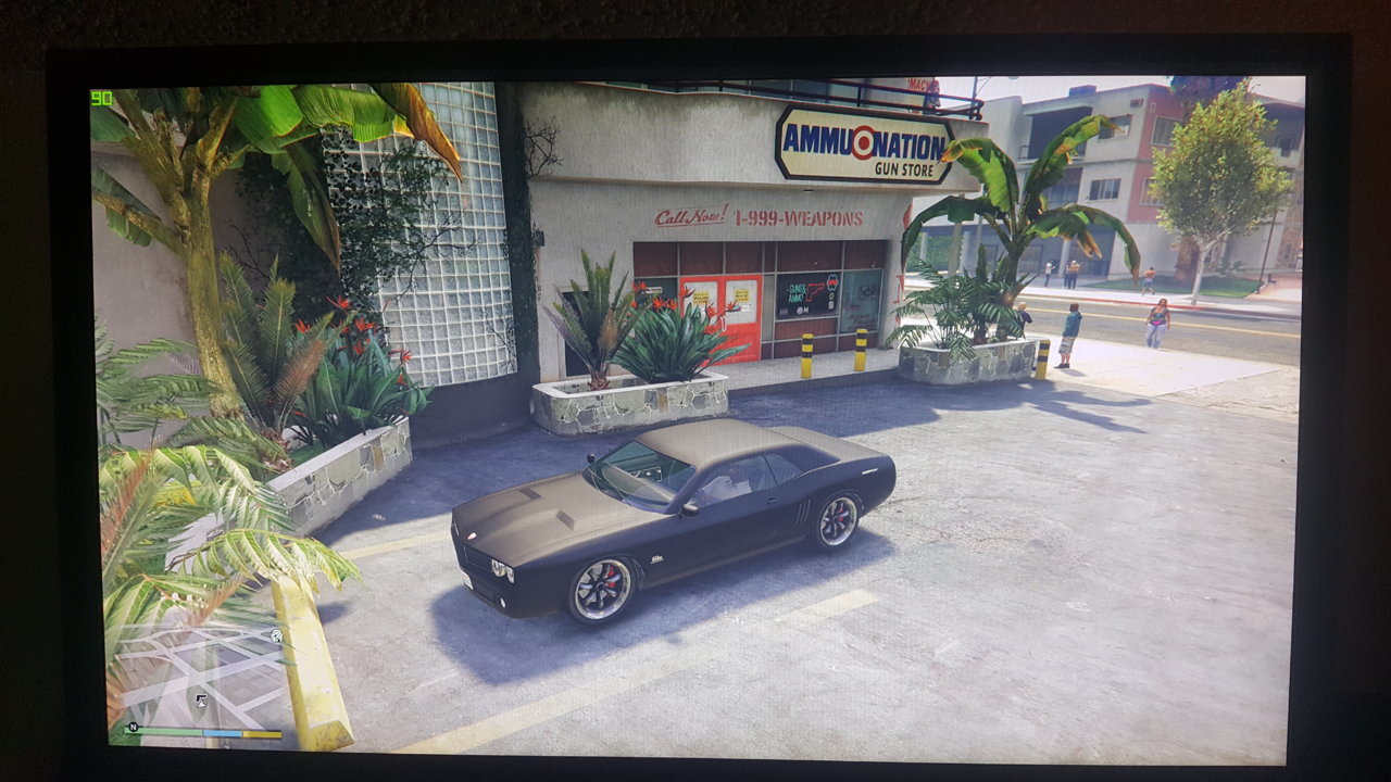

    I dont think it has anything to do with the cpu at this point. After finally getting it to boot yesterday, Iv'e been gaming hard since my post yesterday. Ive also been running various benchmarks for cpu, video, memory.
    Not had a single hiccup since.
    One thing i did do since my OP, was carry this 50 lb beast downstairs to the garage and hit it with the air compressor. Carefully making sure to hold my fans on the vid cards, psu and rad fans.
    I thourghly went thru and made sure all cables were seated in the psu.
    Iv been running cinebench, scanner x, Precision X, pi, passmark, a bunch of older ones. Not even a single gitch. Ran GTA 5 for roughly 6 hrs lastnight.
    I guess if nothing else happens and it continues to run fine, I'll use the new psu and build another rig.

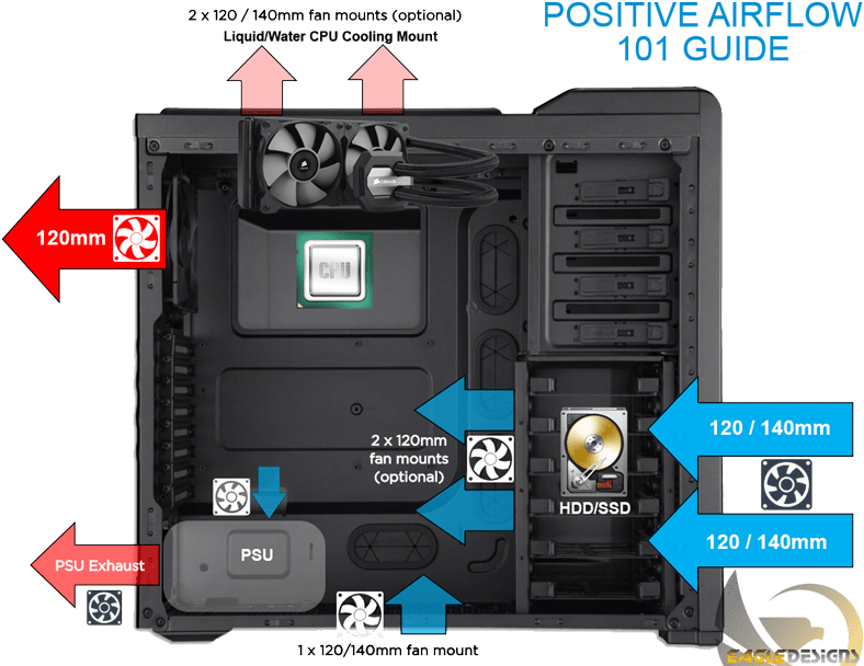

    So I just found something non related.
    The 2 fans on my h100 rad are blowing from inside the case, thru the rad and then to the outside. Thats not the correct airflow, right?
  13. Jan 30, 2021 at 9:39 AM
    #3533
    Matic
    Matic The "OFG" Baby!!!
    Sep 8, 2009
    #22436
    26,677
    Tricky Dick
    Easley, SC
    1 owner 2002 TRD, SR5, DC, 2.7. Full OME suspension, STT pro's.
    OME 881 coils with OME nitrochargers shocks up front. TC UCA's OME Dakars with extra leaf in the rear. Warn 8000 winch with 80ft custom braided synth line. Custom 60ft synth extension. All pro tube bumper, Hi-lift jack, Safari Snorkel, Wilco tiregate. 2019 Jeep JLUR.
    Idk how this happened. When I went to blow all the dust off of the radiator yesterday, there was dust on top of the radiator, indicating it was pulling ambient air from outside, thru the rad, into the case and out the rear.
    How can it be now that it is blowing from inside the case, thru the rad and outside?

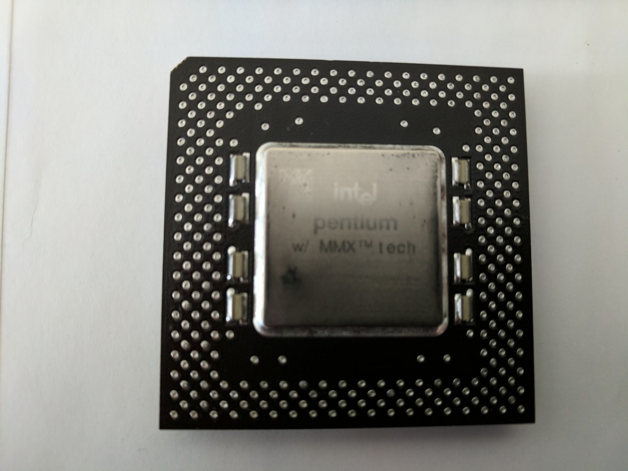

    I started a new build last weekend and had to stop to wait for some more parts. It’s a blazing fast socket 7 166 MMX!
  17. Jan 31, 2021 at 9:31 AM
    #3537
    Goatfrog
    Goatfrog Well-Known Member
    Jul 7, 2020
    #333710
    879
    Bill
    Pittsburgh, PA
    2020 Red DCLB TRD Off Road
    What are your plans for that? :duh:
    airmax233 likes this.
  18. Jan 31, 2021 at 9:52 AM
    #3538
    TacoRated
    TacoRated Do the chickens have large talons?
    Apr 18, 2016
    #184657
    601
    Colorado
    2016 DCSB TRD OR
    High speed, special purpose duct-tape noise cancellation LCAs. Redline Tuning hood struts Hefty Fabworks Rock Sliders Trifold Bed Cover TRD Pro Grille
    Quake
  19. Jan 31, 2021 at 9:55 AM
    #3539
    Goatfrog
    Jul 7, 2020
    #333710
    879
    Bill
    Pittsburgh, PA
    Dos?
  20. Jan 31, 2021 at 10:02 AM
    #3540
    replica9000
    replica9000 Das ist no bueno
    Apr 6, 2008
    #5782
    16,424
    Lake Chargoggagoggmanchauggagoggchaubunagungamaugg
    2019 T4R ORP

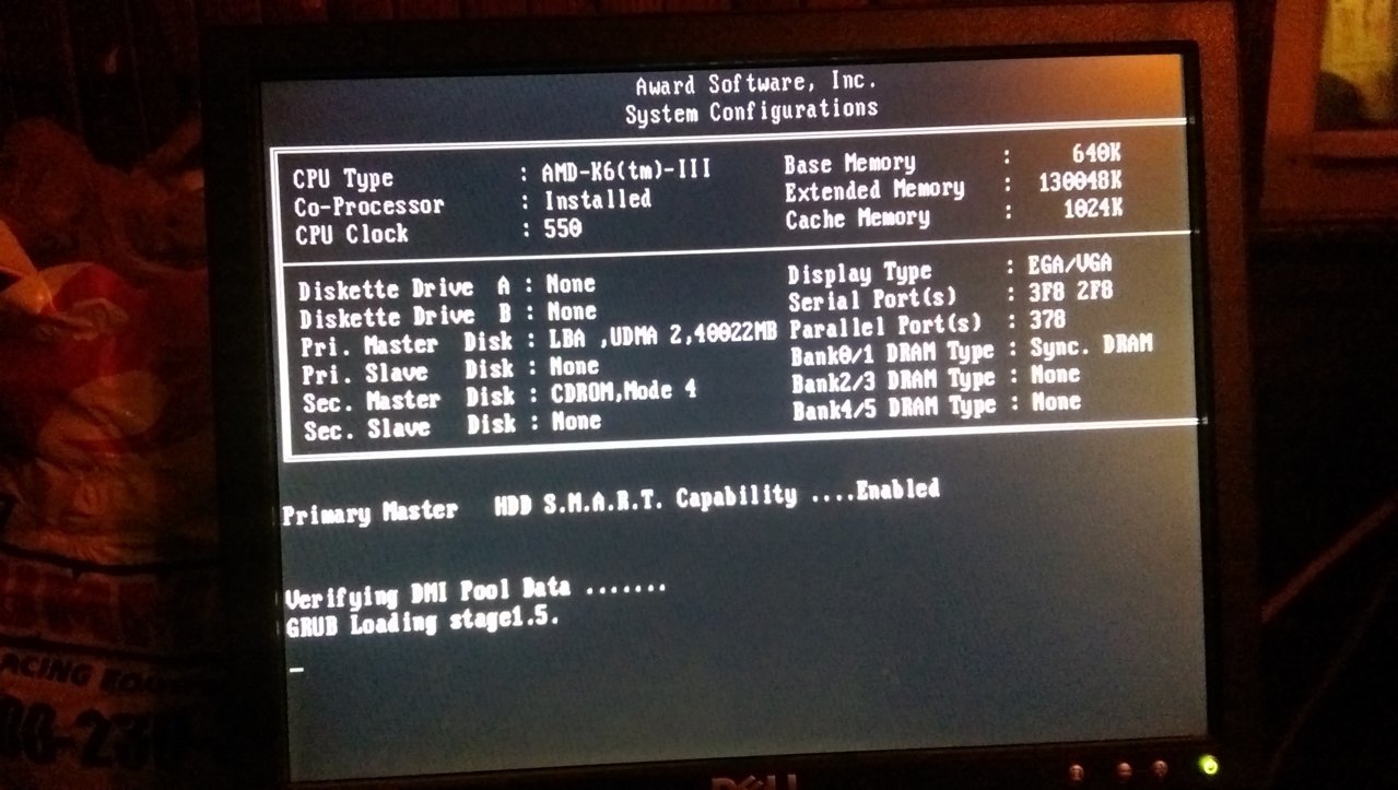

    My Socket 7 machine still works. This was the build that made me favor AMD over Intel CPUs. I still have the Intel CPU too, but it can only OC to 266mhz on a much higher voltage.
    TacoRated[QUOTED] and Matic like this.
