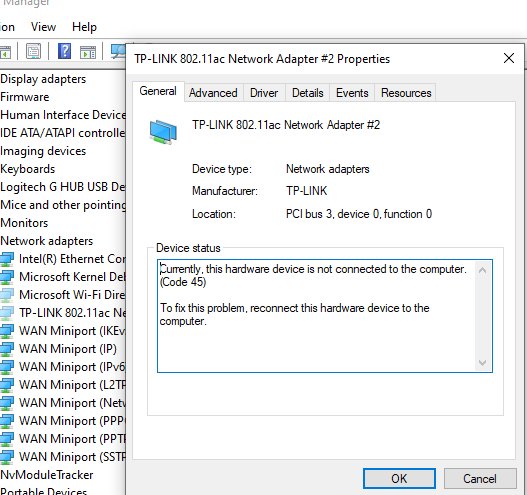

    Anyone have suggestions for how to get my Archer t6E to be found? Tried in both PCIE x1 slots; then in the x16 slots(that worked for some people online). I double checked drivers I am trying to use is correct (win 10 64 bit) That card and my mother board both were new around the same time. Asus z 270. Green light on adapter is lit up, Cannot be found from TP link drivers or in device manager. Really trying to avoid wiping the computer to see if its some junk file interfering.

    Are you good with Linux at all? Fire up a live CD/USB and see if the card shows up. Then you'll know if it's a hardware or software problem.

    disabled LAN in BIOS. No luck with drivers finding the adapter. I had an ethernet cord plugged in and now I am not able to connect to internet via Ethernet. That's due to disabling onboard Lan right? And I have 0 clue with Linux how any of that works. I'm also still not picking it up in device manager. green light on the card is on. It's in a x16 slot right now since people online said that worked for them with this card. I'm getting to the point where I may just get another card. I've had this one for 3 years and never actually NEEDED it until a few months from now.

    So Windows troubleshoot program says no driver for a network adapter can be detected, but when I run the program to install driver for TP link it can't find the network adapter. So The issue may be the TP link Driver install wizard wont detect the network card but windows cant find drivers since TP link cant detect and allow me to finish install?

    Yea on the TP link site I used the updated windows 10 supported drivers. The most recent drivers for that card specifically. And the install wizard still does not detect the card itself so I am pretty much done. I'll just try a different one that cheap. I won't have crazy fast internet in the dorms anyway so don't need a card that supports high speeds.

    I've only tried TP-Link once. It was a WiFi card for my old laptop. It had a strange problem, it would identify as a different card on reboot. Maybe 1 out of every 5 reboots, it would identify as the correct card and work. Happened under both Linux and Windows. Got a replacement and it still happened. Never tried TP-Link again.

    Yea I bought it a few years ago but didnt need it instantly so I bought cheap. I'll maybe need it in fall in dorm rooms so I'm trying to figure it out now. Going to just get a usb one thats got good reviews and a better known brand. Dorm wifi will suck so not like I would take advantage of a super nice wifi adapter. Probably something similar to the one @Silver02Taco has got. Keep it simple and not mess with the PCIE slots. will be easier to troubleshoot should anything go wrong.

    This probably doesn't help, but my 8 year old TP Link DWA-556 has been slowly failing me for around 2 years. Been fighting it massively the last 6 months to the point of lost connection and card not identified. My only solution has been to reboot the machine (sometimes multiple times). I think it's time to replace your TP Link card with something better.
