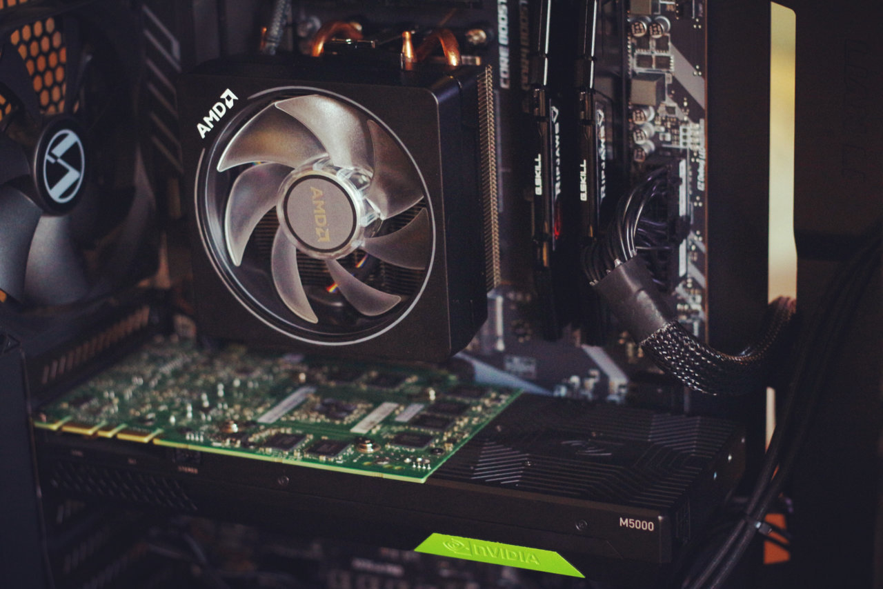

    In the quest for performance (and I just like to tinker), I just purchased this: https://www.performance-pcs.com/wat...adro-m04-incl-backplate-black-ac-11331-d.html
    Basically the last water block I could find anywhere for my ancient Quadro M5000 GPU.
    I think I'm going to go simple with my first custom water cooled loop, and buy an EK kit and the additional fittings, tubing, radiator, and fans to cool the GPU and CPU.
    This way when I upgrade to a newer Quadro RTX eventually, I'll already have a loop meant for a GPU water block.
    If anyone has any advice for a beginner with water cooling I'm all ears!
