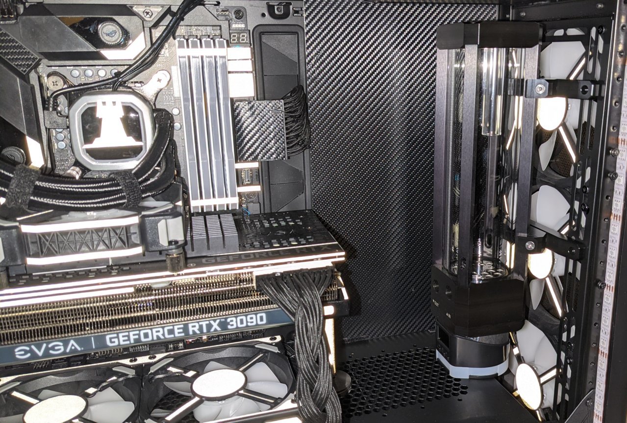

    T U B E
    Heat killer Tube 200 with D5 Next pump, still waiting on EK front and back blocks for the GPU and need to get some radiators tubes fittings and CPU block then I can start planning a loop.
