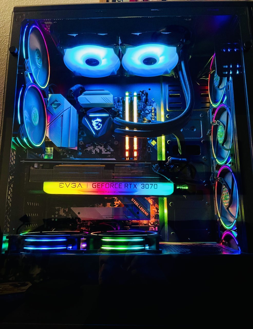

    Didn’t think I would ever get an RTX but now I got 2. Lol. Keeping the 3070.
    7212ACBA-017A-458A-AF5A-87A5B68423FF.jpg 9F7EE291-89A4-4C99-BEB1-4E4EB4D36D87.jpg
