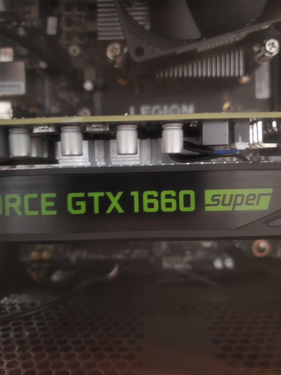

    Saw this at Costco today for anyone looking for an entry level machine.
