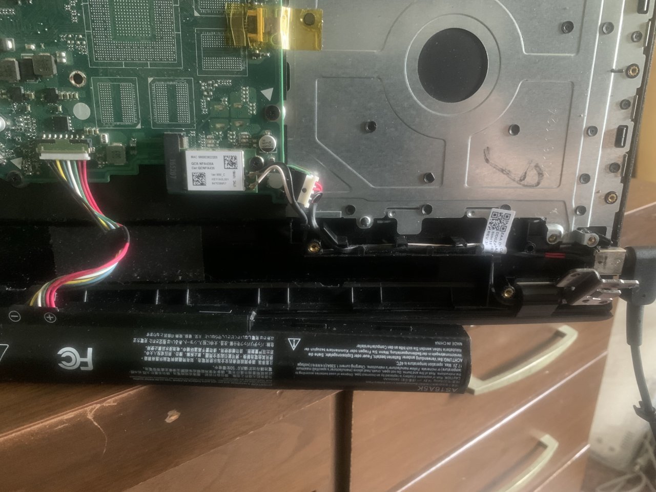

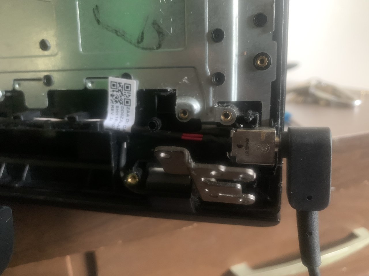

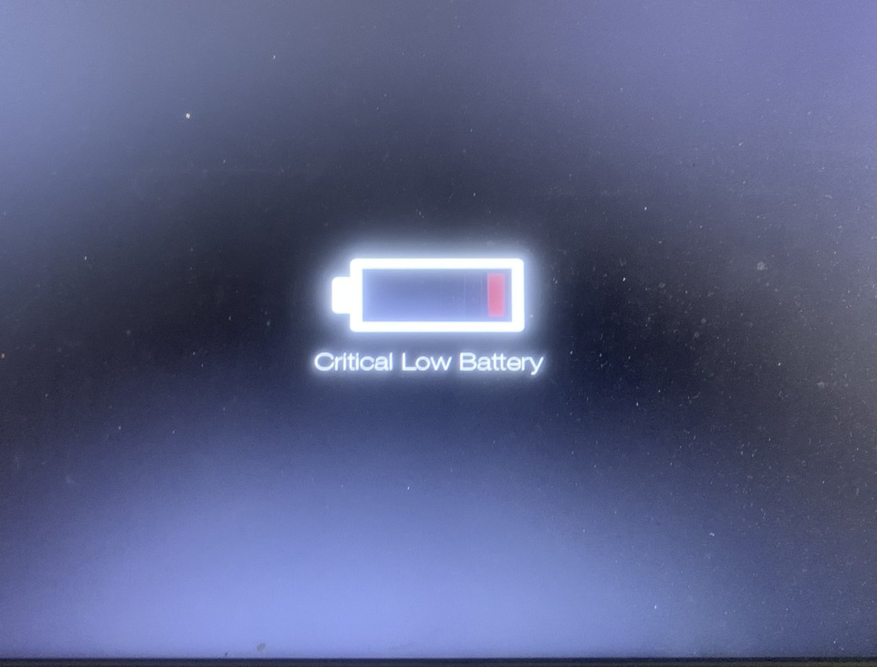

    Alright looks like it was the charger and $15 was all it needed to fix this.

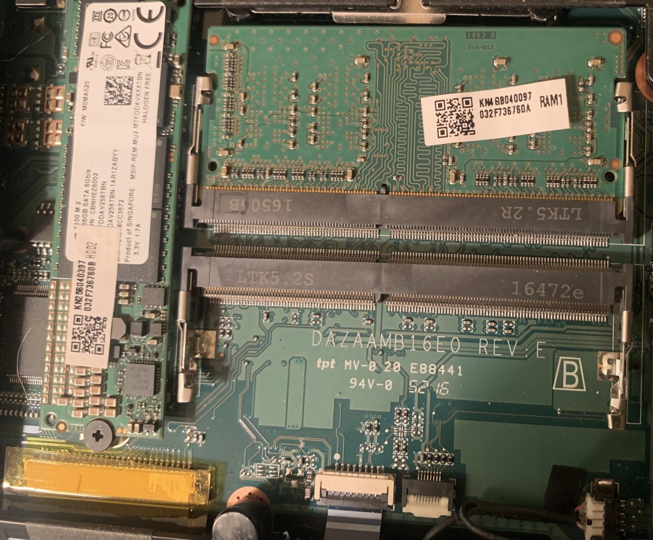

    Looking at the PCB it looked like more RAM could be added and sure enough, watching this video it looked like it could.
    https://www.youtube.com/watch?v=Wg5_LI898NI
    It said 4GB of DDR4 2133MHZ would be what I needed and looking it up in Windows, it was saying there is 4GB currently so that should match it and make it 8...
    I don't obviously want to overspend on this since it's a light duty laptop for my wife to browse and use basic programs on, but it would be nice to make it a bit faster. Any recommendations from the $19.99-$24.99 range units?
    https://www.amazon.com/s?k=4gb+ddr4...fix=4gb+ddr4+2133mhz,aps,329&ref=nb_sb_noss_1
    Or would it be possible to get 2 sticks of 8 for 16 total with this machine?
    Stoked on this!

    Depending on which model and CPU you have, 32GB may even be possible. I would check the serial number with Acer. https://www.acer.com/ac/en/US/content/support

    I couldn't recommend anything more than 16. Choosing between 8 and 16 will depend on what you plan on using it for.
    As far as technical limitations of that particular laptop impacting the diminishing returns, I'm not sure.

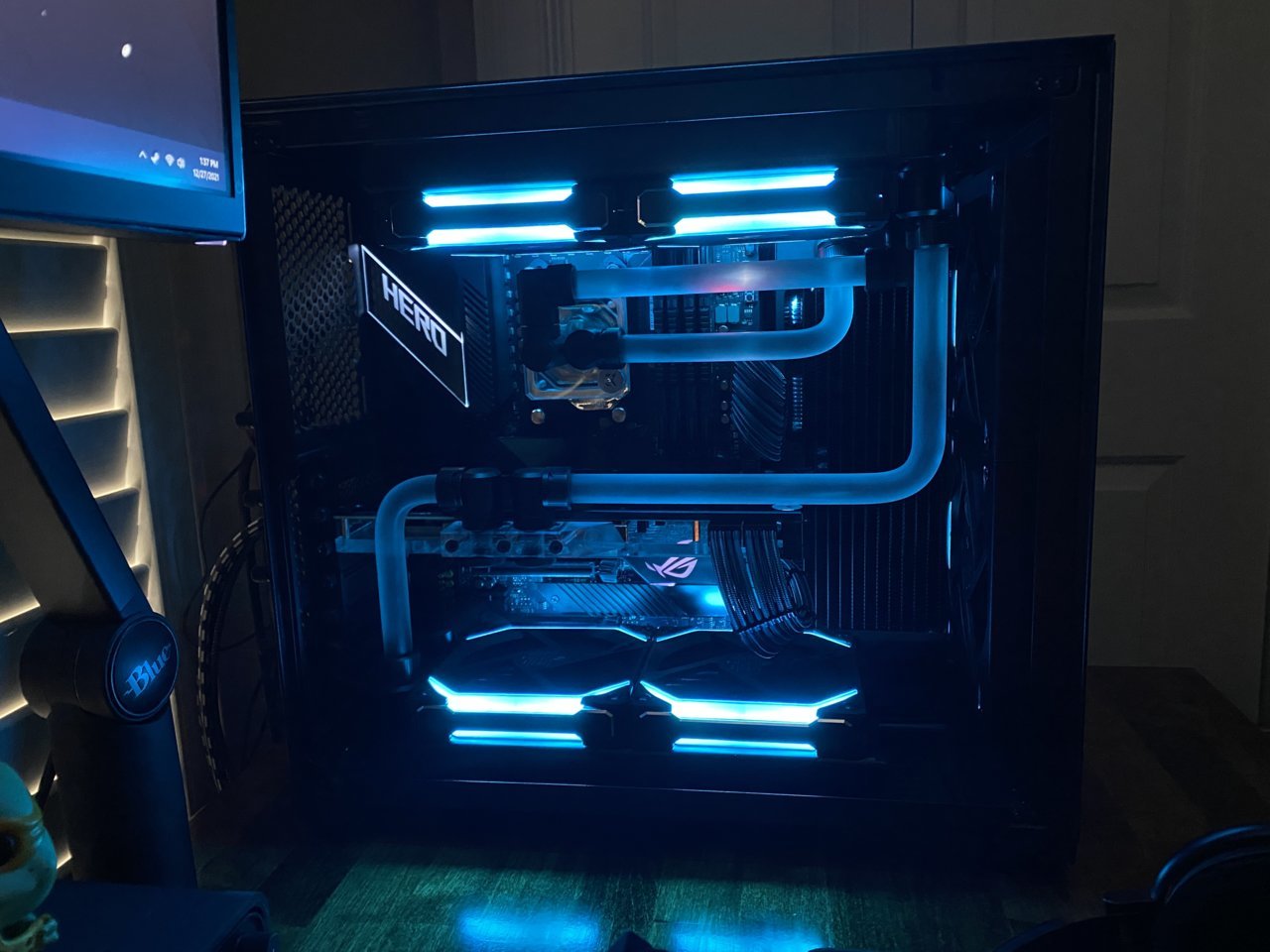

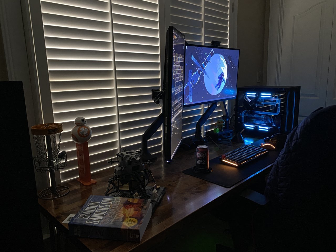

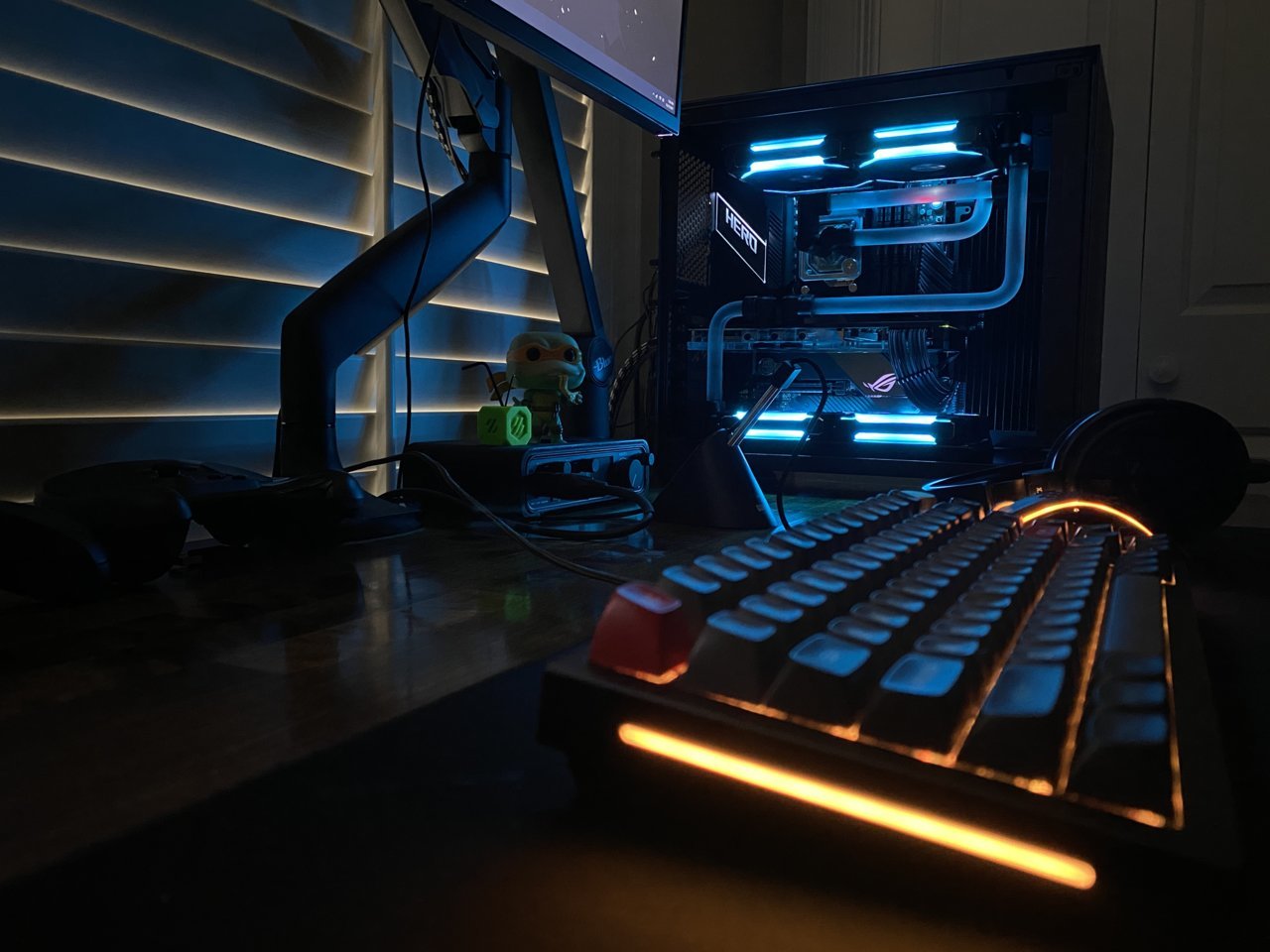

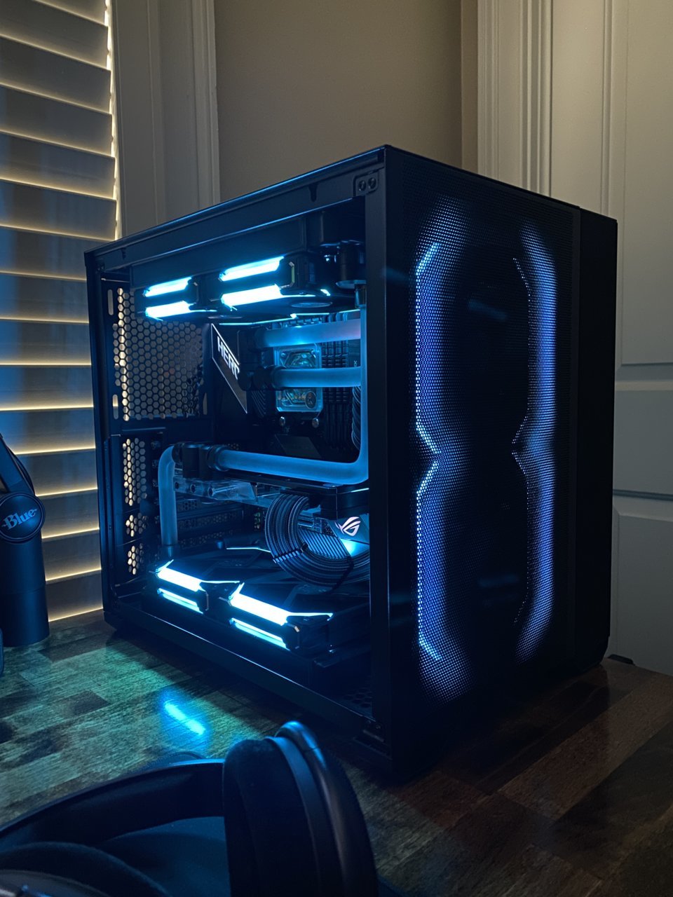

    Slightly overkill build for what I do…I just enjoy putting them together.
    Case: Lian-Li O11 Air Mini
    Motherboard: ASUS X570 ROG Crosshair VIII Hero
    CPU: Ryzen R9 5900X
    RAM: 32GB G.Skill Ripjaws V DDR4-3600MHz CL16
    GPU: EVGA 3080 XC3 Black
    PSU: EVGA SuperNOVA 850 GA
    Custom waterloop parts from EKWB, Hardware Labs, and Bitspower

    Nice build dude!!! We have pretty similar specs. how are the 3 240s keeping up with the temps?

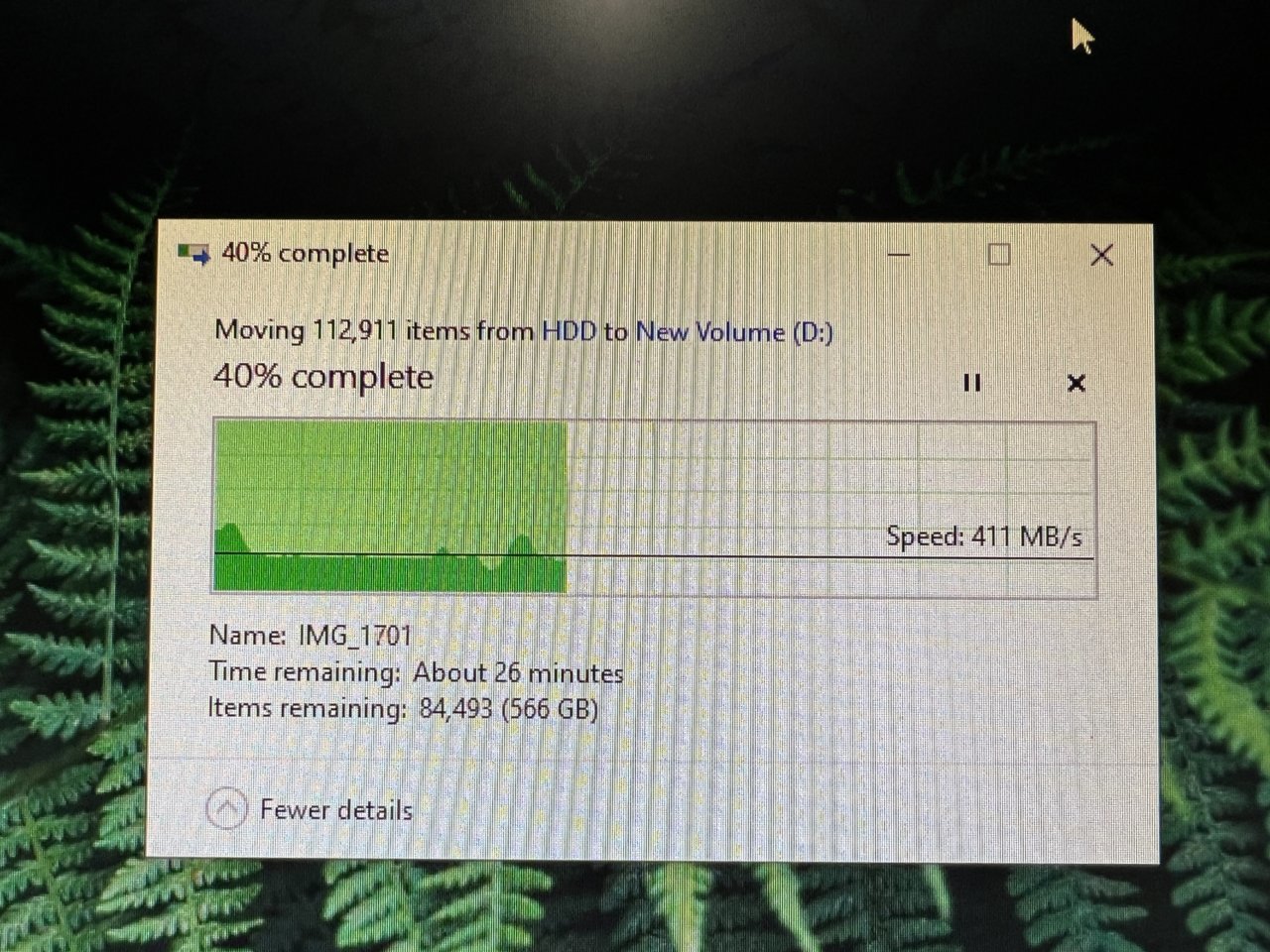

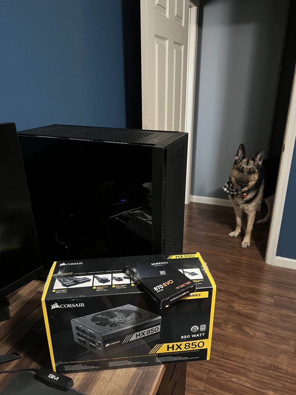

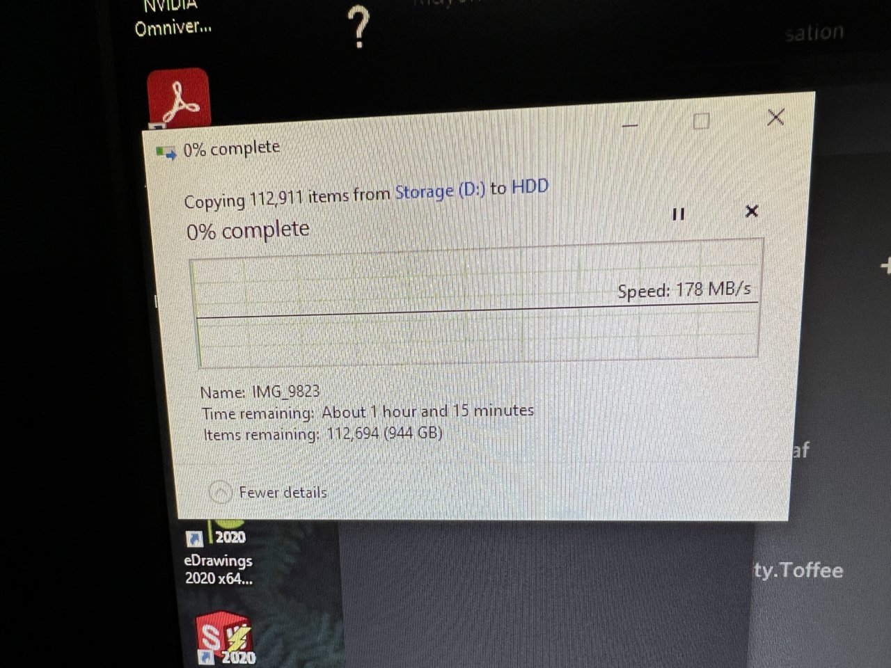

    Tossed the 870 Evo SSD and HX850 platinum PSU in.
    File transfer with the original HDD:
    New SSD
    much more respectful speeds
    also the PSU is basically silent under sustained load so I’m ecstatic with the state of this machine.

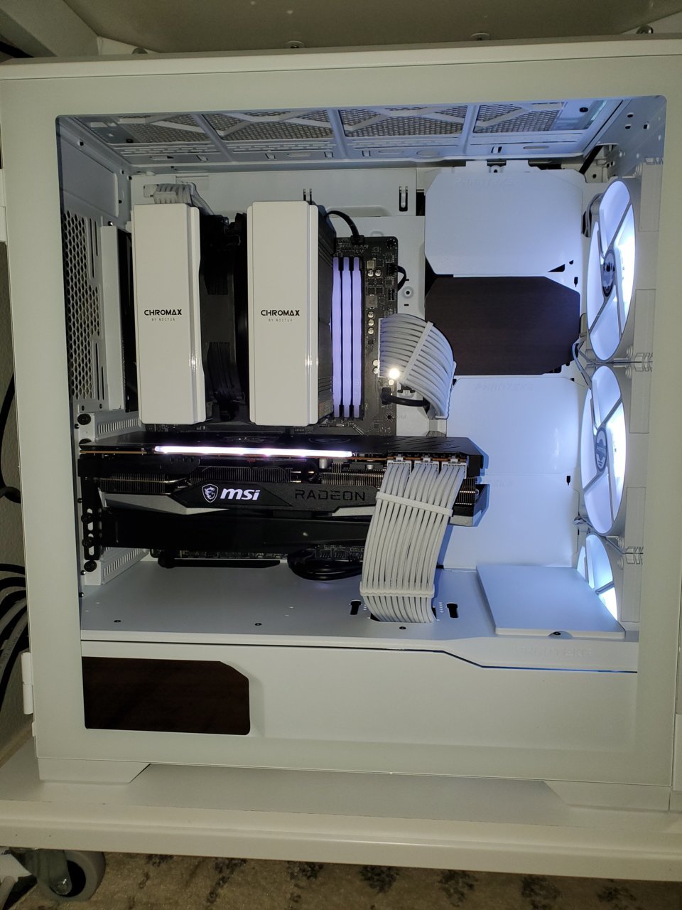

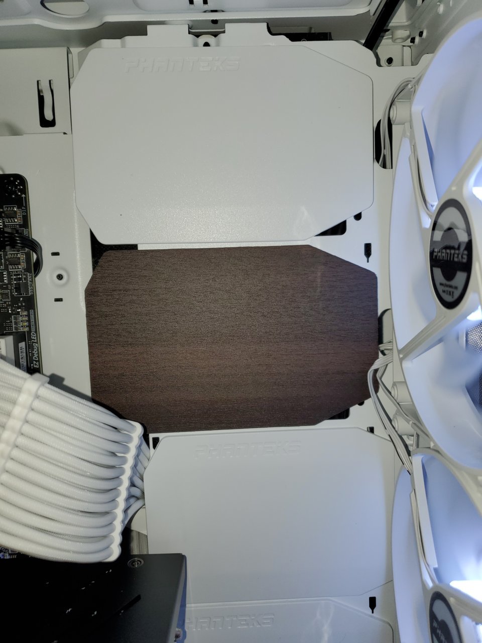

    Still have some cable management and vinyl to do but we're up and running :D
    Close up of the walnut vinyl wrap

    Highest temp I’ve seen so far was 49C for the loop. That only happens after the room is essentially a sauna though, typically stays in the low-mid 40’s.
    They actually do have 140’s now, at least in the SL version like I’ve got. Those Corsair fans are nice too!
    Nimble9[QUOTED] likes this.

    Nice! Acrylic runs? IIRC PETG deforms at 40c
    mine gets up to 41c after the room is a sauna and I’m uncomfortably hot. I could drop it a bit but I like 1000 rpm fan speed as it’s nearly silent.
    always thinking about how to improve lol

    Yeah, acrylic runs with a couple of EPDM tubes hiding in the back. Same here on the fans, mine are just running at a steady 800RPM to keep things quiet. I could bump them up though, the pump isn’t the most silent thing in the world.
    Only time it broke the mid 40’s was during some long stress tests just to make sure there wouldn’t be any thermal runaway issues.

    Clean build!! Planning on adding more fans if needed?
    What are the specs?! (I think I missed it a few pages ago)
