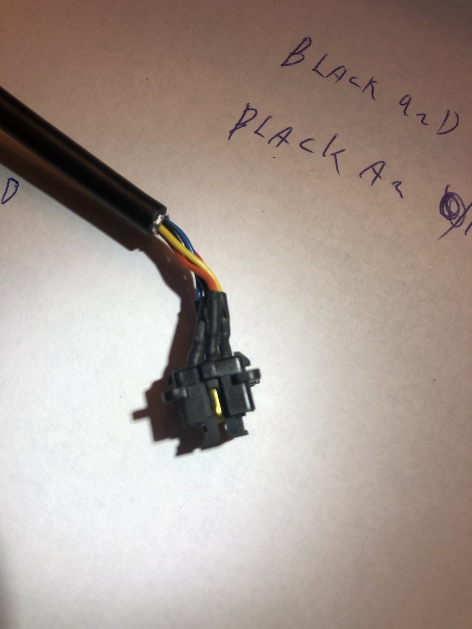

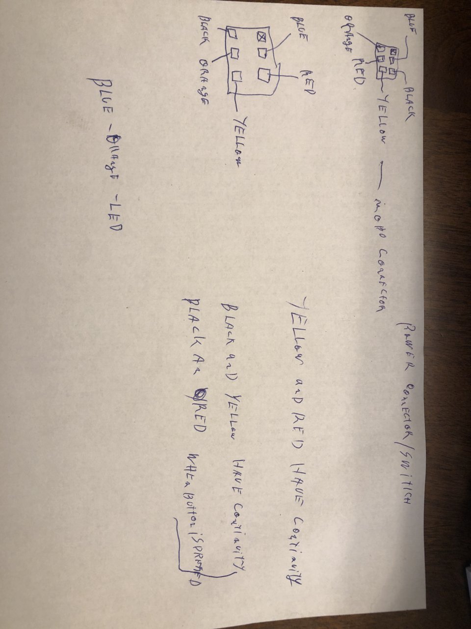

    Getting dads PC setup to use the button on the case for power instead of opening the side of the case and hitting the Dell button and I have a wiring question.
    The OEM power button is 5 wires.
    From the top center of the connector working clockwise.
    Blue
    Black
    Yellow
    Red
    Orange
    Yellow and red have continuity no matter what.
    Black and yellow and black and red have continuity only when the power button is pushed.
    Making an educated guess, black is ground, red is power in, so those two take care of the main function of the switch.
    Orange and Blue appear to be the positive and negative leads for the LED to the power button.
    Leaving yellow for the reset, correct?
    In this photo the wires are Black-Orange-Yellow
  5. Jan 8, 2019 at 2:52 PM
    #465
    TenBeers
    TenBeers Well-Known Member
    Jun 5, 2009
    #18067
    7,115
    Rich
    Bentonville, AR
    2018 TRD Pro Cavalry Blue
    CBI bed rack and sliders, Backwoods Adventure Mods front and rear bumpers, etc. And some stickers.
    ^ Most likely that is correct.

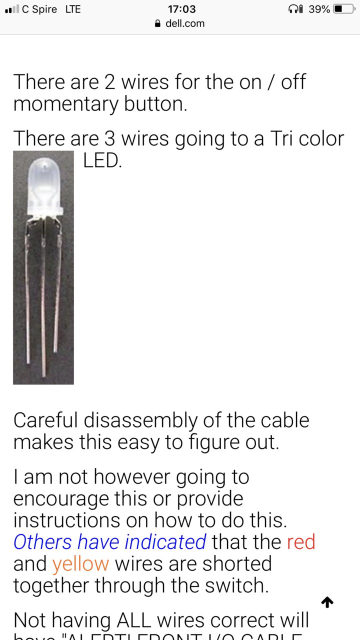

    I was wrong, the only ground needed is for the LED, the switch should only momentarily close the circuit to signal the MoBo to start.
    2 hots for the LED (dual color LED) and one ground, and then a hot in for the switch with a return/signal going back to close the circuit.
    Press and hold the switch to get the restart as it is a function of the MoBo that just reads the duration of hold on the button when pressed.
    I decided to google it because surely someone has done it before and this is what popped up.

    Seems like this is partially accurate.
    Red-3.3V
    Black-3.3V
    Orange-5V
    Blue-5V
    Yellow-Grnd
    Touch black to yellow and we have lift off.
