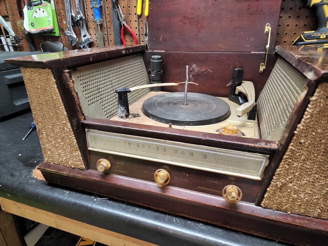

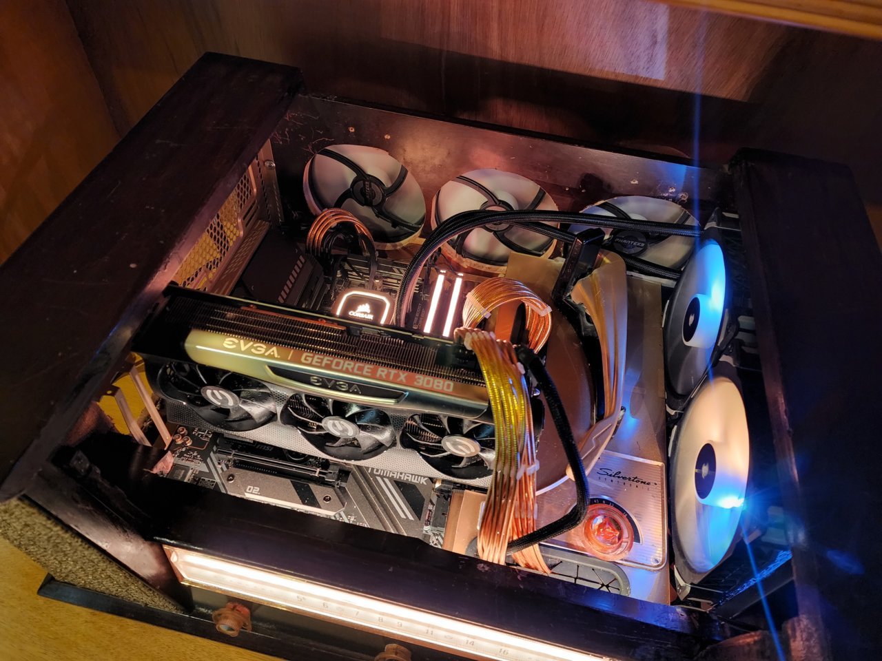

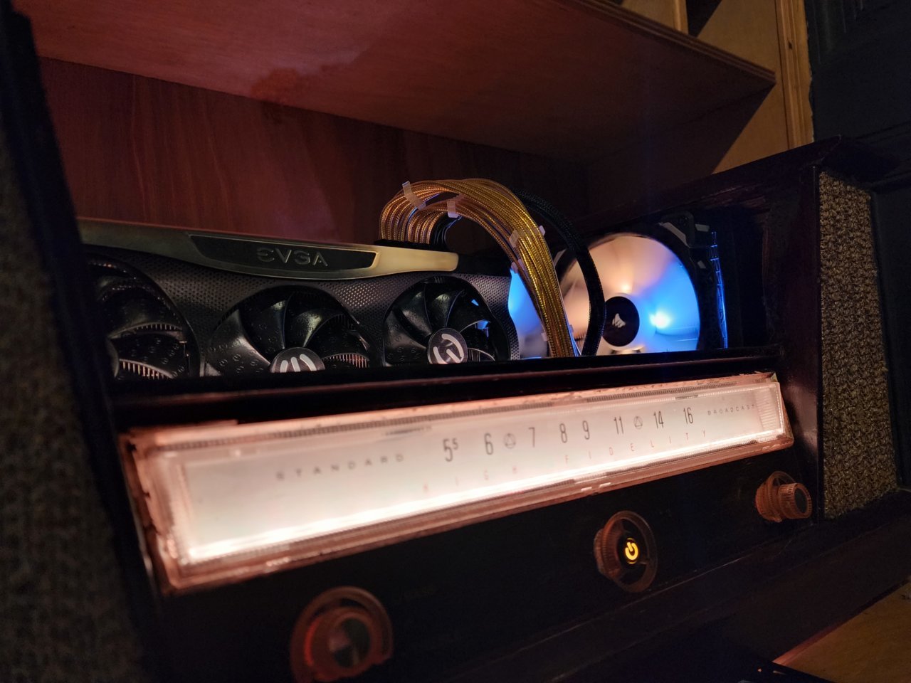

    Just finished up this hot potato. Actually it runs quite cool. I used a totally defunct, no chance of restoration, Silvertone Record player. It came out better than I could have imagined. Just have to RMA the CPU cooler AIO because corsair software blows and bricked the rgb with the first update lol.
    The dial is full rgb but I like it looking like and old school vac tube instead of rainbow.
    Edit: here's the build process for anyone interested https://youtu.be/qeTMmpBNe4E
