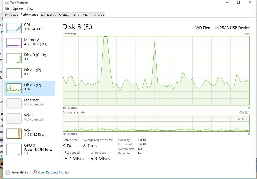

    Does this transfer speed seem correct for a USB 3.0 external drive?

    It depends. Is the drive a SSD or HDD? If it's not solid state and the controller is garbage than, yeah, that seems about right. Also if you MB doesn't support native USB 3.0 that can cause speed issues. It might have a USB 3.0 header but not natively support USB 3.0 on the chipset. If their is a separate controller chip that can incur a penalty when transferring files since there are several hand offs between the two drives during the transfer and no cache support in those handoffs.
    Edit: I looked up that WD device. It should support 100 mbps transfer speeds IRL. http://usb3speed.nirsoft.net/pdesc=...+Digital+Technologies,+Inc.&vid=4184&pid=9635 . Odds are either of the cases above are true or the data you are transferring is from the OS drive which limits speeds sometimes if the OS is trying to pull and write data at the same time as the transfer.

    HDD as you looked up, it’s the OEM dell MoBo with USB marked SS (I assume it’s an early version of 3.0) plugged into the back.
    I am probably limited from the OS drive as it’s pretty old.
