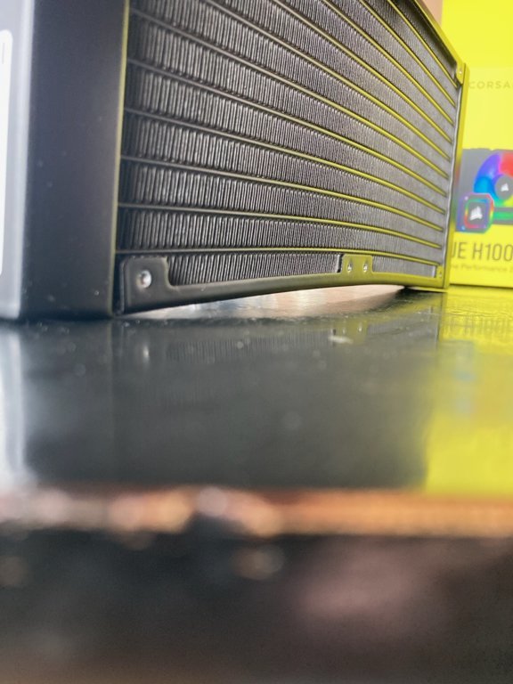

    I died a mini Roblox death when we opened it.

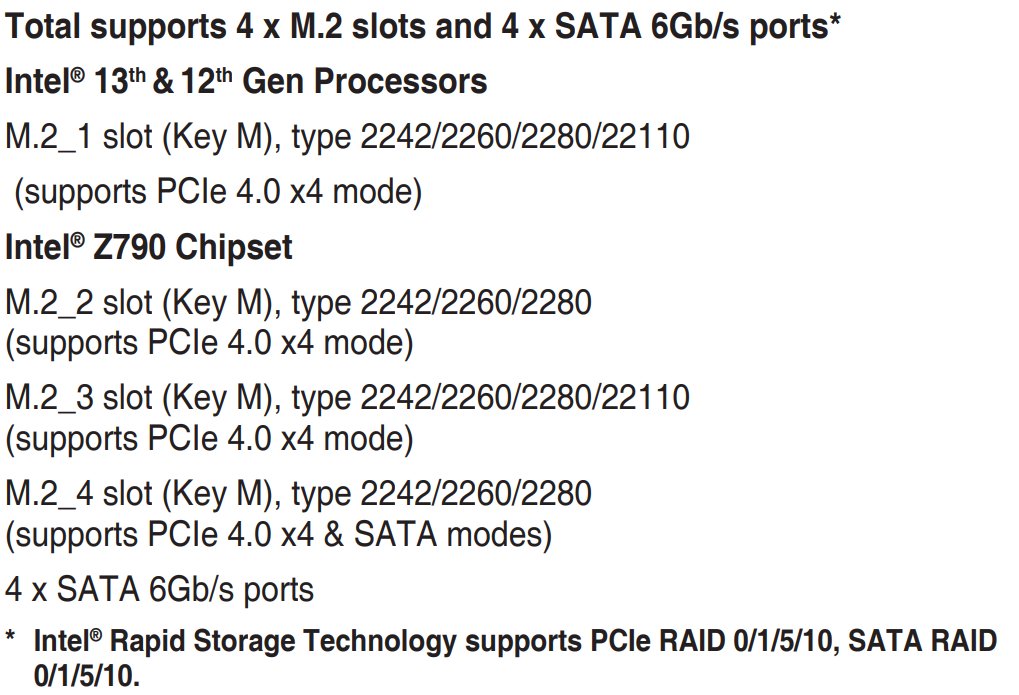

    Question regarding the NVMe drives...
    The Asus TUF Z790 mobo has 4 NVMe slots - three of them are under metal cover plates and one is out in the open.
    I have two WD Black SN770 drives (1TB & 2TB) to put in there. I plan on using the 1TB for Windows and programs and such and the 2TB for games and file storage. Seems like the top slot (nearest the CPU) is best for the OS drive, correct?
    And which slot do I put the other drive into?

    Consult your MB manual. Usually 1 slot, the closest to your CPU, is hooked up directly to the CPU and should be your OS drive. The other slots will be either hooked up to your chipset or cause your graphics card slot lanes to be bifurcated (cut in half). You don't want your GC slot to be bifurcated so hook it up to whatever M2 slots are connected to the chipset. There will be a flow chart in your MB manual showing you how all the slots are hooked up.

    Okay I found this quickly in the Manual for the Z790-Plus Wifi (check to make sure this is your board):
    So your OS drive should be in slot M.2_1 and your storage/game drive should be in either M.2_2 or M.2_3. Don't use M.2_4 since it probably will do something funky to the chipset USB or SATA since it has SATA lanes allocated to it.

    Thanks - my last build had spinning platter hard drives and a boot ssd. Haven’t messed with NVMe drives before.

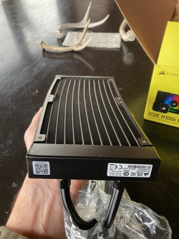

    wow, that thing obviously took a beating at some point! My Corsair AIO from Amazon conveniently came with no removable plastic film over the thermal paste, so it had just gotten all over the place in the packaging and was hard and crusty. Put a 1 hour delay in my build when I realized that because I didn't have any thermal paste and the closest best buy to me is 30 mins away.. Good times.

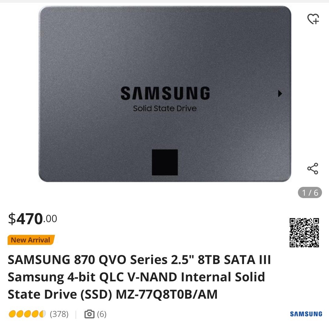

    Almost tempting. The price was less than $430 last week. Think I'll hold out until it reaches 10TB capacity.
