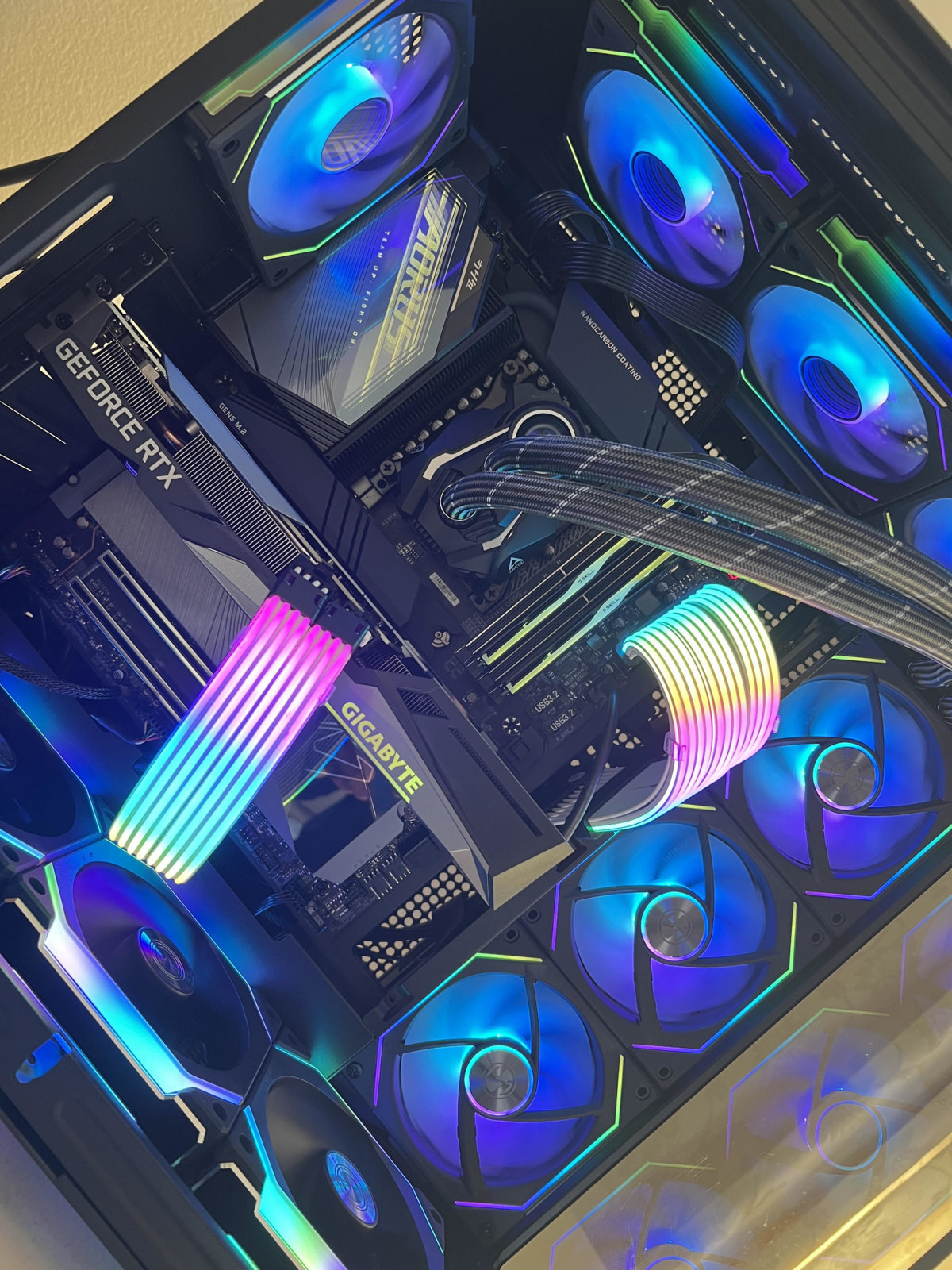

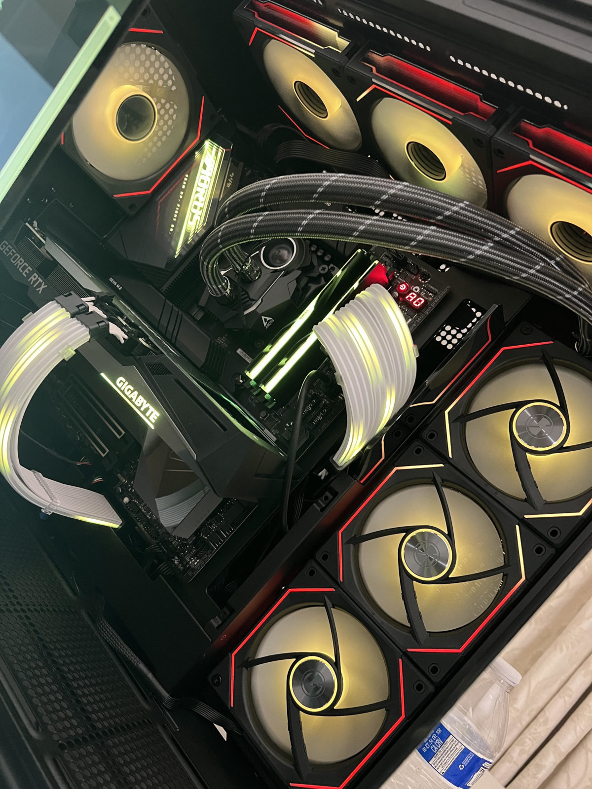

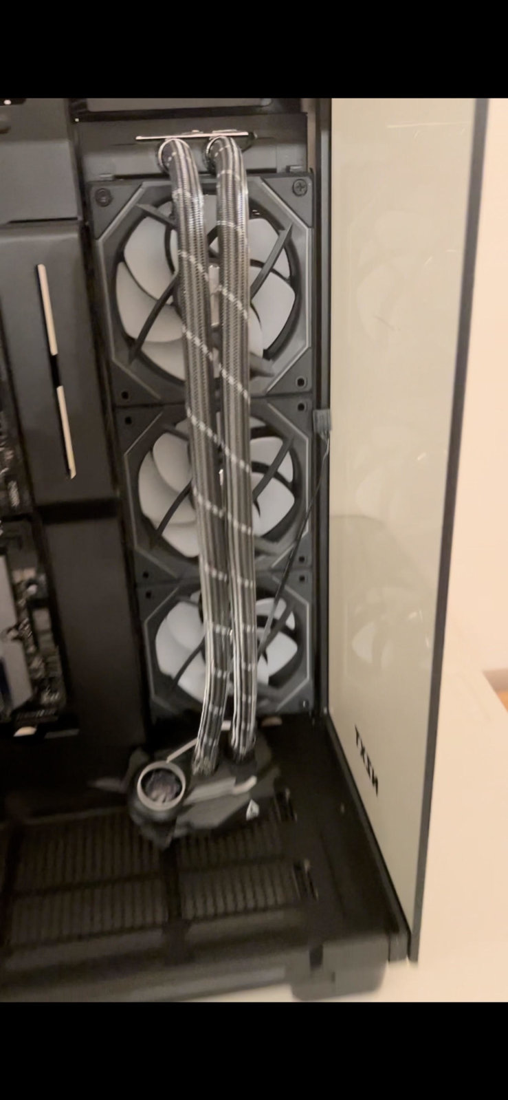

    non gamer pc build... this PC was built for the kids to watch CocoMelon
    Specs
    - intel i9 14900k
    - gigabyte z790 aorus master x
    - gigabyte rtx 3060 12gb
    - ddr5 trident z5 cl30 (i believe? maybe cl32)
    - artic freezer ii 360
    - solidigm p44 pro 2tb (2 of them)
    - samsung 990 pro (2 of them)
    - lian li strimers
    - thermal take atx 1350
    - nzxt h9 flow case
    and like $700 in fans lmao... still waiting on the reverse infinity fans, so those arent installed. 9 intake fans, 4 exhaust, has to be tester if its to much ill tone down the intake to 6.
    i had some issues with the aio not fitting in the vertical pos, i knew ahead of time it was going to be a problem but it wasnt really.. i just cut the damn metal to fit.
    will replace aio and bottom fans for infinity fans when they arrive.
    asuchemist, PhoS, Pchop and 2 others like this.

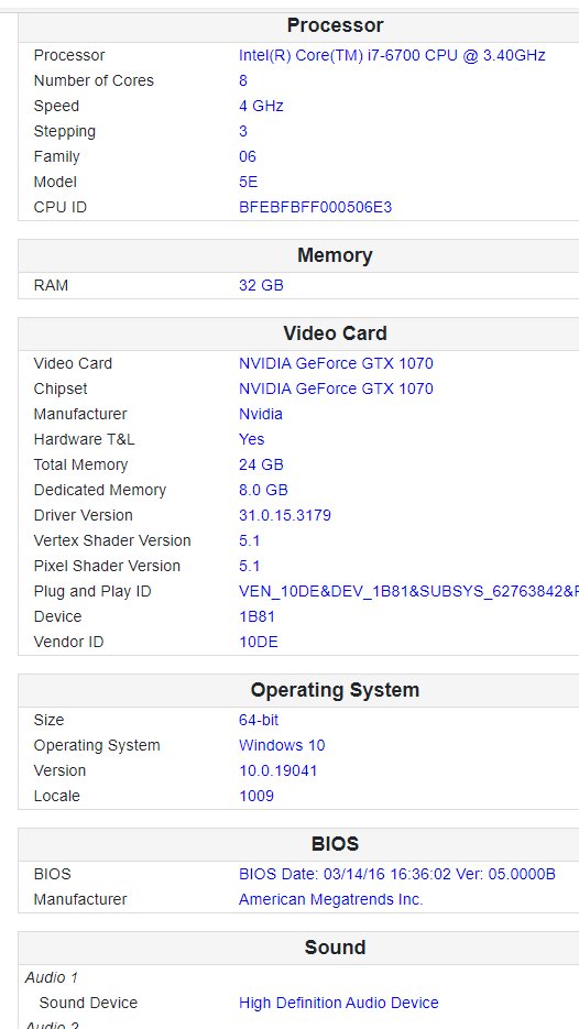

    Looking for some help troubleshooting random restarts when playing a pretty low demand game. I bought a used computer for work that had some decent mid/low end parts that were good enough for me and to run some multimedia/games in my basement.
    I'm a total noob at computer trouble shooting parts, so hopefully someone can give me a few pointers to start.
    I attached specs for reference. I'm thinking video card is just about done?
    Random restarts occasionally during gaming, never when doing mundane work stuff.
    Thoughts where to begin?
    Edit: Updated latest geforce card drivers, and Windows 10 PRO. 53.png

    Clean sweep of any and all software
    Programs themselves can restart your PC as they auto update and install themselves
    Do you ever get a blue screen of death? If so, start with running some stress tests (available free)
  15. Dec 15, 2023 at 11:33 AM
    #5475
    spencermarkd
    spencermarkd Well-Known Member
    May 15, 2016
    #187025
    4,019
    Spencer
    07 Driftwood Pearl 4Runner
    You can check Event Viewer for some clues, might not tell you much but could tell you everything you need to know. Look in the "Critical" section.
    Also, not likely the cause of your issue, but you should see if there's a motherboard bios update available, from 2016 is pretty outdated.

    The funny thing was it started doing this pretty much immediately after I picked it up from so called trustworthy person who sold it to me. Wasn't worth my time or efforts to chase after this person... He installed Windows 10 pro and nothing else. Obviously he did enough to get up to speed, but knew something was up.
    No blue screen of death, the only thing other than shut down/restart it has done is continue playing background Youtube while the screens shut down. Otherwise it's usually restarts.
    I'll look at the stress tests again and see if I can get it to act up. Thanks for info.
    Thanks for info, never used Event Viewer but I'll give it a shot.
    One of the first things I did was update the mother board, seemed to help a bit. But who knows, maybe that was coincidence.

    Could be an overheating issue as well, I'd blast out any fans and radiators with compressed air.

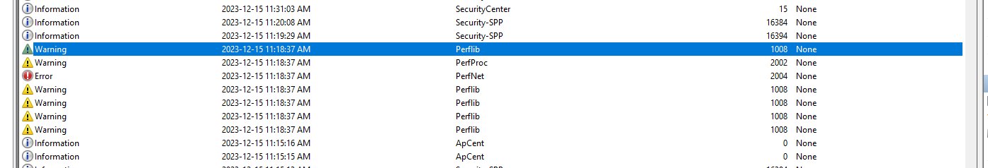

    Found the Event Viewer, not sure exactly of the time of the last restart, but think this may have been around the time it happened.
    Not sure I looked it up right but googled the name of the issue and found this page.
    https://learn.microsoft.com/en-us/a...o-solve-wmiaprpl-failed-with-error-code-devic
    I ran the command prompt scan and it said it fixed some files...
    Edit: forgot to mentioend couldnt find "Critical" section yet. First time ever using this app lol

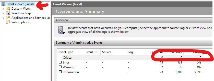

    If you click top left and select the broad event viewer category, it'll show a summary section. If you have any critical events it'll be in the critical category. Error *probably* wouldn't cause a complete reboot, but who knows. Sometimes it's helpful, sometimes it's not.
