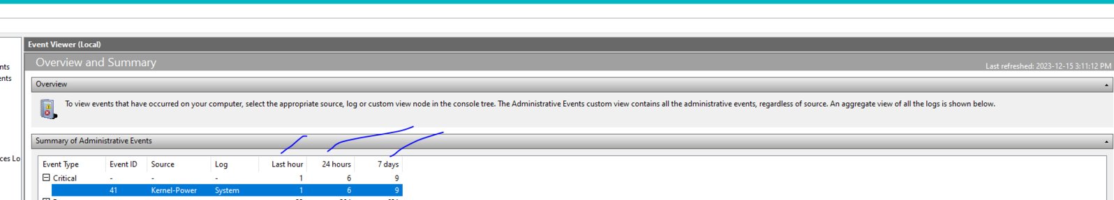

    Thanks I found it! Capture power.png Ipower.png think this is it?
    What the hell is kernel power? Lol
    The critical last hour, 24 hours, 7 days makes sense in about when I saw the reboots.
    Edit: digging deeper seems the task is 63, event ID 41.

    Well, unfortunately not really helpful. That basically just means your computer unexpectedly lost power. Sorry to lead you on that goose chase, like i said, sometimes helpful sometimes not :pout:

    No worries, I think it puts me on the right path. Google came up with a few similar issues with exact names for error codes. Thanks for info though on the Event Viewer

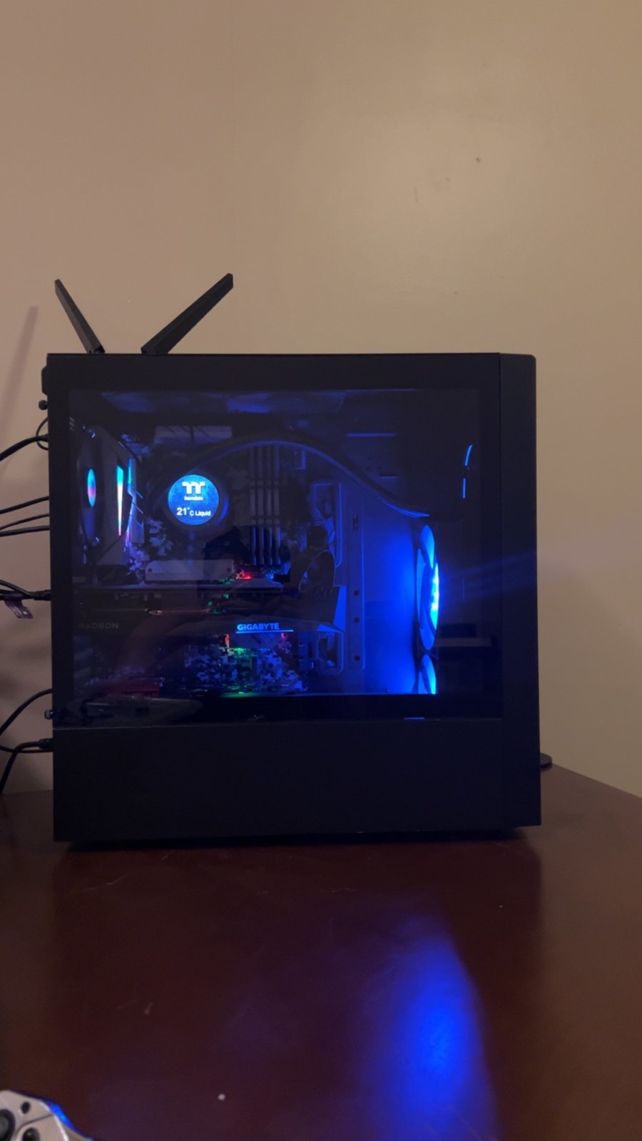

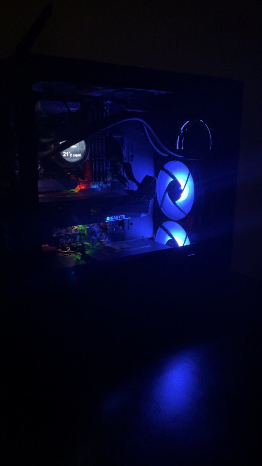

    Got my Christmas presents installed, 280 AIO and R7 5800X installed, everything seems to be running well, AC Odyssey was 99% GPU and 58% CPU, looking forward to trying MSFS in VR with it as my R5 3600 was my previous bottleneck.
    The fan setup is a bit unconventional, I have 120mm fans up front and then the 140’s on the AIO, together they move a lot of air.
    3 120mm exhaust fans also.
    Water temp didn’t seem to get over 25-26*C, room was about 20*C.
    I didn’t even think to look at my GPU temps while gaming, but after closing AC odyssey temps were dropping and I saw 48*C (with Radeon chill active), but I’m having problems with setting fan curves in AMD adrenaline, I can set a fan curve and save it, and it’ll stay for 3-5 minutes and then it will drop to a flat line and want to run at 35% for all temps.

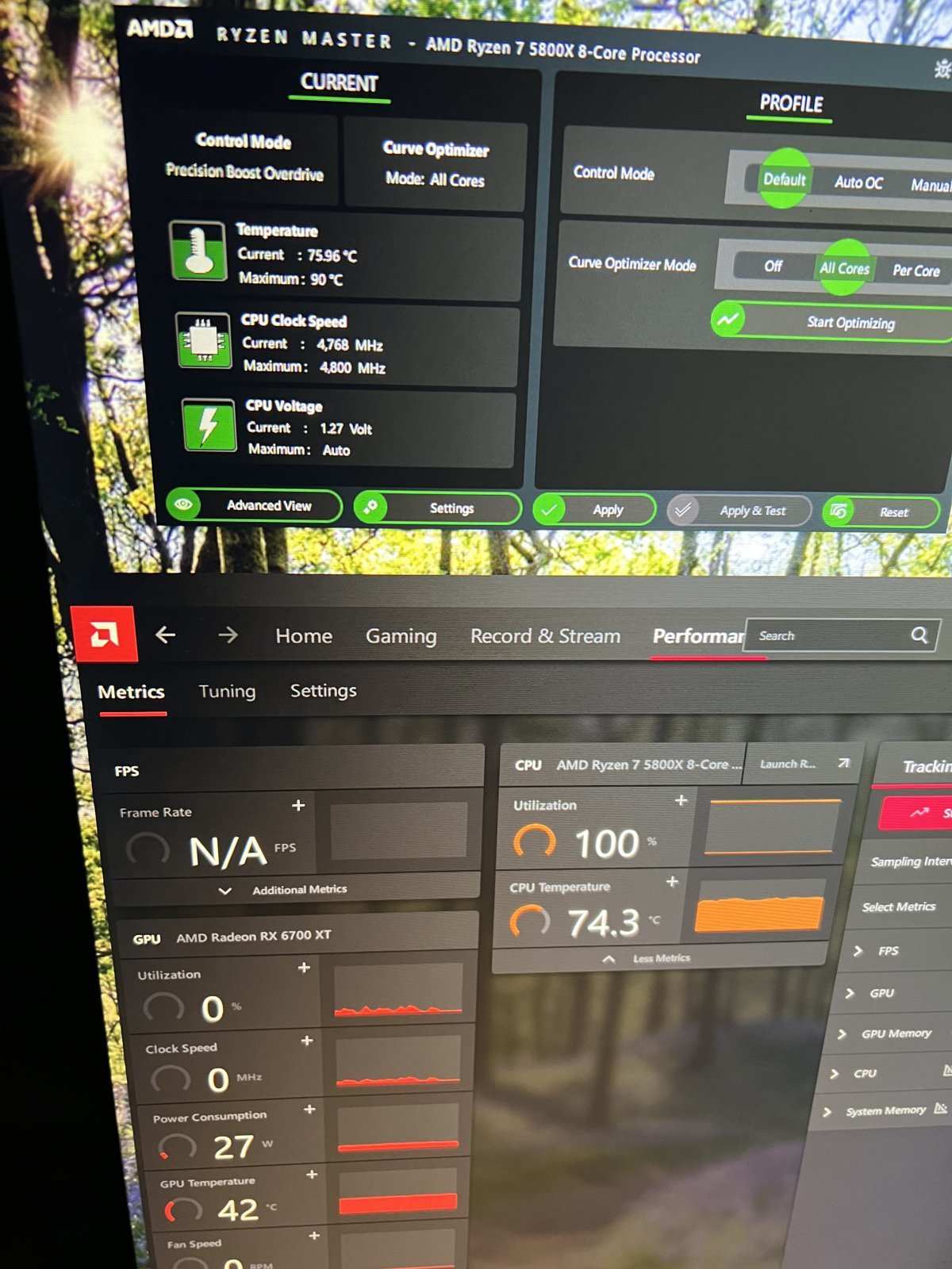

    Got to run stress tests on it tonight with the settings from Auto on the all core curve optimizer, with both CPU and GPU running under 100% load the CPU was getting to ~86C and still at 4.55GHZ all core after about an hour, the GPU was at 55C and about 2840MHZ.
    Taking the GPU out of the equation the temps dropped and it boosted back up slightly.
    Ambient temp was about 18.8C so not a ton of heat soak happening, I think when I upgrade my GPU from the RX 6700XT in the future I may need to bump up to 140MM fans on the exhaust to help remove the heat a little better but I don’t think I’ll be hitting the CPU hard enough to see more than 65-70% utilization with the current GPU to worry about temps.

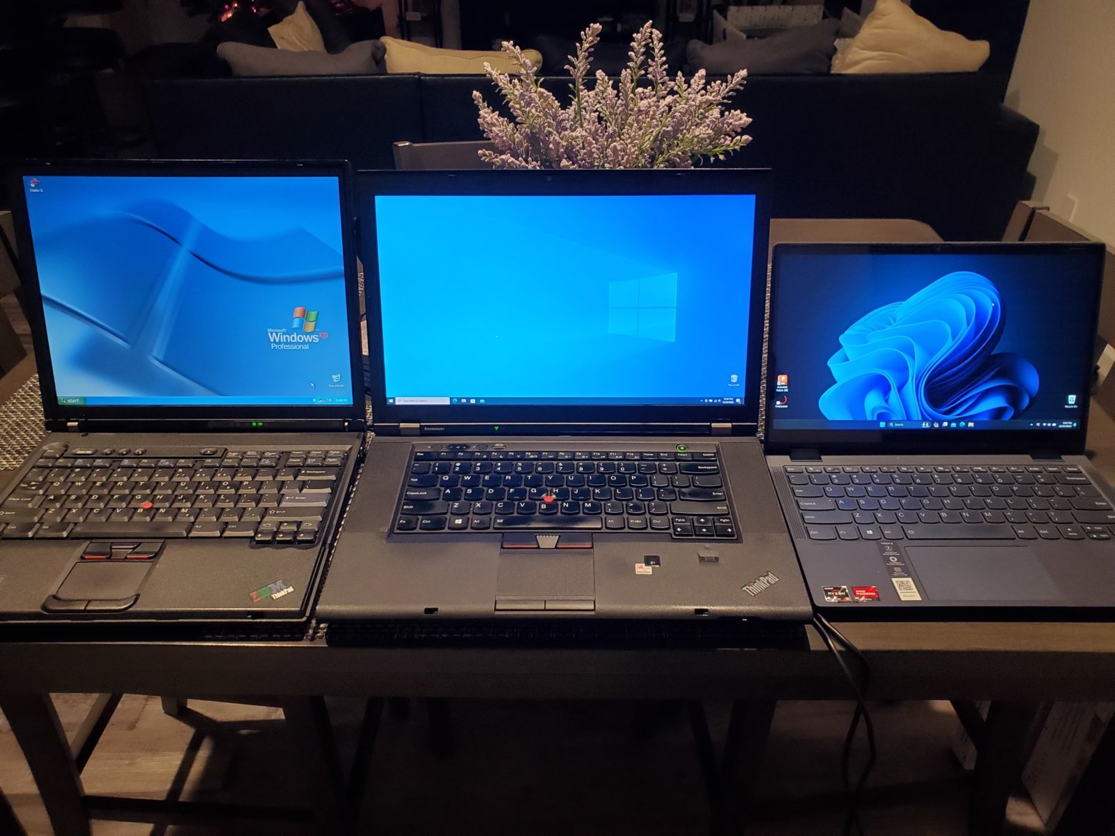

    Speaking of IBM :anonymous:
    Far left one runs as quick as a modern computer
    Middle one just got an SSD upgrade some days ago
    This was on it's last leg, now she goes from off to desktop within seconds
    Far right one lives performing CNC duty
