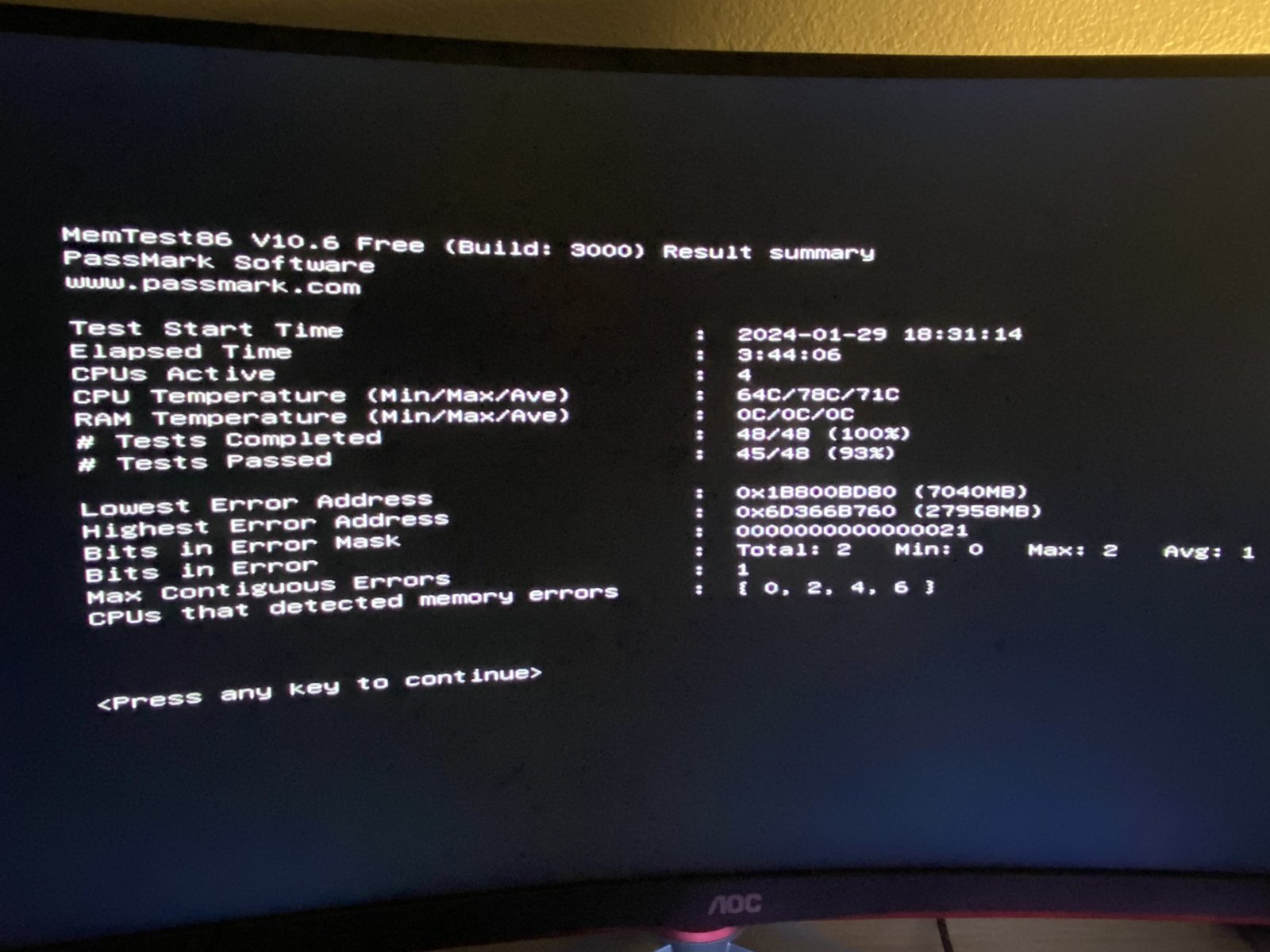

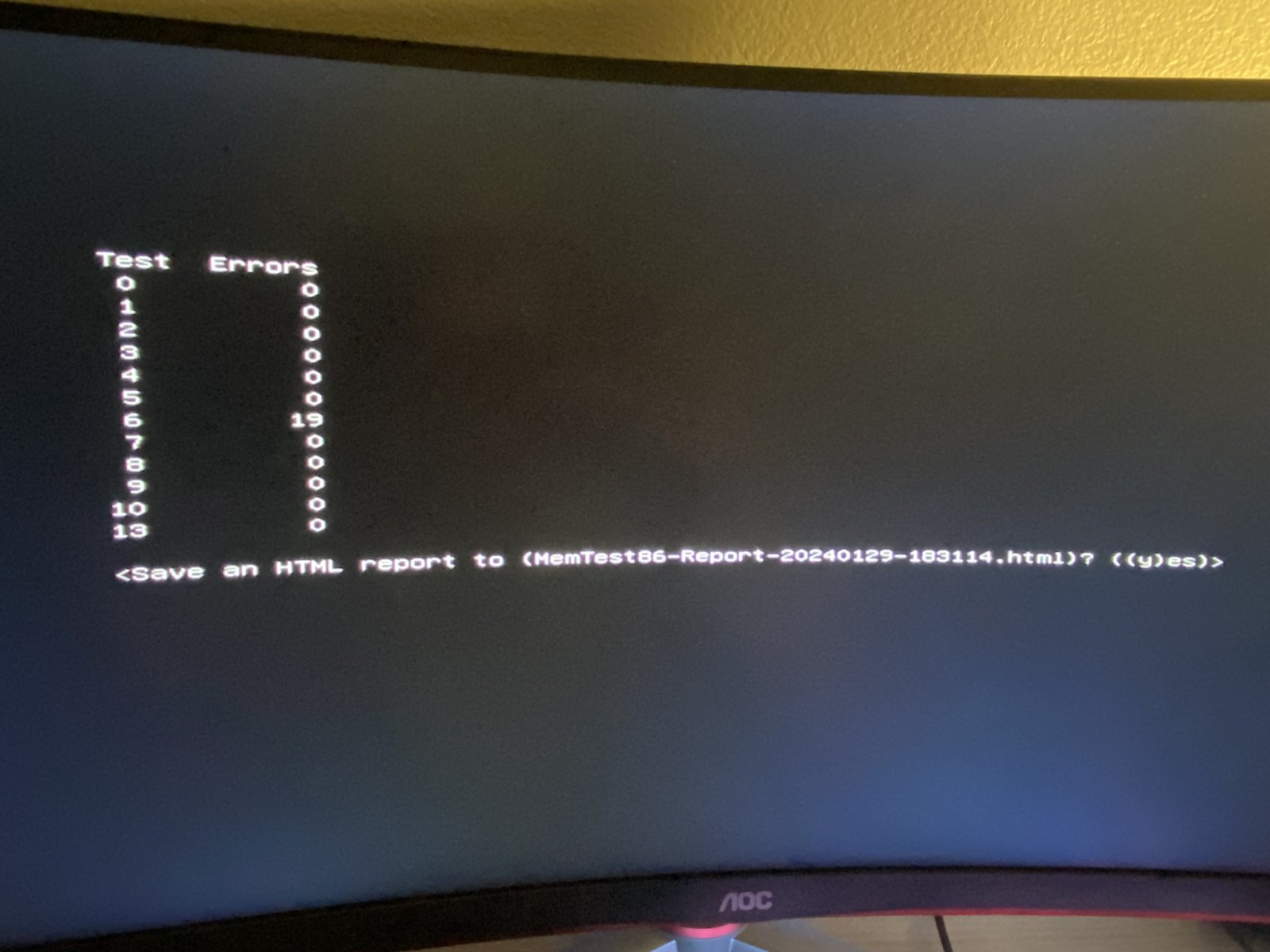

    I mean I did fail the memory test but not horribly.

    Rerun the tests, a module that fails a test can exhibit what you're experiencing

    I heard. It’s just frustrating lol. So if I run the memtest again and same results, do I really need new ram if it’s only the one early access game causing the issue? That’s where I’m on the fence

    Memory errors are bad. All it takes is for the system to try to use that block of memory, and you may get some type of error.
    I'd run the test a few times and note the memory location that it sees errors. If it's the same, you have bad RAM. If it moves around, it could either be bad RAM or something wrong with your motherboard. You may want to set BIOS setting to default (not sure if you tweaked anything there) and run the test again. Sometimes using the XMP settings puts the memory too close to the edge of what it is capable of.
