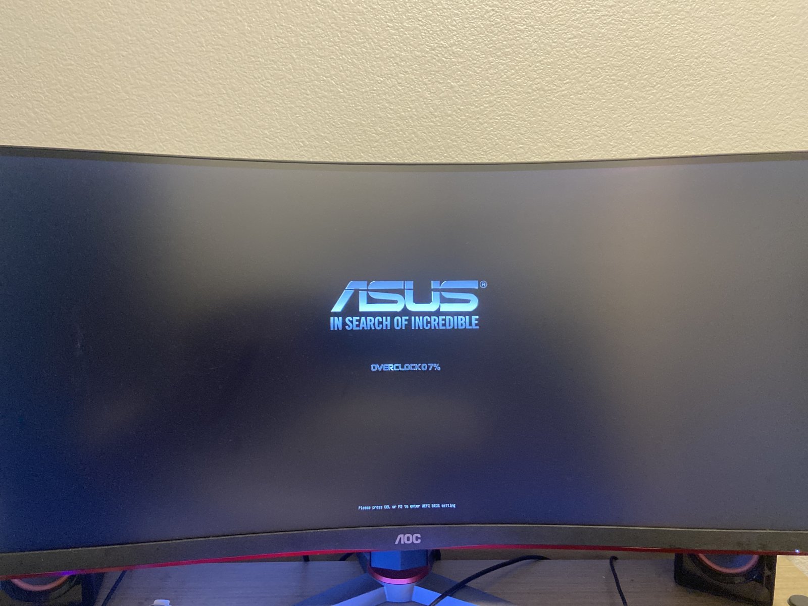

    Well I tried re running memtest. Wouldn’t work doing same thing as last time. Frustrating. So I consult Reddit. Someone said disable CSM cus it was probably trying to boot from hard drive instead of the USB I kept choosing as boot option 1. Welp
    Now I turn on my PC and press f2 or delete and it won’t even go into BIOS. Did I just brick the CMOS battery or something?
    stuck on this screen. Don’t even have the usb with memtest plugged into it right now.
    I don’t know why it wouldn’t just run memtest from the same USB as the other day when I’d press F8 for boot select and choose the USB. It would then just go straight into windows

    Unplug PC
    Reset CMOS
    Plug in PC
    Boot, load optimized defaults or whatever is suggested

    Not having the manual slows down being able to find the cmos short pins and the switch lol. I resorted to just removing the battery and putting it back in since I knew where that was. Just meant I had to take out my graphics card to get to it lol
    It appears the issue was the formatting of the USB? Even though it worked last time. I re formatted to FAT32 not just “FAT” and mem test started exactly as it should’ve.

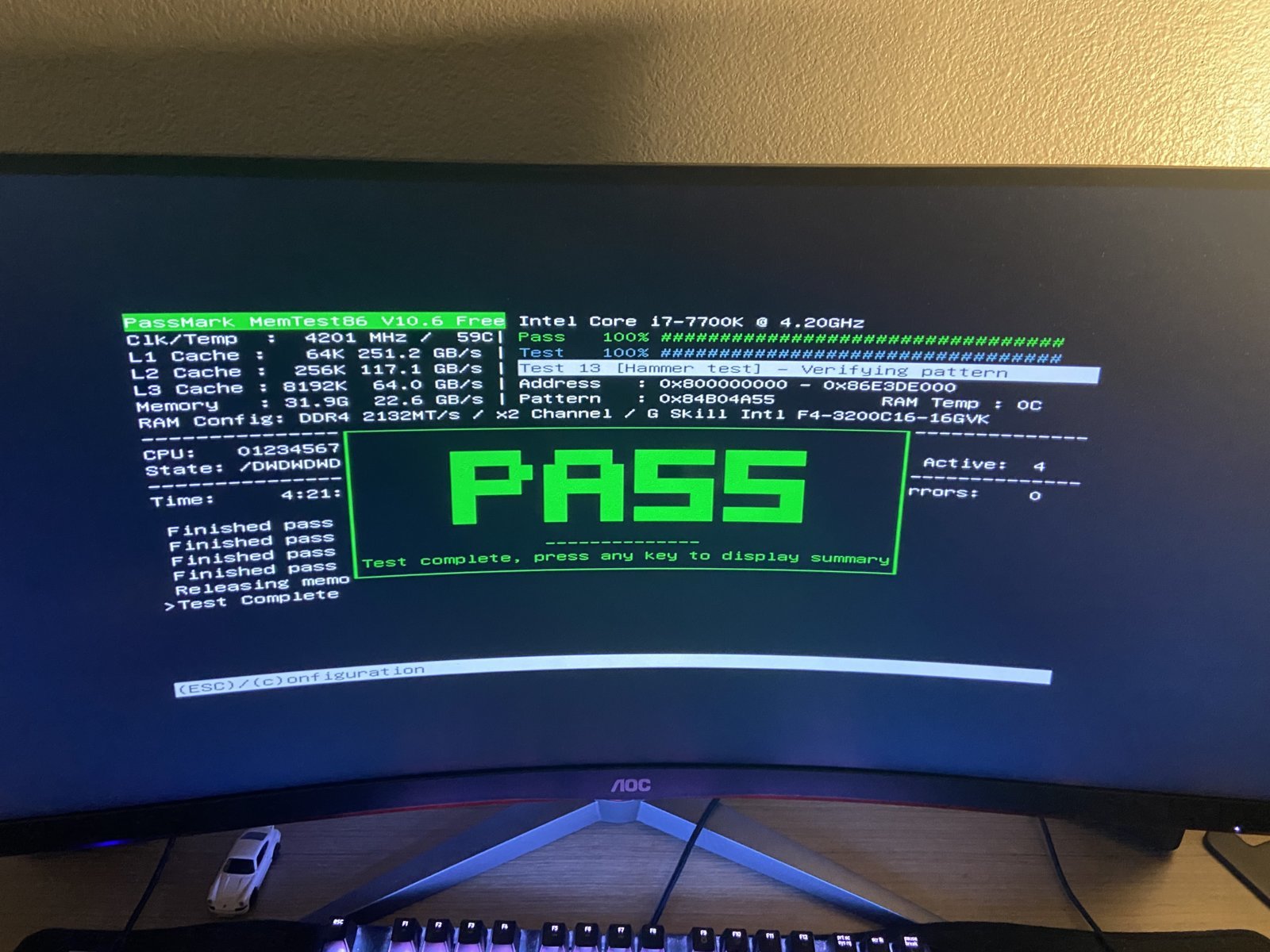

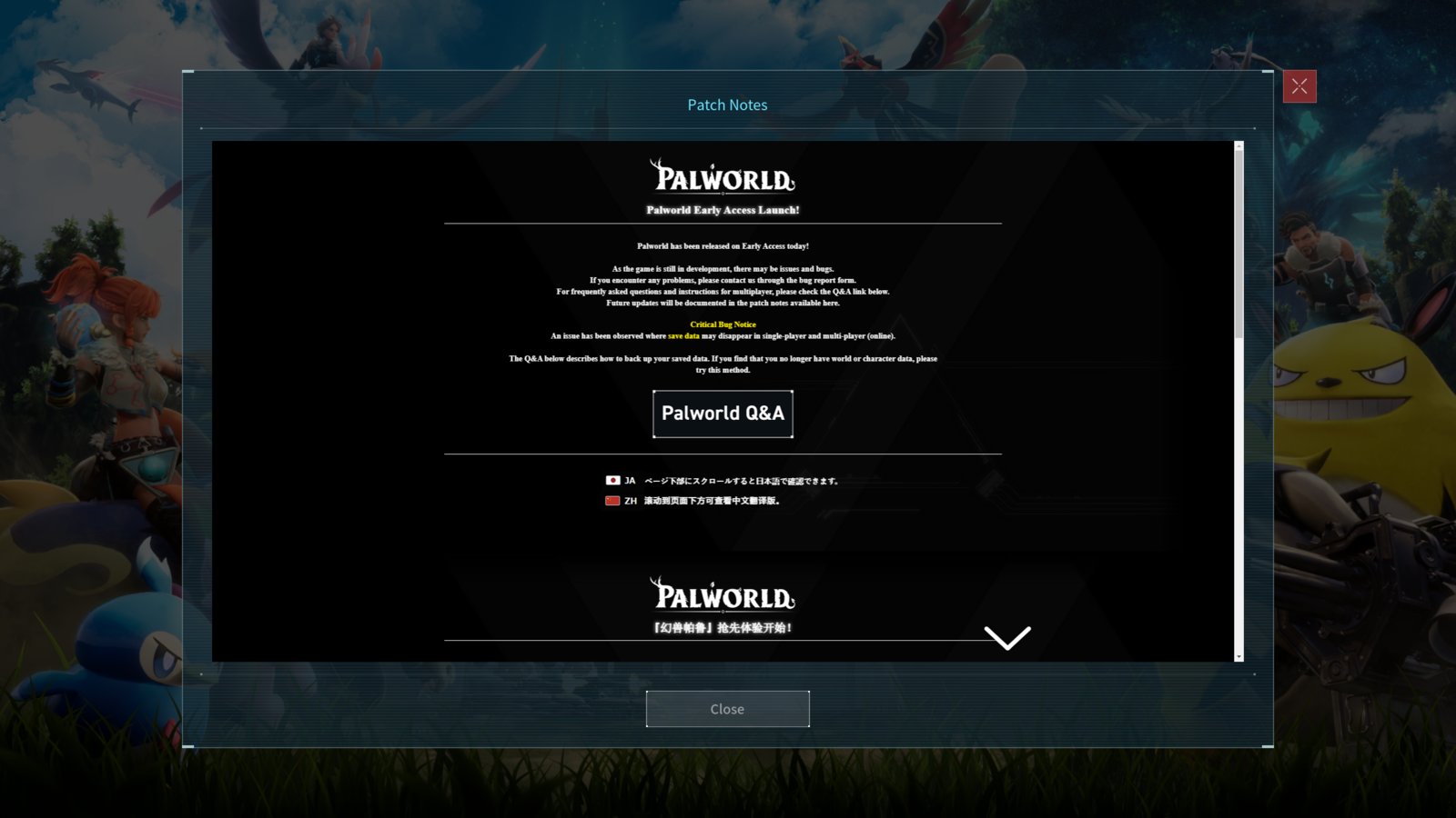

    Already said it, stress testing components is the easiest way to start diagnosing stuff
    Memtest already showed an error, running it to the fullest and confirming the same errors would rule out a bad module as already mentioned
    On top of that, since I only repeated it a few times, those disclosures about early release warnings

    Second memtest should be done now. Will see results when I'm home from classes

    I'm not a big fan of MSI. They have good prices. You get what you pay for. My daughter's boyfriend built his with an MSI board and it was a bit problematic getting it going. I won't buy their products.
    If you have older USB 2.1 ports (not the blue ones), you might try using those for booting from USB. Potentially slower, but you probably won't notice anything.
    Liquid cooling is not necessary unless you are significantly overclocking things. Looks really cool if that is what you are going for with your build, but if you just want a reliable PC, air cooling is still where it's at. Most stock fans are enough, but there are some really good air coolers you can get for cheap that bring temps down even further. You can get a Thermalright Peerless Assassin for $34 on Amazon and they work great.
    But again, if you ONLY get crashes while Palworld is running, you have likely found the culprit.

    I’ll run a 3rd time tonight. And agreed liquid isn’t needed for simple setups. I’m loyal to noctua fans. I think noise:air moving ratio is solid with them and they last.

    Just logged a solid 2.5 hours of palworld no crash. I limited FPS to 90 instead of 120. boohoo. Turned off anti-aliasing all the way. Verified files in steam. And ran it with dx11 instead of whatever default was. Performance looked basically identical to what it was. And no crash. Works for me. I just took everything I found on reddit from r/palworld that people said worked for them and did all of them. so no clue which helped me but it worked. hooray

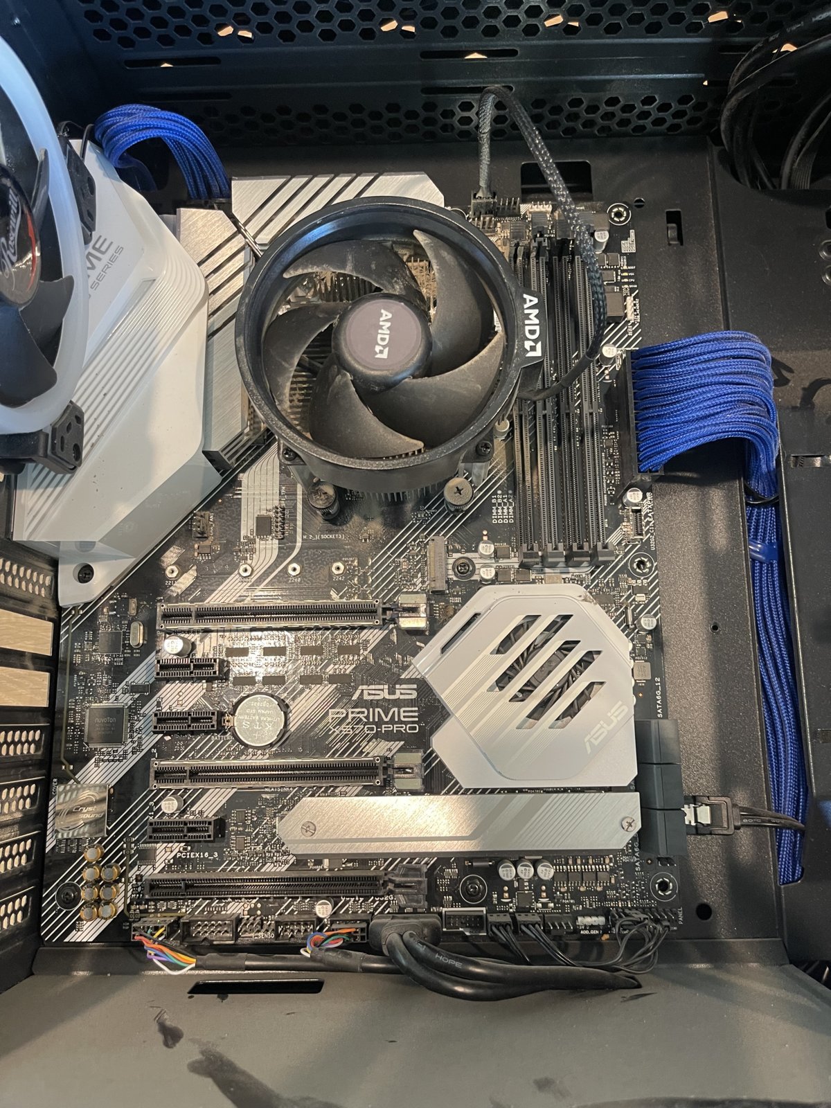

    Had a mobo go out on me after only two years pretty cool Asus and a stick of ram
    Switched it out today with a Msi 550. And two new sticks of ram
    Definitely out of the loop computer appliances had to ask a buddy this go around lol

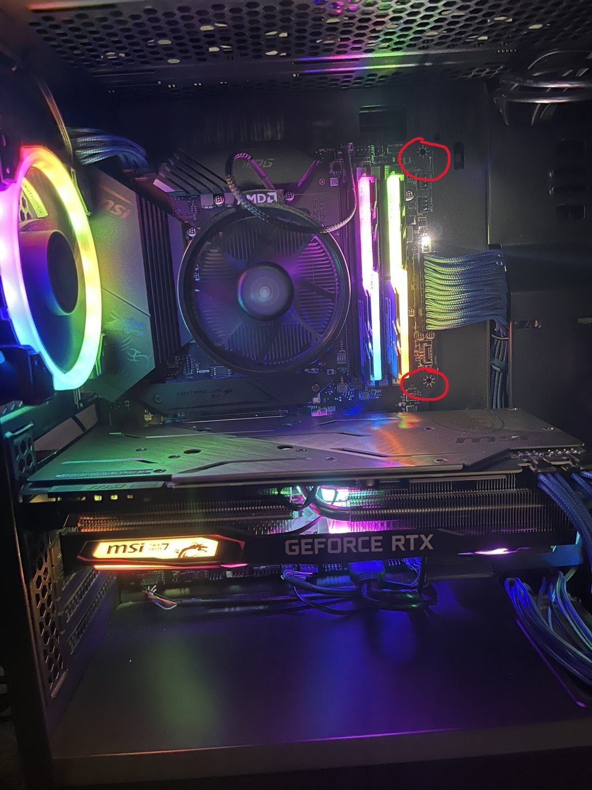

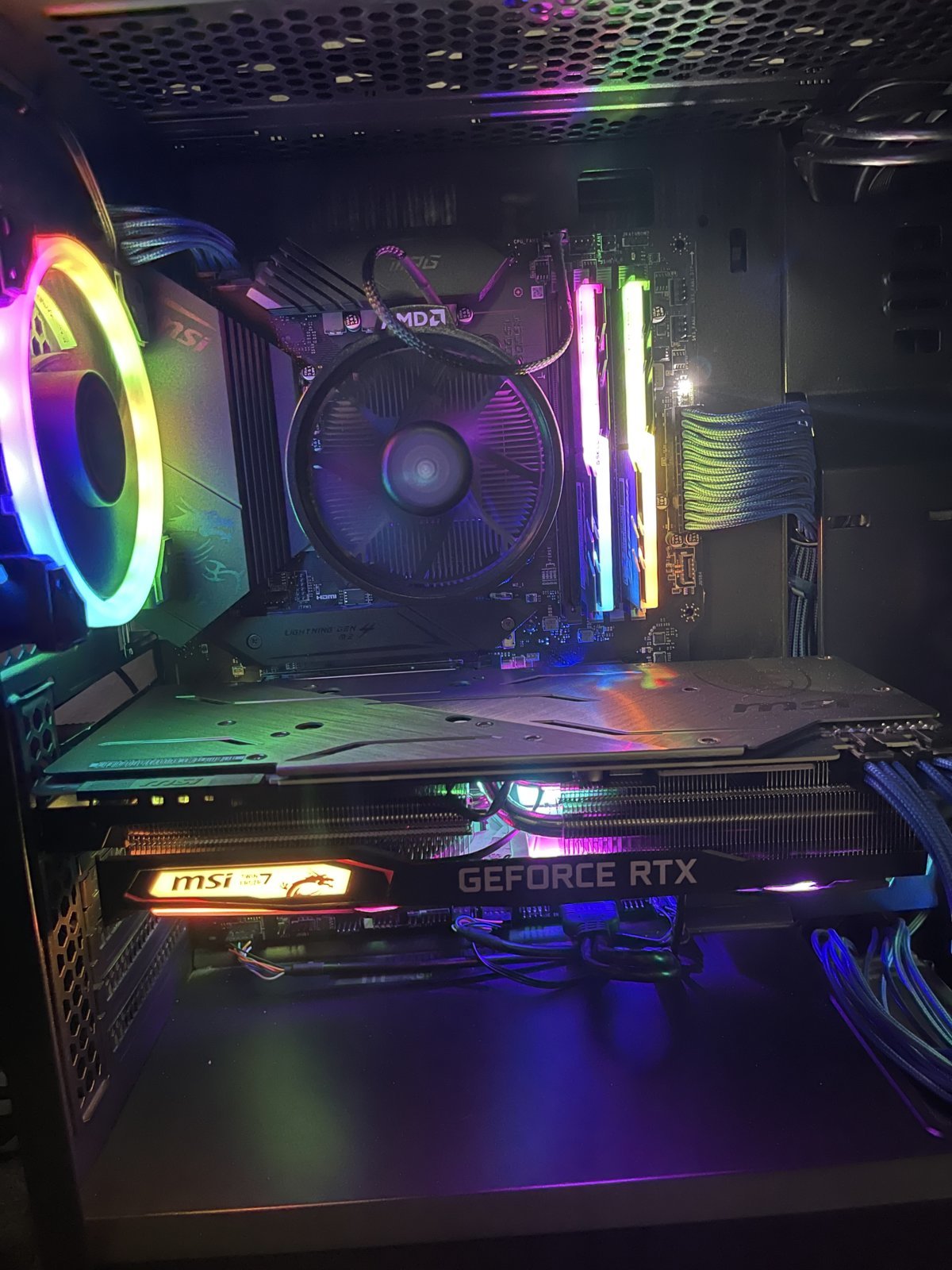

    The switch. Worked fine last night all night long. Now it won’t boot and my cpu light is on. :(

    Most motherboards have some indicator light or display for any 'issues'
    Did you reboot and try to access bios?
    Maybe it's running fine and it's just video not being output, try your mobo's video out? Or another video out on your GPU?
    The fact that it turned on and stays on means it does post otherwise it would reboot automatically in an attempt to post (some mobo's do it up to 3 or 5 times)
    By the way, you're missing some screws or stand-offs even for your screws :anonymous:

    Would the standoffs have anything to do with it? I noticed that too. Also I didn’t try another video out for some reason but the light stays on cpu. I’ve read that a solid cpu light means an error? But can’t figure out how to get that away. It doesn’t boot to bios it freezes at cpu I reseated my cpu twice since the last post. I also replaced the psu thinking maybe it was underpowered. So far the only thing I haven’t replaced is the gpu and cpu lol

    Your motherboard manual will tell you as every one is different.
    If your PC was working yesterday, last thing I'd be doing is pull the CPU out multiple times as you can risk bending a pin on the motherboard or CPU however AMD does it.
    Did you reset CMOS and attempt to boot again?
    And again, different video output as it could be booting but you're not seeing any video output as you haven't tried any other ports.
    Always start simple before going full blown taking things apart.
    As for the stand offs and screws, I wouldn't have installed a motherboard without them. Why'd you skip them? You have some weight hanging on your motherboard just because of the video card alone...I'd want everything bolted up and in place securely.
