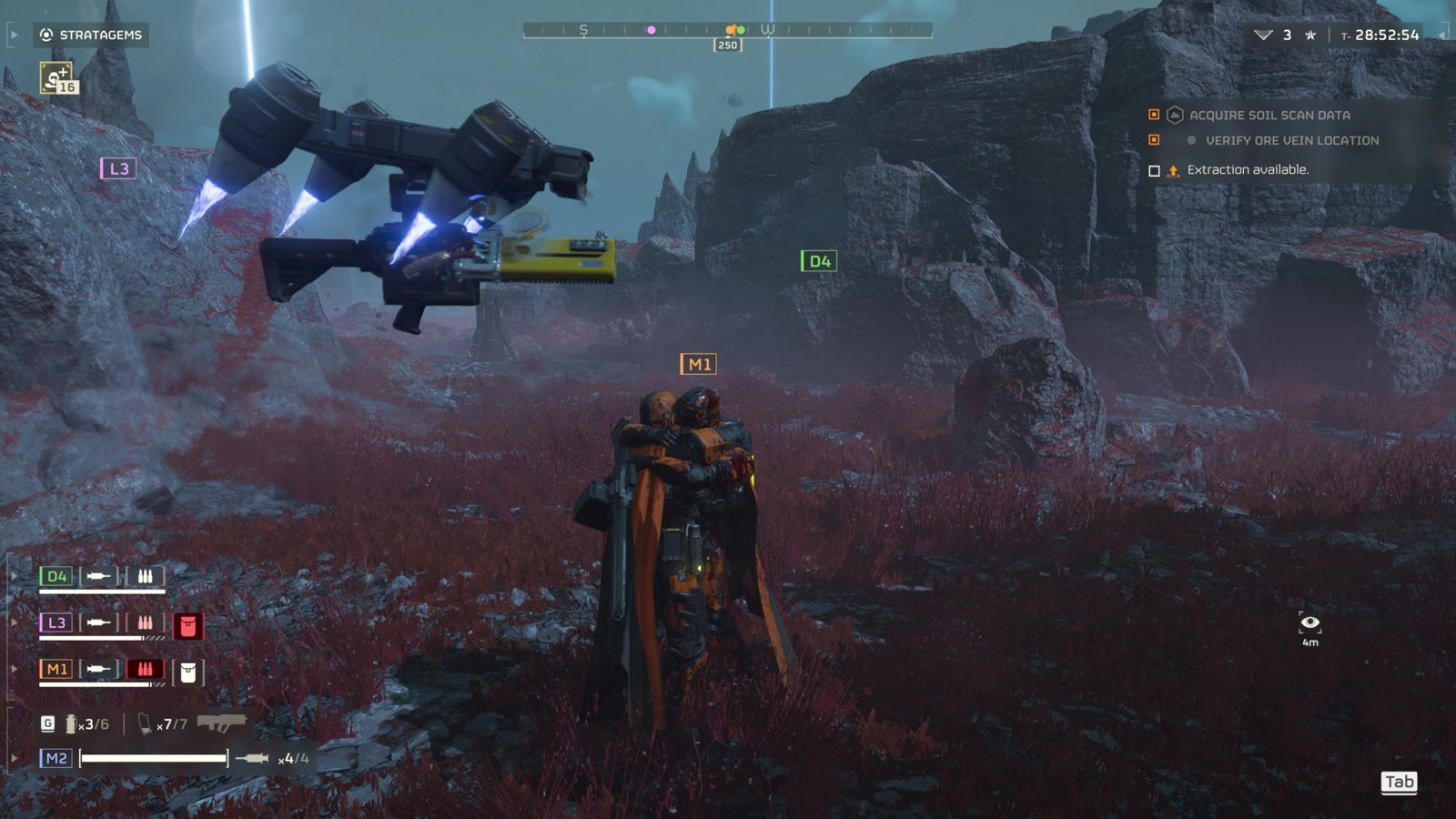

    Well, I'm trying to put together a team.
    Most others already playing have their groups so if you decide to jump on :burp:
    There's bugs to receive your payload of Freedom
    ICBM's for launching Democracy
    And various settings to enjoy your Liberty
    But it wouldn't be complete without your fellow Helldivers doing those things alongside you
    Do your part, and join the fight :muscleflexing:

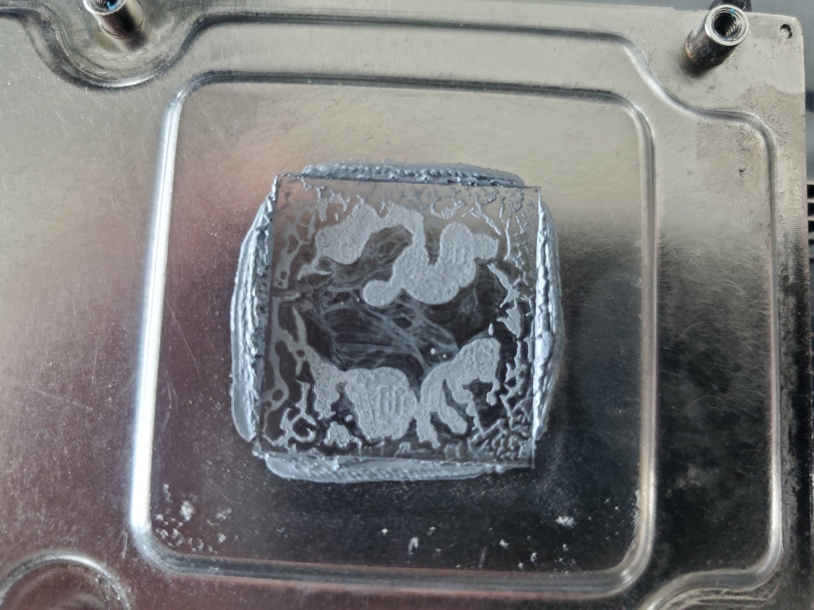

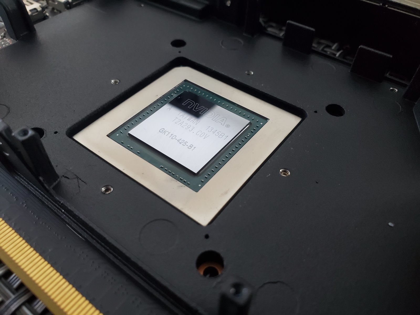

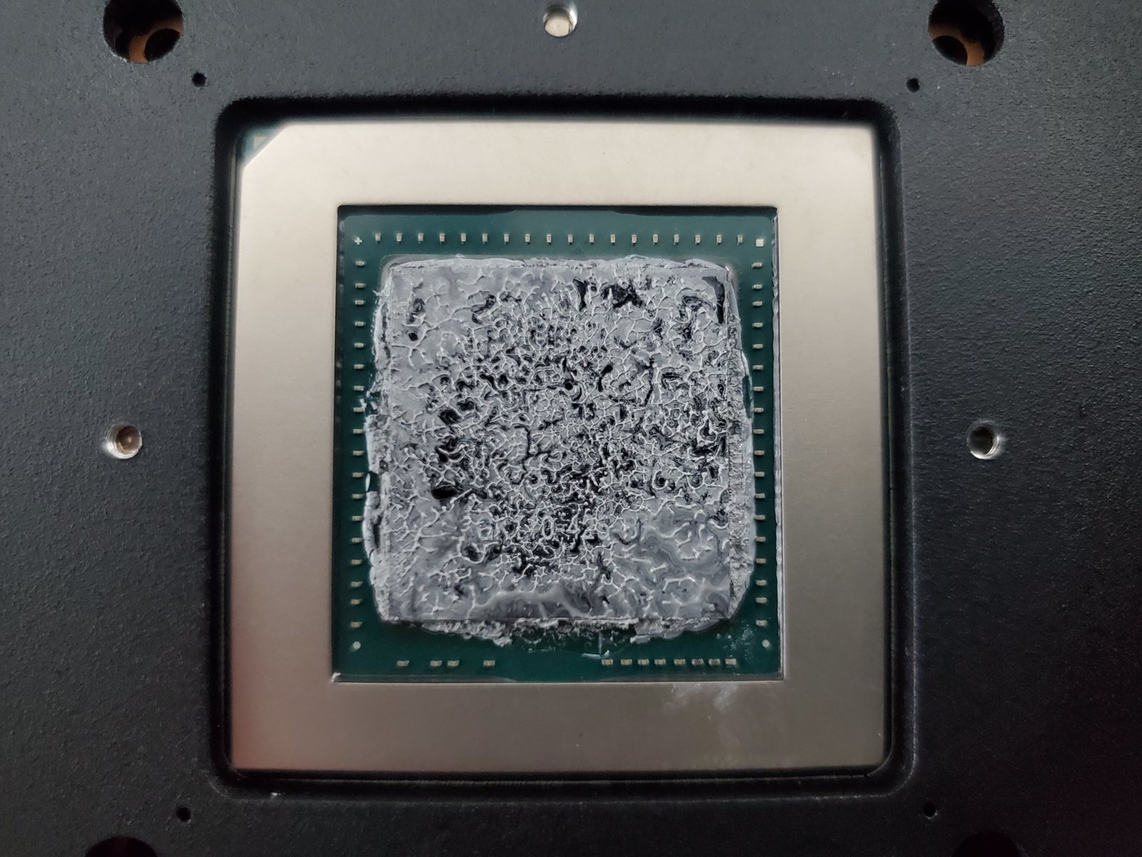

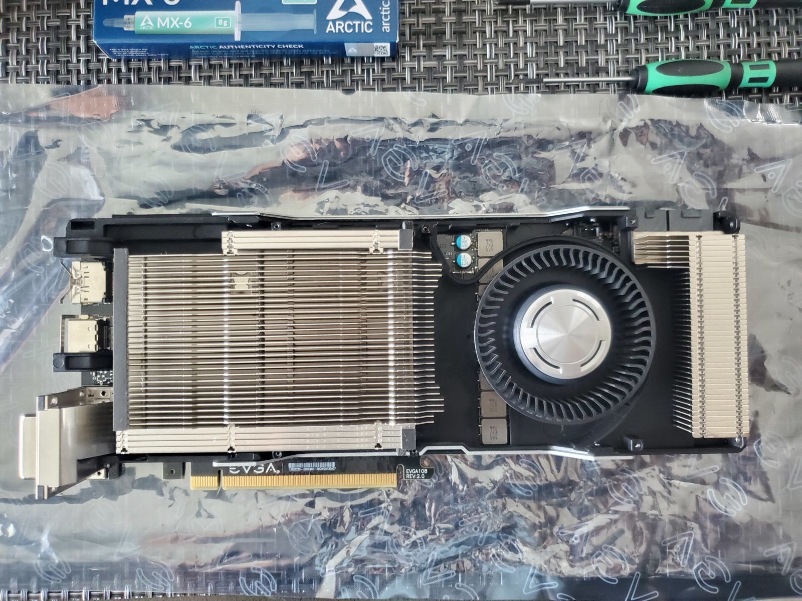

    Second reference card done; what's funny is the factory paste was done much better on this one than yesterday's
    They look so pretty when they're clean
    Only 5 more to go :bananadead:

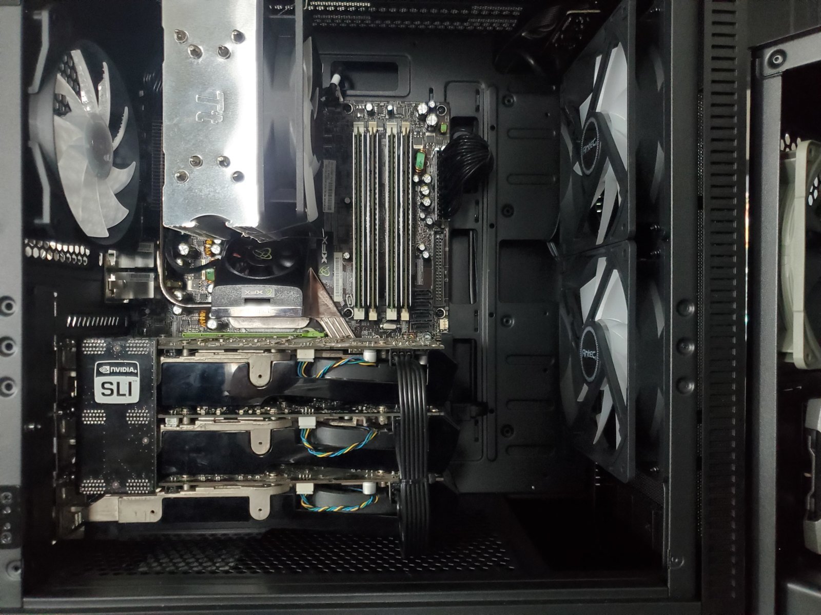

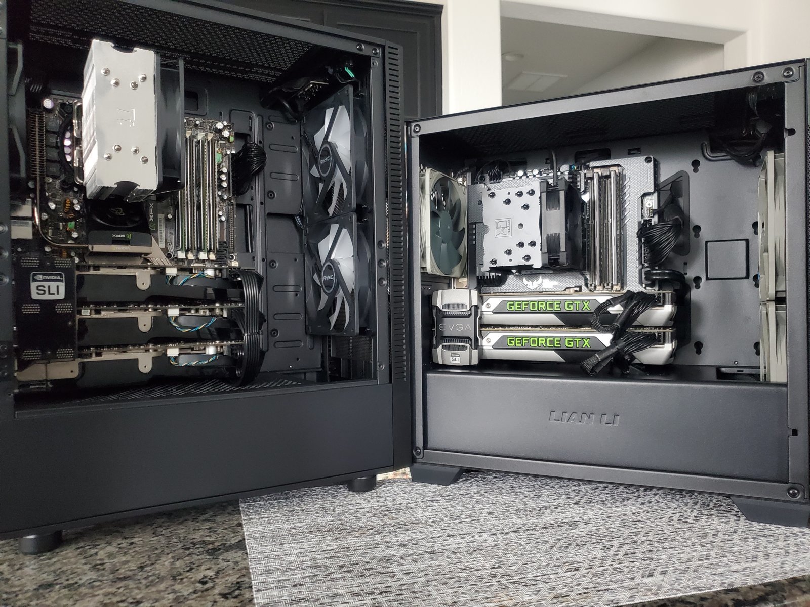

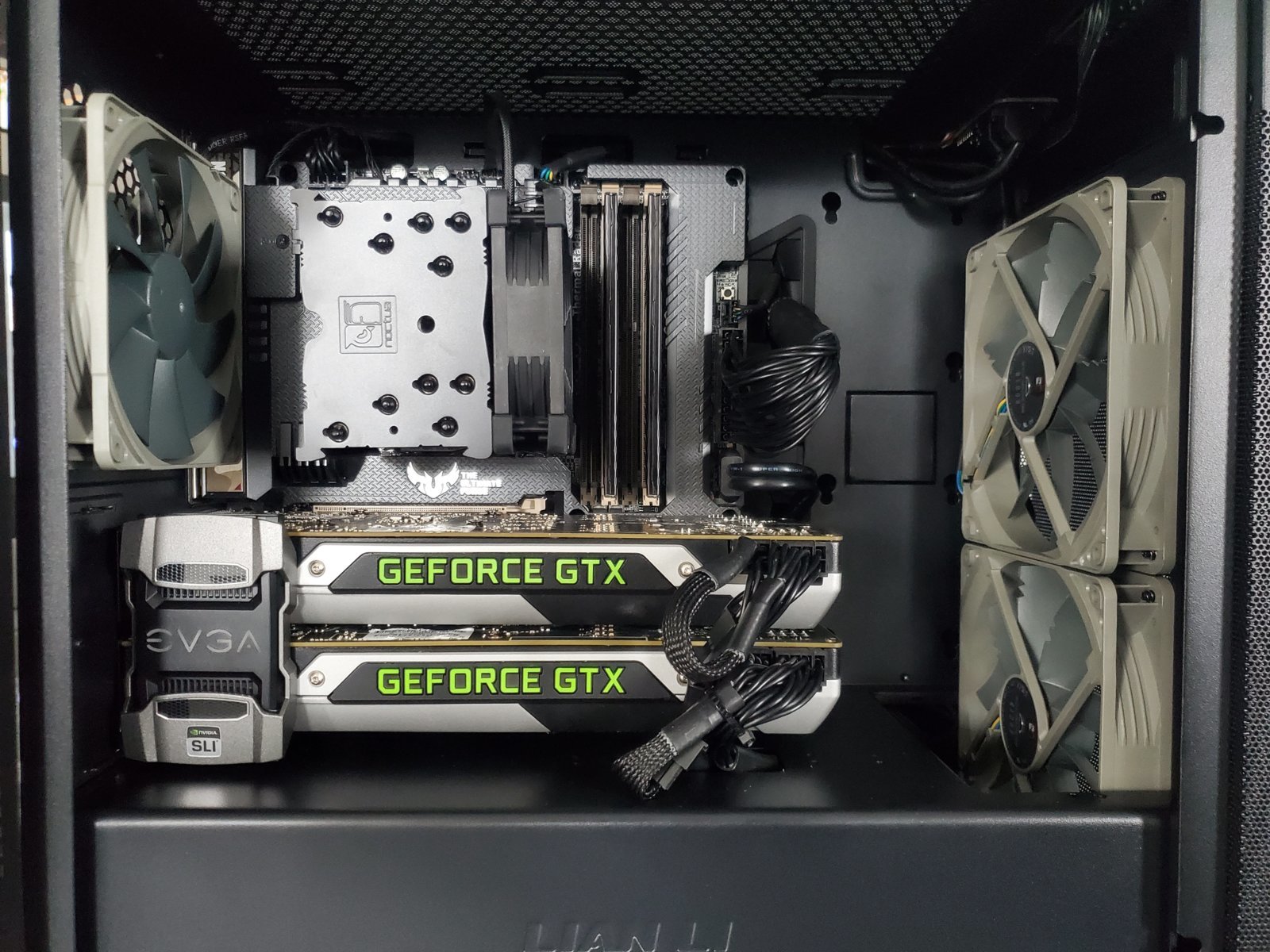

    Second SLI build done
    4770K on a Z97 Asus Gryphon, 32GB Corsair Vengeance DDR3, 1TB Crucial SSD, and 2-Way SLI GTX 780TI powered by a Corsair RM850X
    Noctua CPU cooler and fans all around
    I never personally owned a build for 2018 which would've been an AMD 2700x/1920X or Intel 8700K/7900X; my 6700K replaced the 4670K I had and lasted until last year's 13600K build
    2008 and 2013 alive again
    What a difference 5 years makes

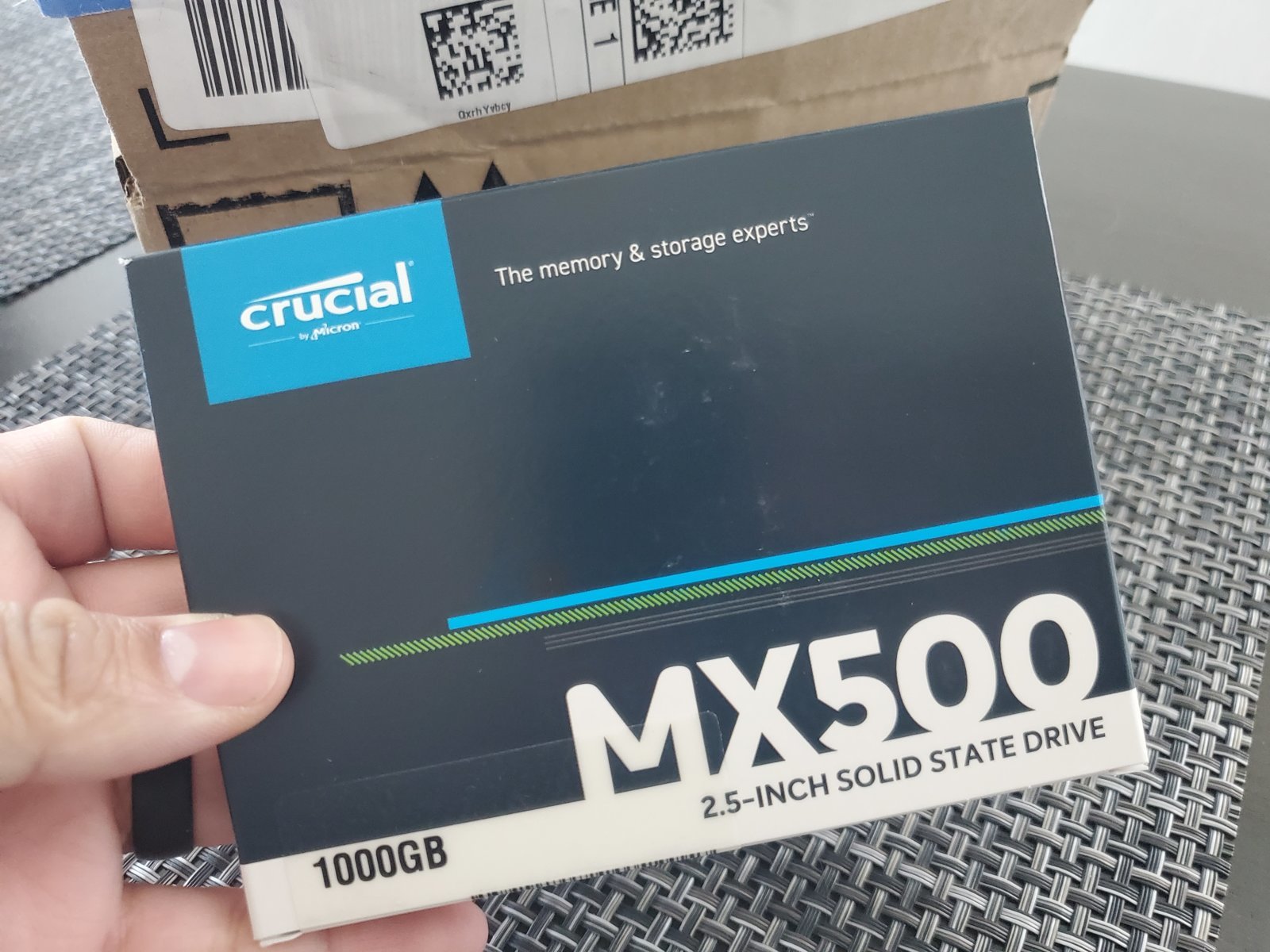

    I normally run m.2 Samsung Pro drives, 3 in my main PC but these are great for extra space or just using them as an HDD replacement in an old system
    My 3rd one so far, 1tb can be had between $48 to $54

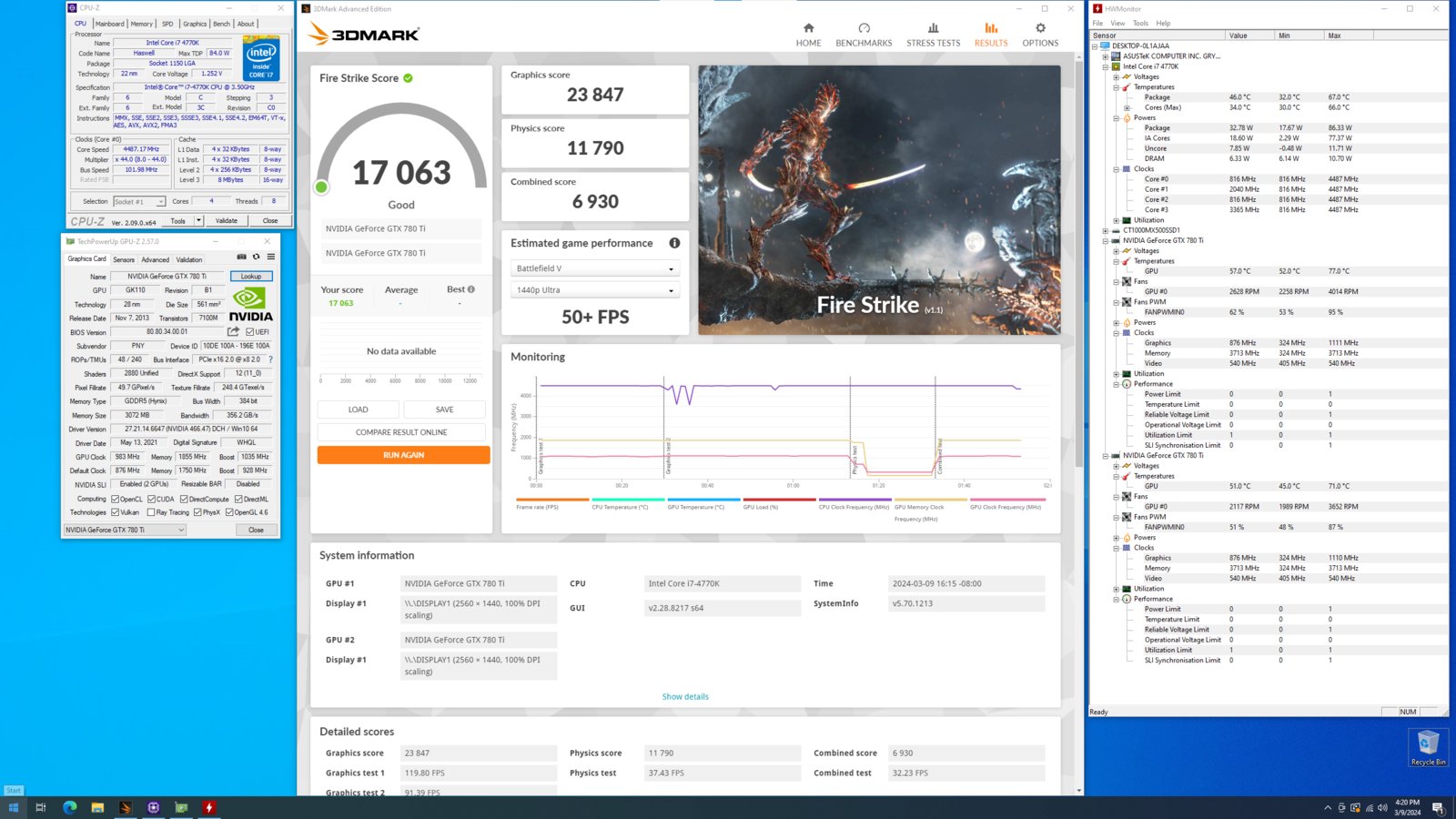

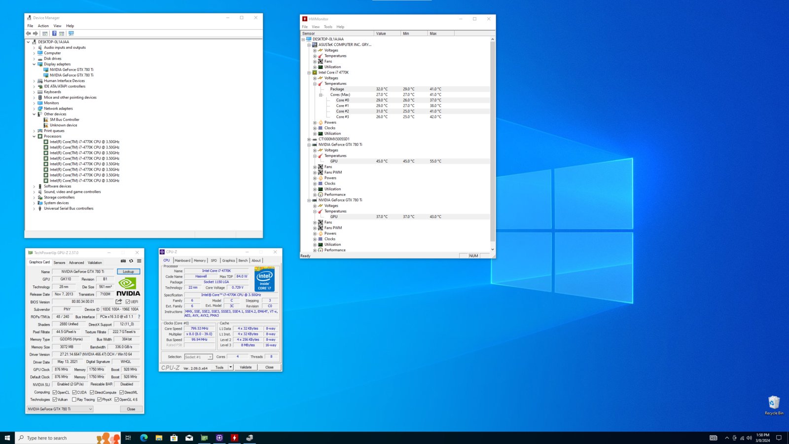

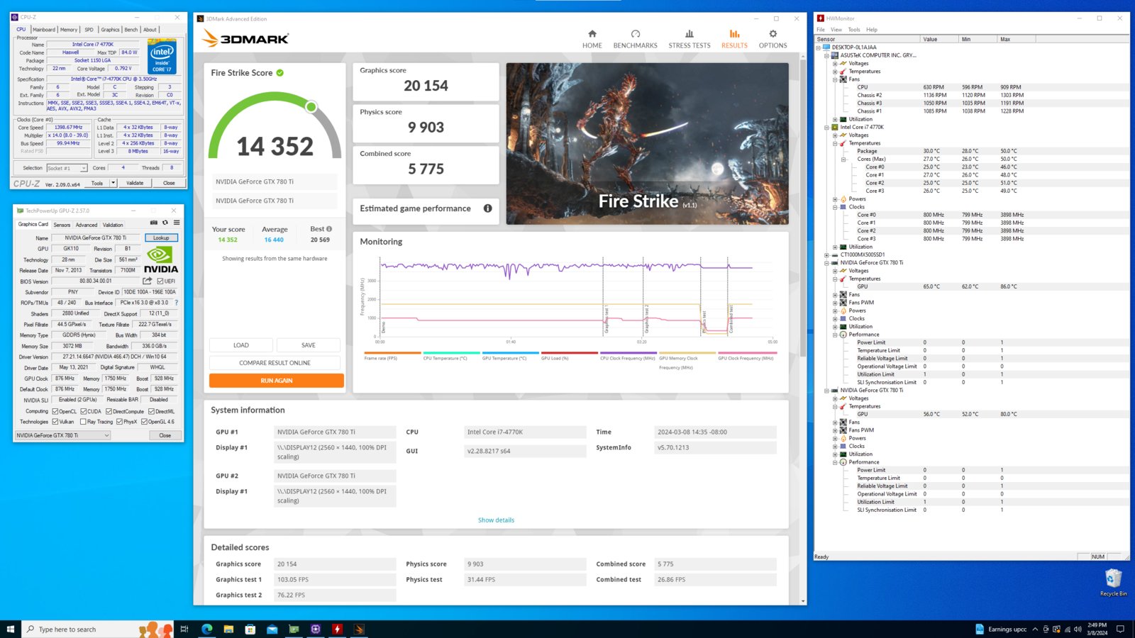

    Drivers downloaded and everything ready to go; I'll run some stress tests followed by testing some old games but so far so good!
    First GPU is a tad bit toasty though compared to the second one :rofl:
    Edit: Did a simple 3DMark Firestrike, running lower than average but it's because my shit is running hot...specifically that first card
    On another note, the damn CPU runs cool as hell with that Noctua cooler

    Didn't you refresh the thermal paste? I had to do that on my daughter's old 1080 once, it was crusty.
    I went with a Thermalright Peerless Assassin on my current build, great performance for under $40. No reason for me to go liquid.
    Kwikvette[QUOTED] likes this.
  11. Mar 8, 2024 at 3:10 PM
    #5751
    Kwikvette
    Feb 27, 2019
    #284735
    81,580
    Fresno County
    4 run, 2 don't
    I did, on both
    But if you notice, the GPUs have only the tiniest bit of breathing room :bananadead:
    Funny thing is, people report these temps running a single card so I don't think I'm doing bad at all!
    Temp target is 83
    Fan curves need adjusting; will set to about 100% at 75
    Max temp is about 95 so we're golden!
    That Peerless Assassin btw was on my list, it just wouldn't fit my setup though.

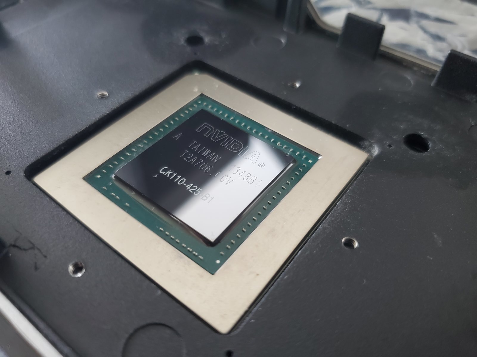

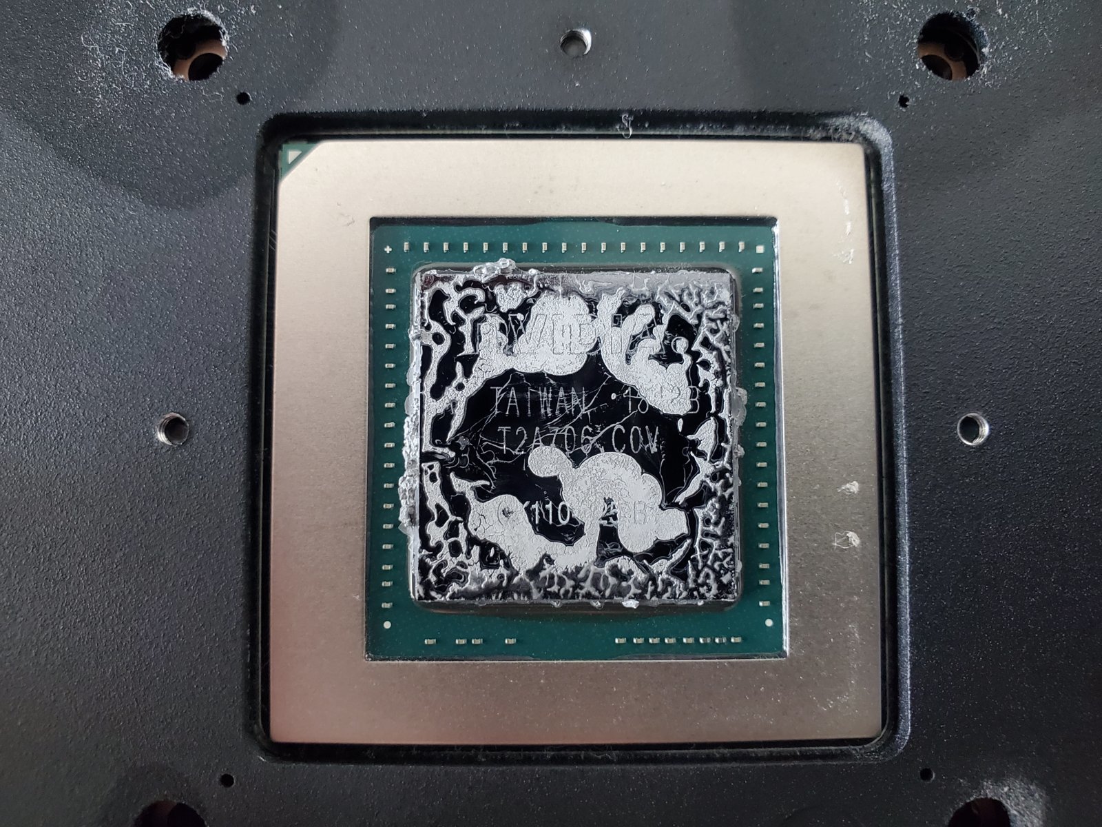

    Third one was even worse than the first two
    Fresh and ready to go

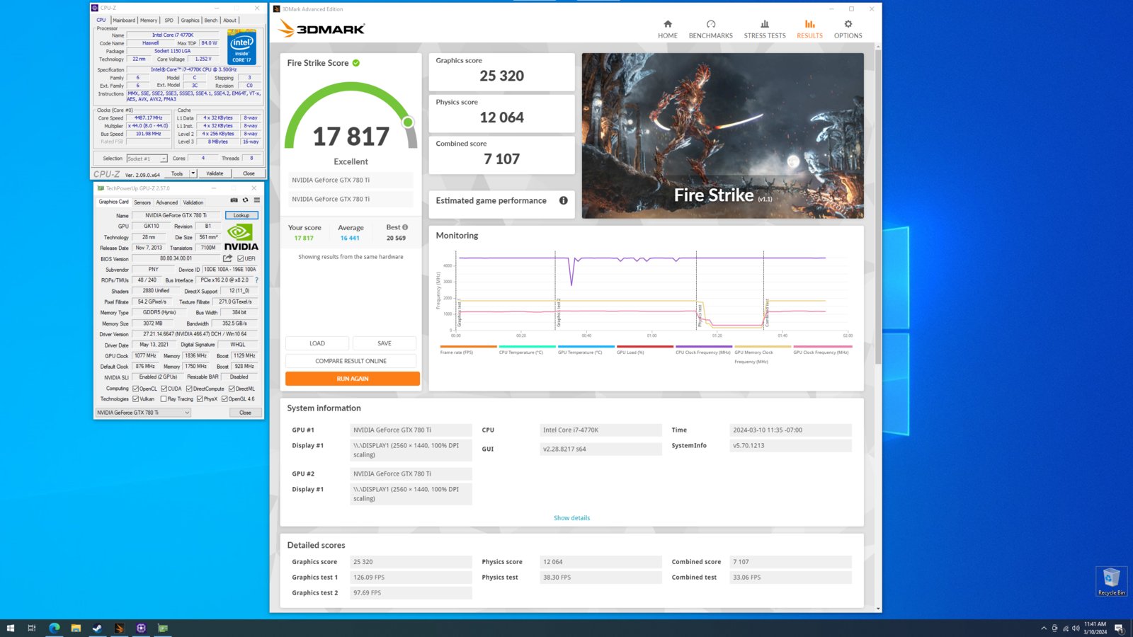

    Small overclock; CPU now at 4.5ghz (over stock 3.5ghz)
    GPU fan curves adjusted to 90% at 75 degrees and 80% at 65 degrees
    She was definitely roaring during 3DMark but she's running cooler and scoring higher
    And this one is after overclocking the GPU's a bit as well

    Sometimes when I do a build and stress test, I like to push to keep to a certain temp and no higher.
    Thinking later today I want to push the 780's a bit more and see if I can get closer to the 17,500 3DMark; they have a capped voltage keeping the stock bios on them so worst thing that could happen is the PC crashes.
    Edit: Done, the stable OC rests at -
    That's a complete 24.1% improvement over stock; 25.6% improvement on the graphics side and 21.8% on the cpu side.
