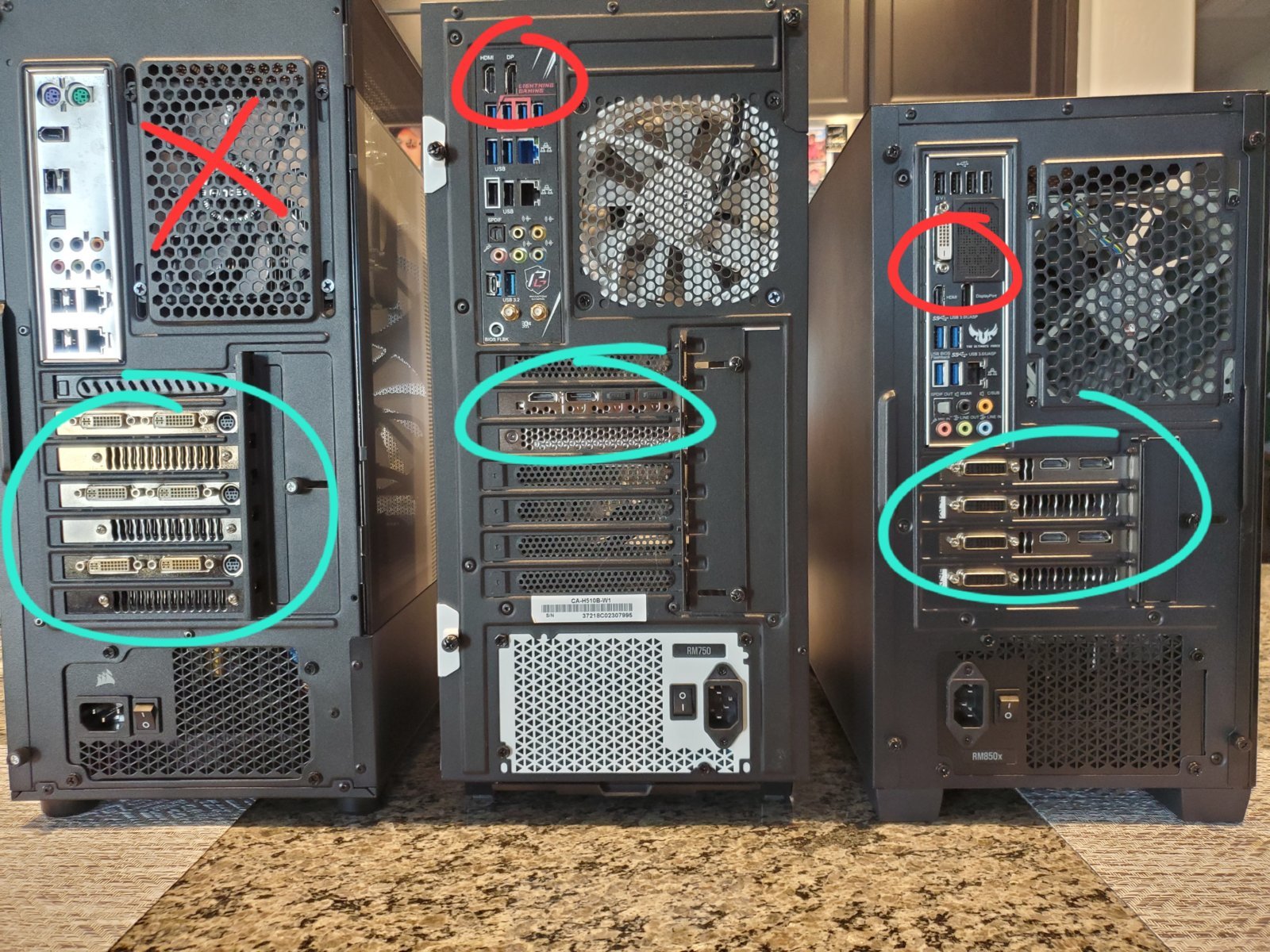

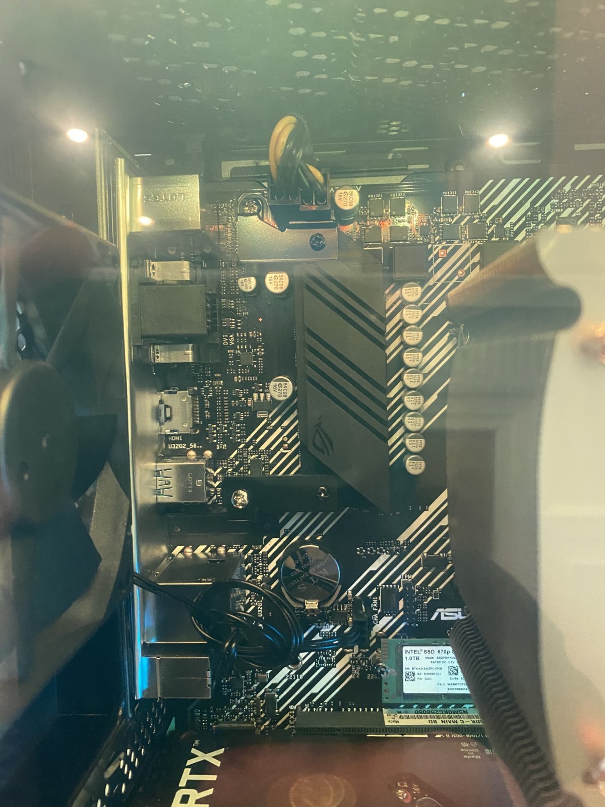

    I know this is noob 1.0 level in here but my job asked me to set up some ASUS ROG STRIX machines to do 3D printing. Any suggestions on doing this? I’m getting the first one booted up already. For some reason the top HDMI port didn’t send a signal to the monitor but one of the other lower two did.

  6. Jun 12, 2024 at 9:16 AM
    #5866
    Kwikvette
    Feb 27, 2019
    #284735
    81,359
    Fresno County
    4 run, 2 don't
    You mean the HDMI on the motherboard? With a graphics card installed, some motherboards default to the installed card and disable the on-board output.
    This can remedied by forcing it enabled in bios or even in the computer itself, or uninstalling the graphics card.
    Just use the graphics card. You gain nothing using the motherboard's output (which uses the cpu).
    Dalandser[QUOTED] likes this.

    Yeah that was it it sounds like.

  9. Jun 12, 2024 at 9:25 AM
    #5869
    Kwikvette
    Feb 27, 2019
    #284735
    81,359
    Fresno County
    4 run, 2 don't
    Back then, a lot of cpu's didn't even have built-in graphics or some motherboards didn't have the chipset to support said graphics.
    You'll notice in my pc on the far left, I placed a red X because there is no on-board graphics
    The center and right one support on-board graphics provided the cpu used has integrated graphics. This can be helpful when diagnosing a computer and you're pulling components out (such as a graphics card for starters).
    In cyan, I circled all the available ports from the graphics cards that are installed in those computers.
    Robnik and Dalandser[QUOTED] like this.

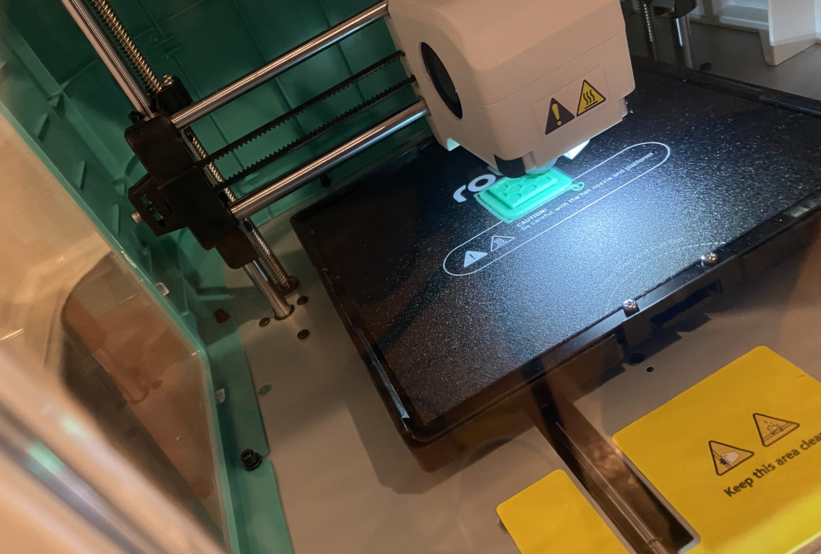

    Thanks it made total sense when you said that. I’ve been on the fence about building a computer for 4-5 years but all my work relies on the Apple ecosystem with iPads and my phone so I never had the motivation to do it. Can’t say how many videos I’ve watched on parts and builds but still I haven’t had my hands on anything like this before. Gonna wait for IT to come by and put in the Microsoft licenses and I’ll study up on 3D printing until then. These are our printers - any experience with these?

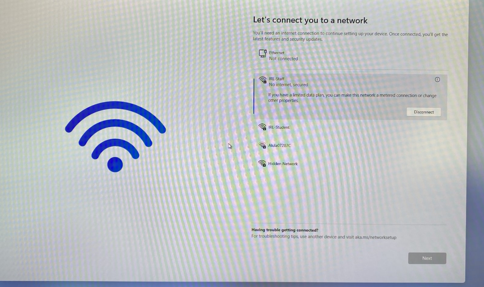

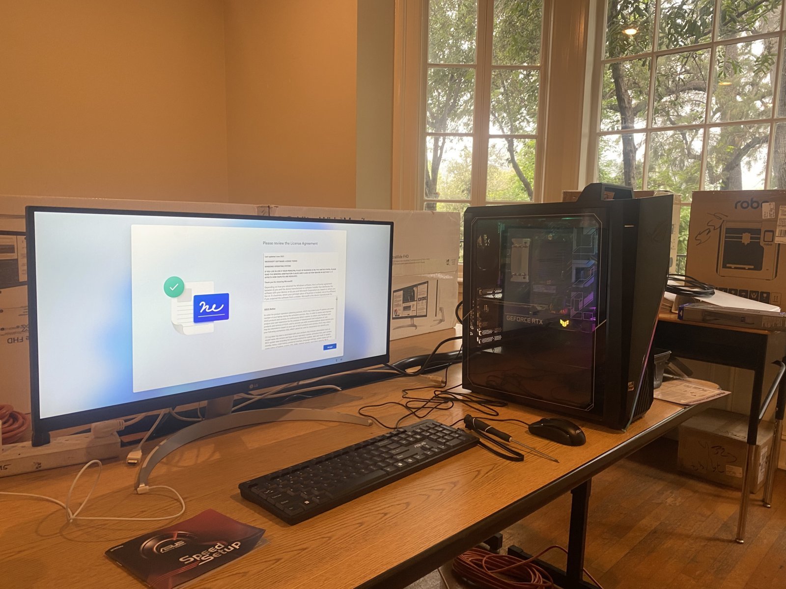

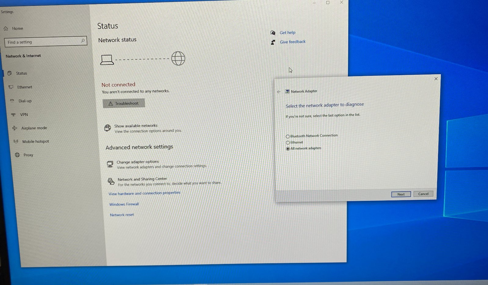

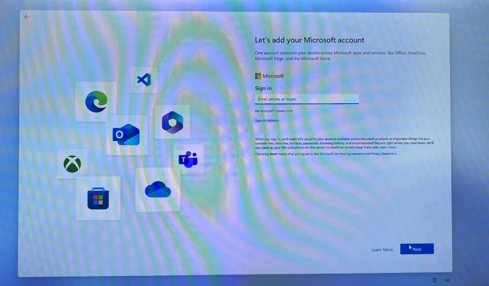

    Hey guys another noob question (and the director of my school told me that IT had told him to buy the ASUS machines as long as he got them one too - take that how you will).
    So I had all three machines connected to wifi wating for the Microsoft account sign in on this page:
    I called and they said they were going to have to come over and do something (they said they couldn't just give me a company account to log in with).
    I get here this week and only one computer is logged in and when I went to connect to the internet, there's no wifi options, only these options:
    How did they make the wifi option disappear? I had all three connected last week before being able to sign into Microsoft. Then when I went to another computer, they had actually gone backwards in the steps I had already done like naming the computer and when I got to the connect to wifi page, I found this:
    The wifi network "IRL Staff" is the very same one I'm posting this from on my mac. Any suggestions?
    On a positive note, I got our "Playschool" printer going
    So that's a partial win...
  18. Jun 17, 2024 at 10:44 AM
    #5878
    Nimble9
    Nimble9 visit squareonecreations.com Vendor
    Oct 20, 2015
    #167184
    11,157
    Lebanon, PA
    2006 4x4 DCSB
    enough to have fun
    Do the machines have a wifi card or a motherboard with Wifi?
    Is wifi turned on?
    A potential fix is to rollback the network adapter driver if an update they performed touched that potentially.

    Hard to say (I know what you’re saying but not how to identify)
    I connected all of them last week when I got to the screen for logging into Microsoft.
  20. Jun 17, 2024 at 10:52 AM
    #5880
    Nimble9
    Oct 20, 2015
    #167184
    11,157
    Lebanon, PA
    2006 4x4 DCSB
    enough to have fun
    It was on wifi last week?
    Can you share a pick of the back of the I/O panel?
    Is there an antenna?
