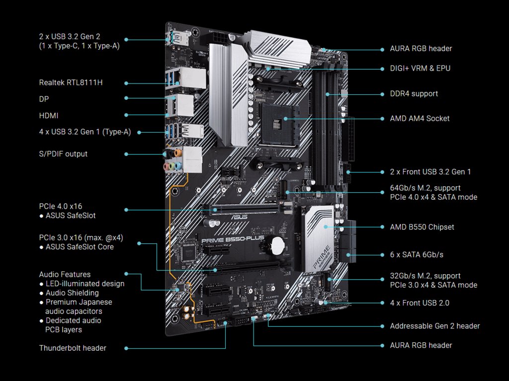

    Also I can't tell but, is that a GPU you have in the middle slot (hard to see on a phone).
    You'll want to run it at the upper most slot. Though I don't know what motherboard you have, age, etc.
    Edit: Found your motherboard, it's like I was saying above not all PCI slots run at the same speed (although some do for the first two).
    In your case, you're running an item on PCI-E 3.0 vs using the faster PCI-E 4.0 slot above it.

    Yeah top PCI-E is always the fastest. There are a few higher end boards that have a secondary slot at the same speeds as the top slot but it's rare.

    Yep!
    I had SLI/Crossfire back in the day so that's when I remember the middle slot being the same speed as the top slot. Had to look up his board to confirm if it was more modern or older.
    Those were the days...

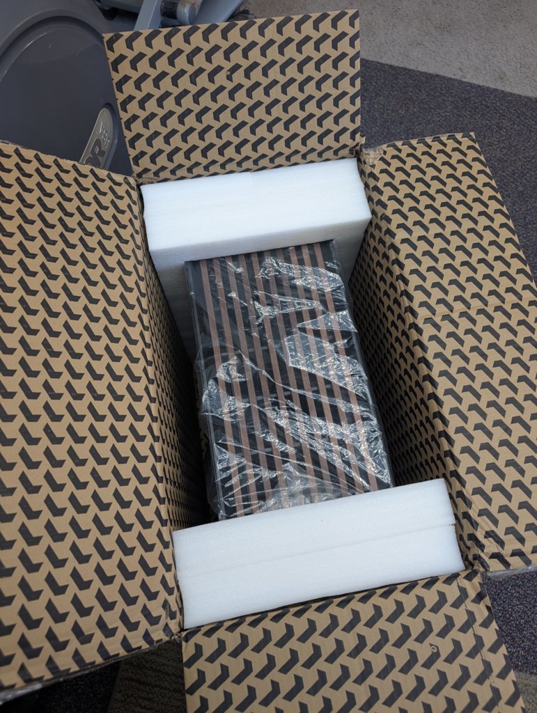

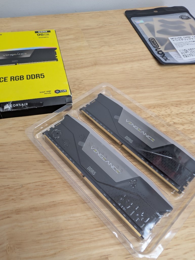

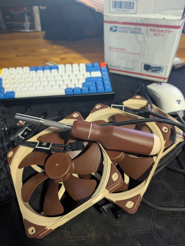

    Got some of the parks for the new PC in.
    PXL_20241230_193919322.jpg PXL_20241230_213605854.jpgPXL_20241230_220353083.jpg[​IMG]
