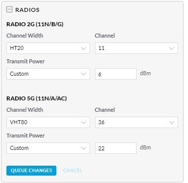

    Quick question.
    Did you turn up the db on the AP to max? Not sure how big your place is. I am using a single ac ap pro and with these settings and 5g I am getting really good results.

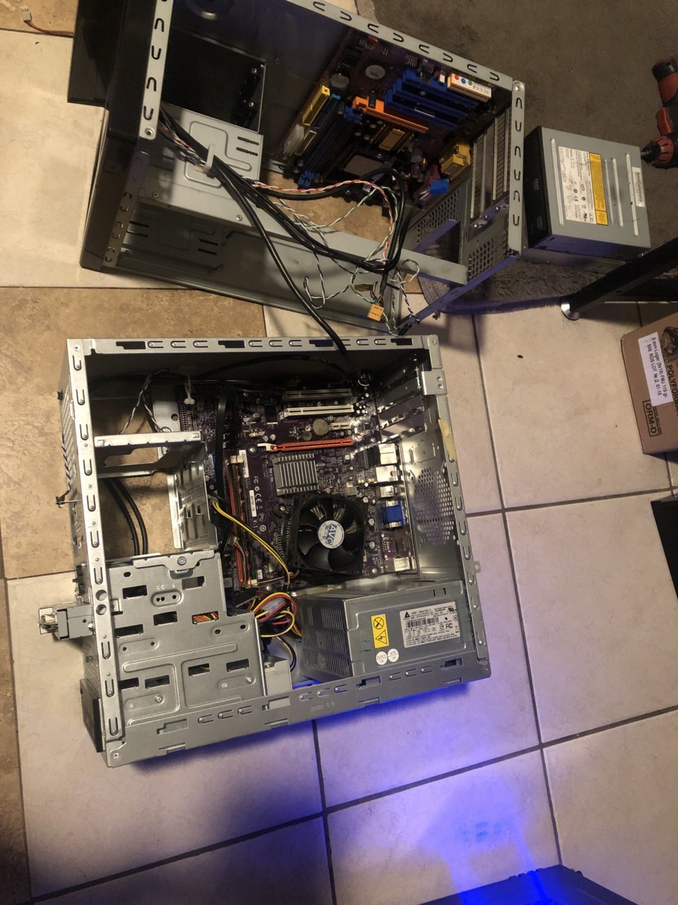

    Well let’s see how this turns out, I had 2 systems that were given to me, one an old XP system that was a former neighbors ex-husbands PC that he had set up to DVR the home security system, and one was an old windows 7 single core E-machines system that my parents used to pay their bills before my mom get her MacBook.
    The XP system had IDE drives in it so I’m gonna pull the MoBo from the Emachines system and use it in that chassis (I like the form factor better) and I think I have some spare HDD’s laying around so I can put FreeNAS on it to try it (I have my external HDD’s to keep redundant backups on) and see if a NAS/home server is something I will use.
    Unfortunately I won’t be able to get it connected right away, I’m trying to decide if I want to move the router and I have to run some Ethernet cables.

    Got the system together, it boots windows 7 64 bit so I’m working on wiping 2 drives to use for storage, one little snag though, I only have 3 GB ram and it’s DDR2, I have other ram laying around but it’s only DDR or DDR3 so I’m trying to decide if I want to try it on 3GB or go ahead and buy a 4GB stick to bump the system to 6GB.
    I also need to look into the hot swap SATA bays for the front of the case, I have one but no tray so I cannot currently hot swap HDD’s.

    I don't think I messed with the xmit power. Our place is something like 3700 sq feet, with only like 600 of that on the upper floor, so it's kind of spread out. I also wanted to get a decent signal out back and in the garage. I used an app to test signal strength across the house, and it was slightly worse than the Netgear X8 I was replacing. Workable, but not great. For me, spreading that signal out with a mesh system was best to get the coverage I wanted, it was just asking too much of a single AP.

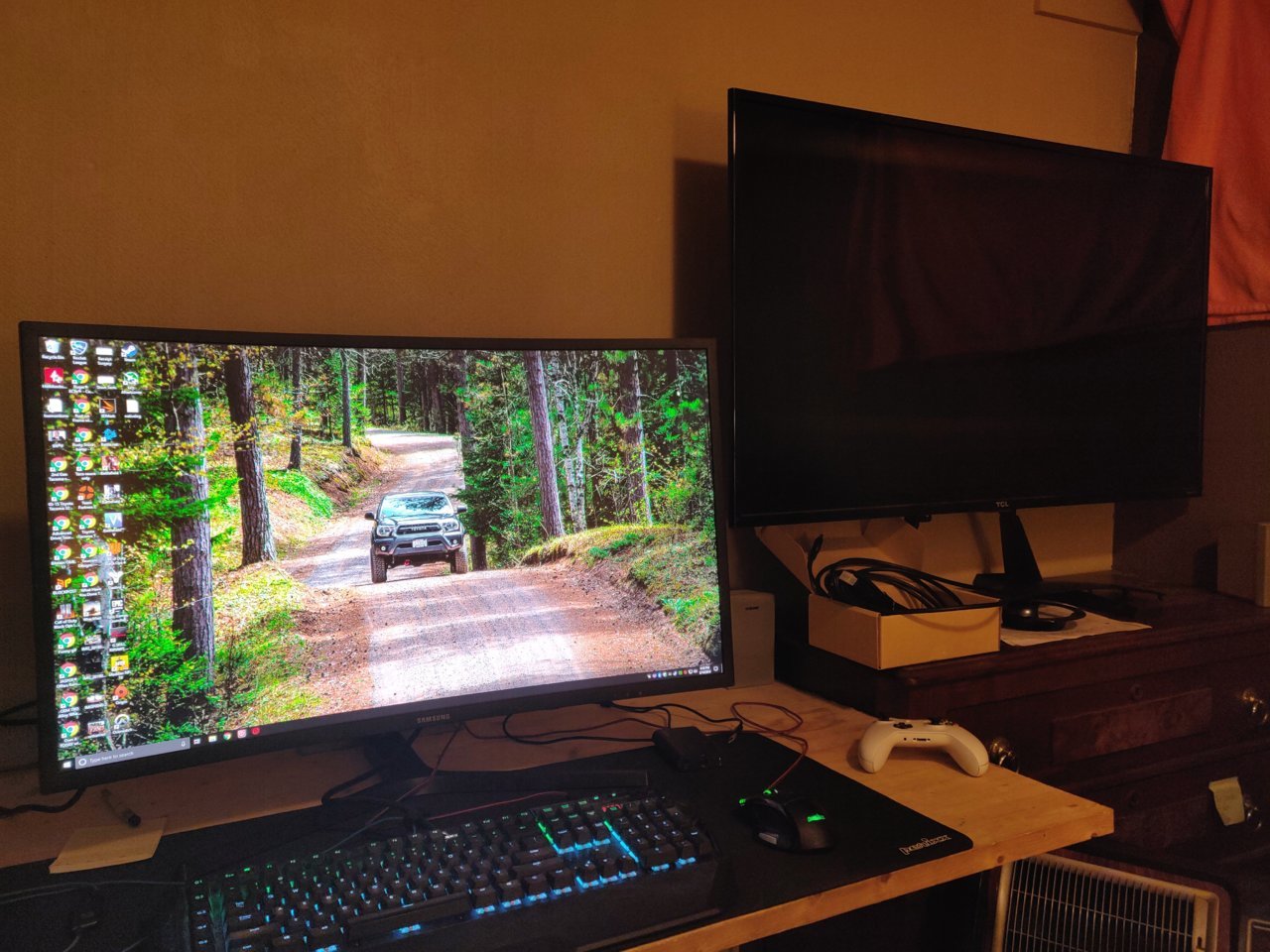

    New toy! Finally got a gaming monitor! Little messy, still setting up :)
