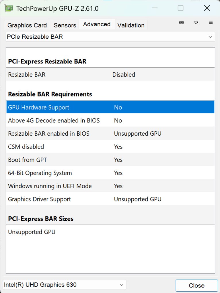

    Ive built the computer, got windows 11 installed, hopefully everything is updated.
    I tried the intel tool to see if that intel arc b580 card is compatible with my mobo and the resizable bar thing. The tool says "unable to check resizableBAR status of this system".
    I poked around the BIOS options looking for anything for compatibility mode, legacy mode, UEFI boot, but wasn't seeing anything. I downloaded a gpu-z tool.
    im guessing that card isn't going to work.
    anyone have any recommendations for something comparable? is it the 4060?

    Names differ between manufacturers when it comes to your BIOS settings.
    Also, that's your integrated GPU.
    Can you snap pics of the settings in your BIOS?
