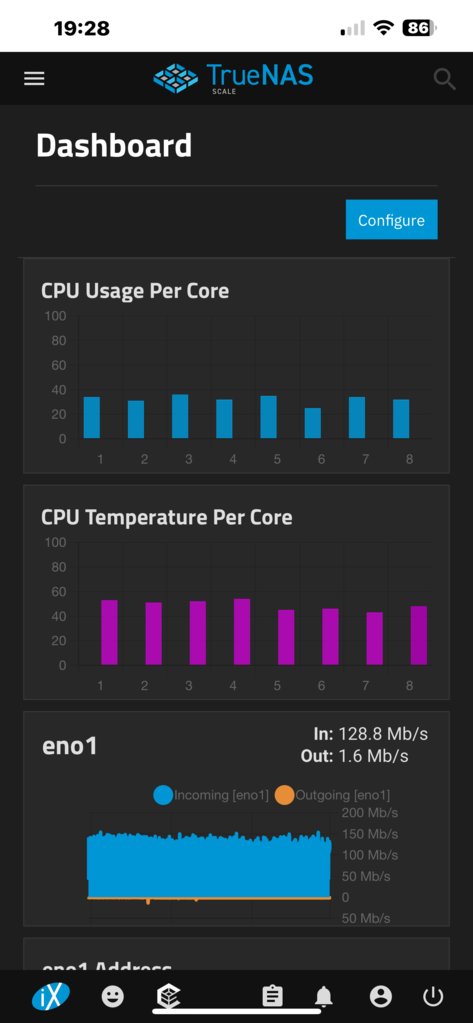

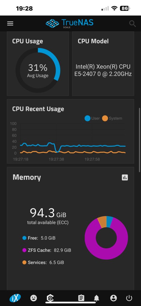

    Got my truenas server setup with the apps that I want (so far), definitely gonna have to add more storage for plex.
    Also, not sure if I’m bottle necked by storage speeds or what, my plex streaming isn’t very smooth or quality, I don’t seem to be CPU limited, the Ethernet NIC is gigabit and dual port (only one connection into the router) so I don’t think that’s limiting me with 14.5MB/s ingest and 300Mb/s on the fiber line.
    Maybe there’s a setting I can toggle and limit ingest throughput so I can access the drive at a decent bandwidth while it’s also being written to?
    I am considering adding a cache SSD.

    What are you encoding your video files to? Myself, I only encode to 1080p as I don’t see the need to have 4k files since I’m still running 1080p non-smart TVs.

    It should've only been 1080P for that TV show, I have some 4K movies but haven't tried to stream those yet.
    Edit: Tried on my PC and I don't have remote access available from the Plex Server, so I'm limited to the 2Mbps that plex provides, I'm trying to get port forwarding setup but it seems that NordVPN doesn't support that, so I guess I need to figure out what VPN service I can run on my asus router and allows port forwarding.
