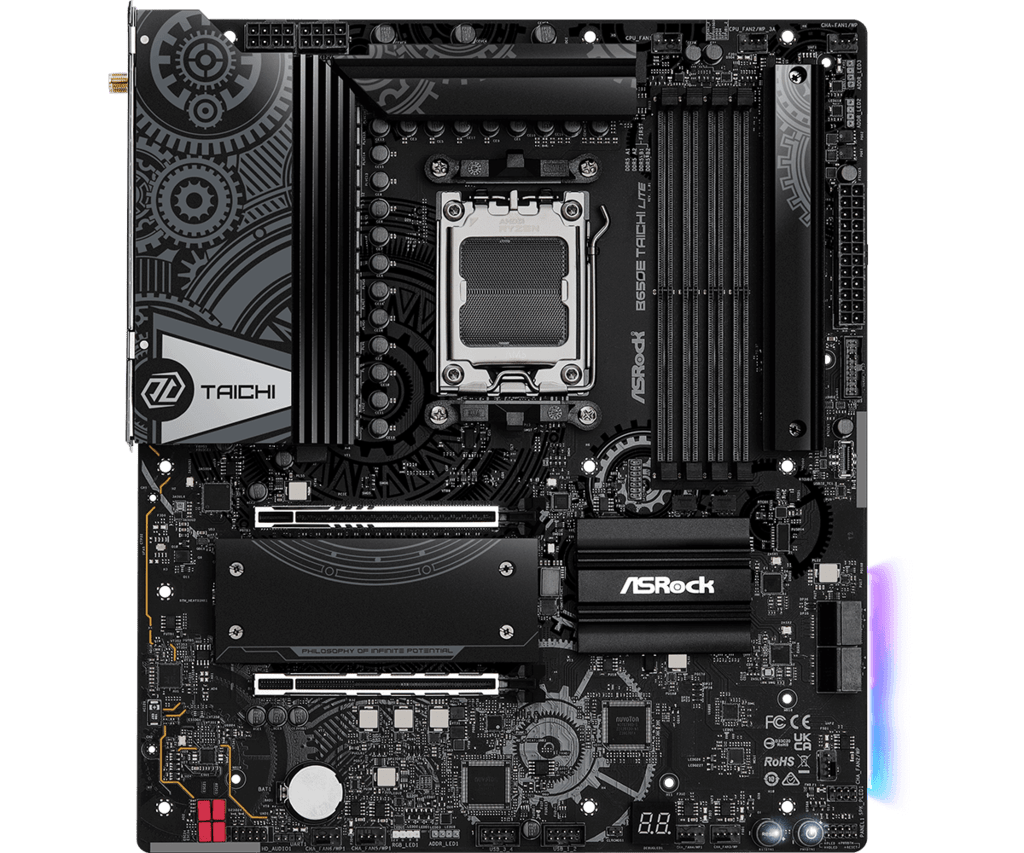

    So you have an ASRock brand card - Taichi Lite is the model
    Looking at the pic, you have an LED display for easy troubleshooting in the event of a no post at the bottom between the USB and front panel headers
    It's a 2 digit setup so I'm not sure where this AA21 appears but you can click here and go to page 58 - https://download.asrock.com/Manual/B650E Taichi Lite.pdf
    Just remember, something as simple as RAM not properly seated can cause issues. That or one failed stick.

    Yeah, that's what I found through Google. Try one stick, then move it to the other slot, then the other and do the same.

    That's really odd. Is it a brand new motherboard? If it's been used before, make sure to reset the CMOS. DDR5, like previous standards, should boot at it's base speed off the bat. It would be very rare to not boot at all unless EXPO is enabled. All ram should boot at base speeds on all AMD and Intel platforms. The QVL exists mainly to support EXPO timings, not base speeds.
    Did you make sure to leave the system to boot for at least 5 minutes? The older Bios versions of 600 boards can take up to 5 minutes to complete memory training, so you have to go make a sandwich or something and pray while it boots lol. AMD does this because it allows for fine tuning of the additional memory timings that aren't saved in the XMP/EXPO profiles.
    Last thought, and this one might seem crazy, did you make sure your graphics card is fully seated and plugged in? That can throw a GPU/PCI-E/RAM error, strangely. I've had it happen on a friends build he did himself. If all else fails, remove the GPU and boot with the integrated graphics to trouble shoot. Don't forget to plug the monitor into the motherboard for the testing and then switch back to the GPU when you reinstall it.

    Was this a new build? Or was the PC already running and suddenly started having issues?
    I haven't followed to the T exactly, just remember your last post was "I think I teased out" which I'm not sure what that means.
    If it's a new build, you would just shut everything off, pull one stick of ram out, and fire it back up. If the issue persists, you swap sticks.
    Can do this in 2 minutes without having to buy new ram.
